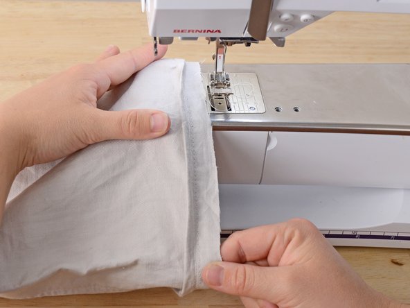

  5. Hemming Pants: crwdns2935265:05crwdnd2935265:01crwdnd2935265:02crwdne2935265:0 Hemming Pants: crwdns2935265:05crwdnd2935265:02crwdnd2935265:02crwdne2935265:0
    • Gently depress the foot pedal and begin sewing.
    • Be sure the needle penetrates the pant leg on only one side. It may be easier to position the pant leg around the arm of the sewing machine with the table removed. If you sew through both layers, you will sew the pant leg shut!
    • Pause when you reach a pin, and remove it before continuing.
    • Do not attempt to sew over any pins. Hitting a pin can bend or break the sewing machine needle.
  6. Hemming Pants: crwdns2935265:06crwdnd2935265:01crwdnd2935265:02crwdne2935265:0 Hemming Pants: crwdns2935265:06crwdnd2935265:02crwdnd2935265:02crwdne2935265:0
    • Continue sewing all the way around the cuff, until you reach the first few stitches.
    • Sew over the first few stitches to prevent the stitches from unraveling.

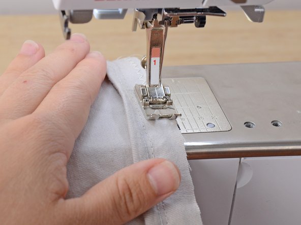

  9. Hemming Pants: crwdns2935265:09crwdnd2935265:01crwdnd2935265:03crwdne2935265:0 Hemming Pants: crwdns2935265:09crwdnd2935265:02crwdnd2935265:03crwdne2935265:0 Hemming Pants: crwdns2935265:09crwdnd2935265:03crwdnd2935265:03crwdne2935265:0
    • Set your sewing machine to a zigzag stitch.
    • Insert the freshly cut edge of the hem into the sewing machine.
    • Be sure to only insert one layer of fabric—the hem—or you will sew through the outer, visible layers of the pants.
  10. Hemming Pants: crwdns2935265:010crwdnd2935265:01crwdnd2935265:02crwdne2935265:0 Hemming Pants: crwdns2935265:010crwdnd2935265:02crwdnd2935265:02crwdne2935265:0
    • Sew around the hem, as close to the edge as possible.
    • Zigzagging the edge prevents the edge from unraveling.
