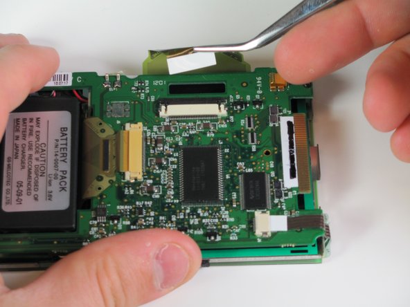

    • Gently use your finger or tweezers to push the brown lock away from the side of the circuit board that is holding the ribbon cable.
    • Remove the ribbon cable with tweezers.
  9. Handspring Visor Edge Battery Replacement: crwdns2935265:09crwdnd2935265:01crwdnd2935265:01crwdne2935265:0
    • Using the tweezers, pull back the ribbon cable on the top of the device.
    • Pull at the white part of the ribbon to avoid tearing.
  10. Handspring Visor Edge Battery Replacement: crwdns2935265:010crwdnd2935265:01crwdnd2935265:01crwdne2935265:0
    • Using the same technique as with the other ribbons, locate and disconnect the ribbon cable above the battery pack.
  11. Handspring Visor Edge Battery Replacement: crwdns2935265:011crwdnd2935265:01crwdnd2935265:01crwdne2935265:0
    • All the ribbon cables should be disconnected from the mother board.

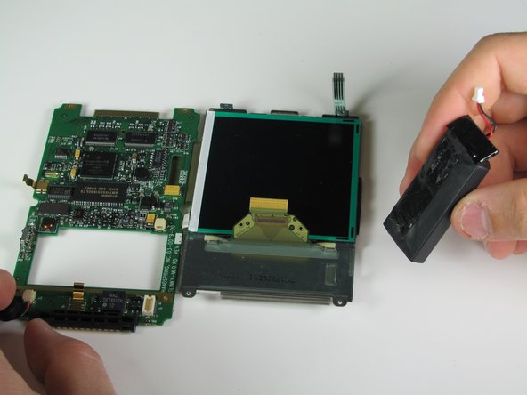

    • Carefully separate the circuit board and the screen. (Be careful of soldered wires when separating)
    • Be careful not to break the soldered wires that connects the circuit board to the battery pack.
    • Disconnect the wire that connects the battery pack to the motherboard using tweezers.
  13. Handspring Visor Edge Battery Replacement: crwdns2935265:013crwdnd2935265:01crwdnd2935265:02crwdne2935265:0 Handspring Visor Edge Battery Replacement: crwdns2935265:013crwdnd2935265:02crwdnd2935265:02crwdne2935265:0
    • Wedge the spudger under the battery to pry it apart from the adhesive.
