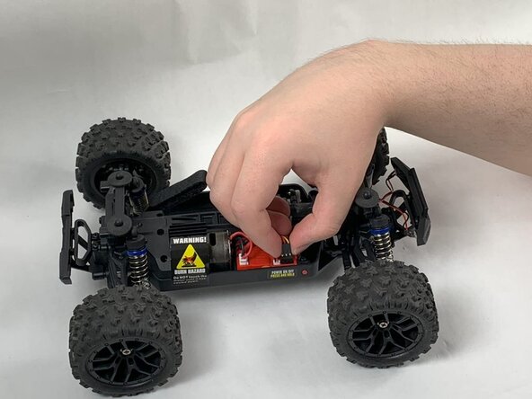

    • Remove the 4 clips holding down the hard plastic shell of the RC car. Do this by pinching them with your thumb and index finger and pulling away.

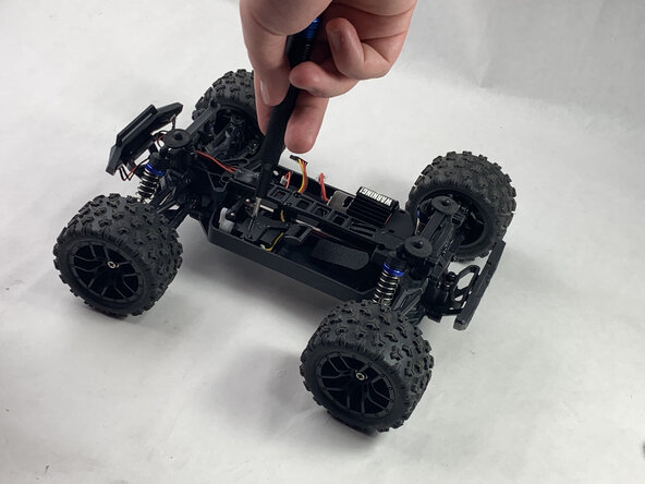

  2. Haiboxing 18859 Servo Replacement: crwdns2935265:02crwdnd2935265:01crwdnd2935265:01crwdne2935265:0
    • Lift the hard plastic shell off of the RC car.

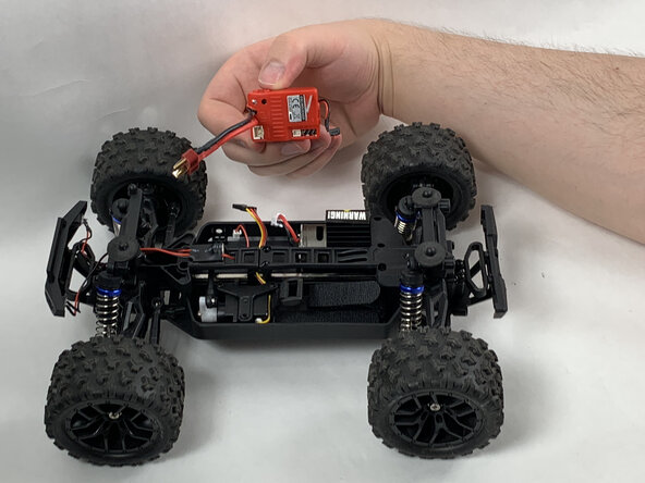

  3. Haiboxing 18859 Servo Replacement: crwdns2935265:03crwdnd2935265:01crwdnd2935265:03crwdne2935265:0 Haiboxing 18859 Servo Replacement: crwdns2935265:03crwdnd2935265:02crwdnd2935265:03crwdne2935265:0 Haiboxing 18859 Servo Replacement: crwdns2935265:03crwdnd2935265:03crwdnd2935265:03crwdne2935265:0
    • Disconnect the Lego-style battery connector by gripping either side and pulling them away from each other, slowly and consistently.

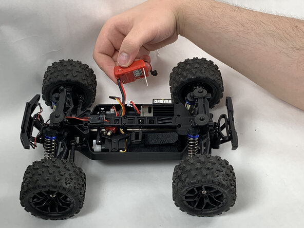

  4. Haiboxing 18859 Servo Replacement: crwdns2935265:04crwdnd2935265:01crwdnd2935265:03crwdne2935265:0 Haiboxing 18859 Servo Replacement: crwdns2935265:04crwdnd2935265:02crwdnd2935265:03crwdne2935265:0 Haiboxing 18859 Servo Replacement: crwdns2935265:04crwdnd2935265:03crwdnd2935265:03crwdne2935265:0
    • Unfasten the Velcro strap that secures the battery.

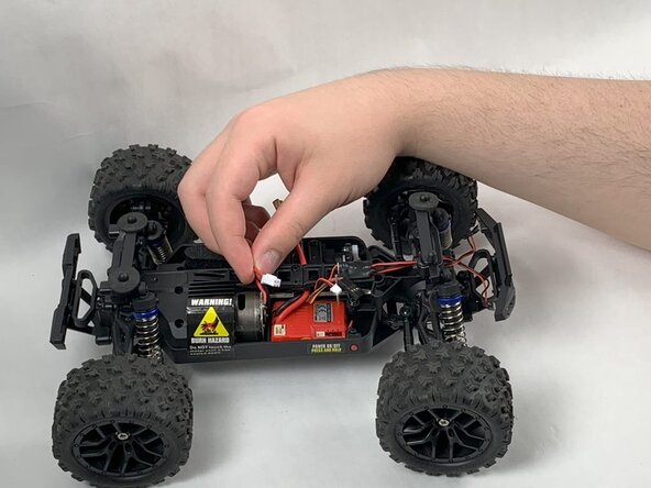

  6. Haiboxing 18859 Servo Replacement, Receiver: crwdns2935265:06crwdnd2935265:01crwdnd2935265:03crwdne2935265:0 Haiboxing 18859 Servo Replacement, Receiver: crwdns2935265:06crwdnd2935265:02crwdnd2935265:03crwdne2935265:0 Haiboxing 18859 Servo Replacement, Receiver: crwdns2935265:06crwdnd2935265:03crwdnd2935265:03crwdne2935265:0
    • Disonnect all connectors attached to the red, plastic receiver.

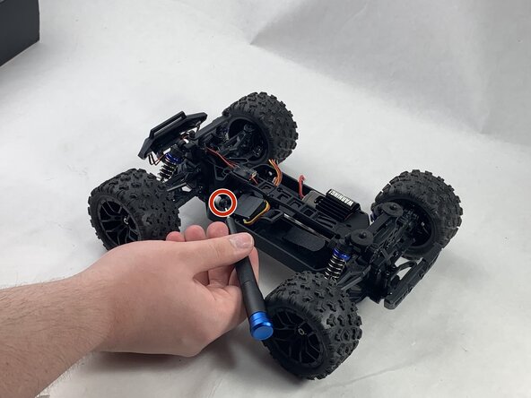

  7. Haiboxing 18859 Servo Replacement: crwdns2935265:07crwdnd2935265:01crwdnd2935265:01crwdne2935265:0
    • Remove the 8 mm Phillips #0 screw holding the front corner of the receiver down.
    • Remove the front corner piece.
