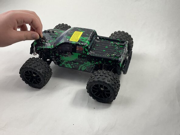

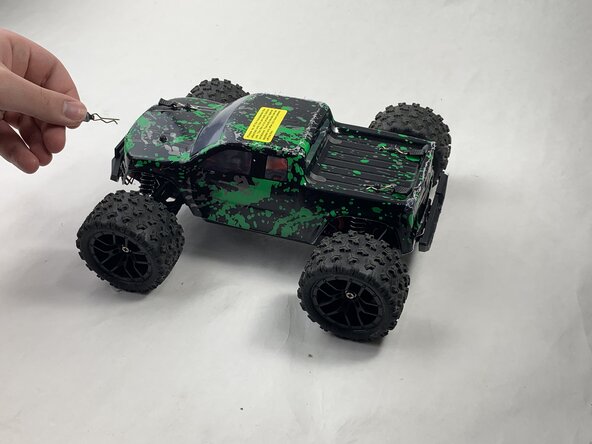

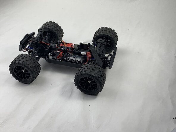

    • Remove the 4 clips holding down the hard plastic shell of the RC car. Do this by pinching them with your thumb and index finger and pulling away.
  2. Haiboxing 18859 Motor Replacement: crwdns2935265:02crwdnd2935265:01crwdnd2935265:01crwdne2935265:0
    • Lift the hard plastic shell off of the RC car.
  3. Haiboxing 18859 Motor Replacement: crwdns2935265:03crwdnd2935265:01crwdnd2935265:03crwdne2935265:0 Haiboxing 18859 Motor Replacement: crwdns2935265:03crwdnd2935265:02crwdnd2935265:03crwdne2935265:0 Haiboxing 18859 Motor Replacement: crwdns2935265:03crwdnd2935265:03crwdnd2935265:03crwdne2935265:0

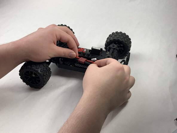

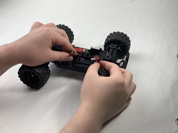

    • Disconnect the Lego-style battery connector by gripping either side and pulling them away from each other, slowly and consistently.

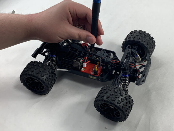

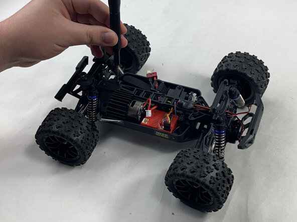

  4. Haiboxing 18859 Motor Replacement: crwdns2935265:04crwdnd2935265:01crwdnd2935265:03crwdne2935265:0 Haiboxing 18859 Motor Replacement: crwdns2935265:04crwdnd2935265:02crwdnd2935265:03crwdne2935265:0 Haiboxing 18859 Motor Replacement: crwdns2935265:04crwdnd2935265:03crwdnd2935265:03crwdne2935265:0

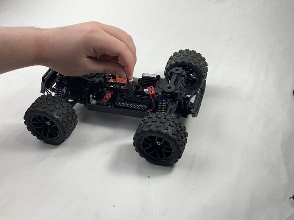

    • Unfasten the Velcro strap that secures the battery.
  5. Haiboxing 18859 Motor Replacement: crwdns2935265:05crwdnd2935265:01crwdnd2935265:02crwdne2935265:0 Haiboxing 18859 Motor Replacement: crwdns2935265:05crwdnd2935265:02crwdnd2935265:02crwdne2935265:0
    • Remove the battery.
  6. Haiboxing 18859 Motor Replacement, Motor: crwdns2935265:06crwdnd2935265:01crwdnd2935265:01crwdne2935265:0

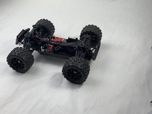

    • Unplug the motor from the receiver.
  7. Haiboxing 18859 Motor Replacement: crwdns2935265:07crwdnd2935265:01crwdnd2935265:01crwdne2935265:0
    • Peel back the warning tape covering the motor.
  8. Haiboxing 18859 Motor Replacement: crwdns2935265:08crwdnd2935265:01crwdnd2935265:03crwdne2935265:0 Haiboxing 18859 Motor Replacement: crwdns2935265:08crwdnd2935265:02crwdnd2935265:03crwdne2935265:0 Haiboxing 18859 Motor Replacement: crwdns2935265:08crwdnd2935265:03crwdnd2935265:03crwdne2935265:0

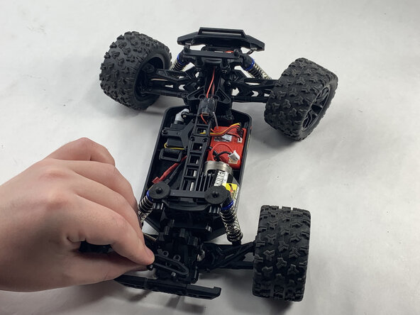

    • Unscrew the 10 mm Phillips #0 screws holding down the motor. This includes the shaft attached down the middle.
    • Place the mounting screws where you won't lose them, such as in a plastic bag or container.

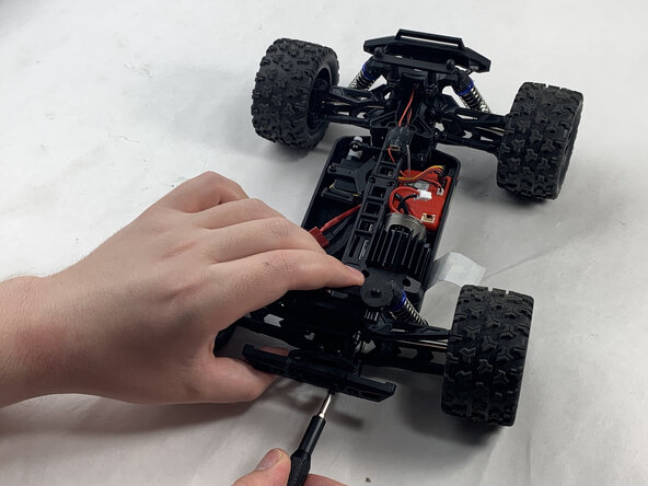

  9. Haiboxing 18859 Motor Replacement: crwdns2935265:09crwdnd2935265:01crwdnd2935265:03crwdne2935265:0 Haiboxing 18859 Motor Replacement: crwdns2935265:09crwdnd2935265:02crwdnd2935265:03crwdne2935265:0 Haiboxing 18859 Motor Replacement: crwdns2935265:09crwdnd2935265:03crwdnd2935265:03crwdne2935265:0
    • Unscrew the 16 mm Phillips #1 screws at the rear of the Haiboxing.

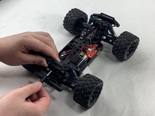

  10. Haiboxing 18859 Motor Replacement: crwdns2935265:010crwdnd2935265:01crwdnd2935265:02crwdne2935265:0 Haiboxing 18859 Motor Replacement: crwdns2935265:010crwdnd2935265:02crwdnd2935265:02crwdne2935265:0
    • Remove the upwards facing rear-most 8 mm Phillips #1 screws.
    • Remove the trapezoid-shaped part.
  11. Haiboxing 18859 Motor Replacement: crwdns2935265:011crwdnd2935265:01crwdnd2935265:01crwdne2935265:0

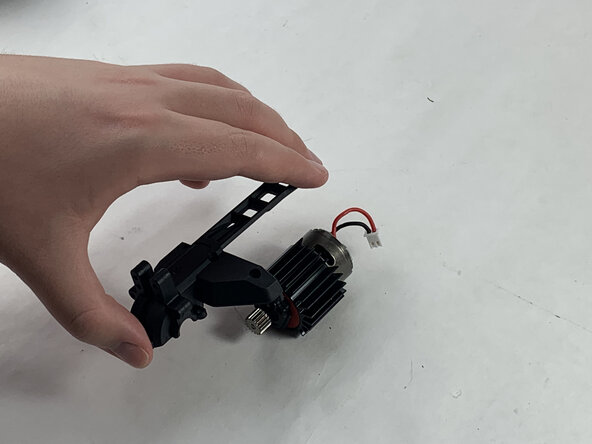

    • Lift out the motor and the shaft it is attached to.

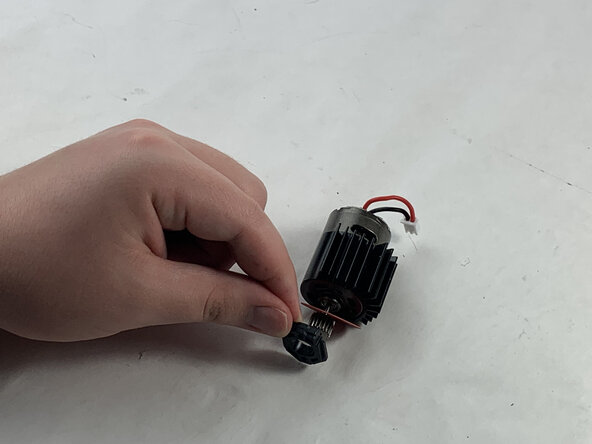

  12. Haiboxing 18859 Motor Replacement: crwdns2935265:012crwdnd2935265:01crwdnd2935265:01crwdne2935265:0
    • Remove the 6 mm Phillips #0 screw holding the motor to the black, plastic shaft.
  13. Haiboxing 18859 Motor Replacement: crwdns2935265:013crwdnd2935265:01crwdnd2935265:02crwdne2935265:0 Haiboxing 18859 Motor Replacement: crwdns2935265:013crwdnd2935265:02crwdnd2935265:02crwdne2935265:0
    • Flip over.
    • Detach the shaft from motor.
  14. Haiboxing 18859 Motor Replacement: crwdns2935265:014crwdnd2935265:01crwdnd2935265:03crwdne2935265:0 Haiboxing 18859 Motor Replacement: crwdns2935265:014crwdnd2935265:02crwdnd2935265:03crwdne2935265:0 Haiboxing 18859 Motor Replacement: crwdns2935265:014crwdnd2935265:03crwdnd2935265:03crwdne2935265:0

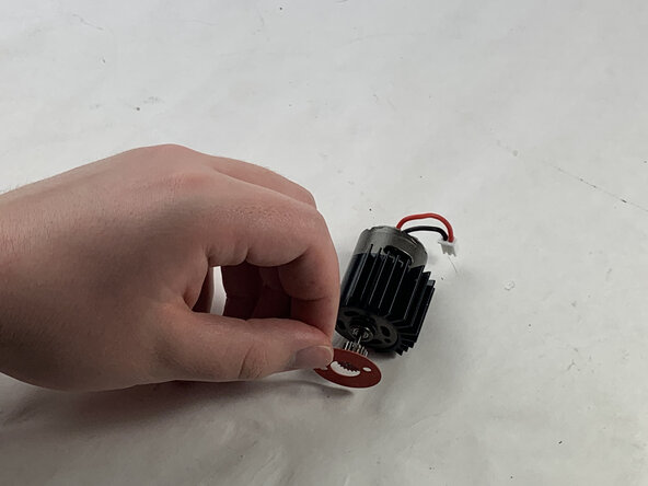

    • Remove the remaining 6 mm Phillips #0 screw holding black, plastic washer in place.
    • Remove the black, plastic washer.
    • Remove the red, paper washer.
