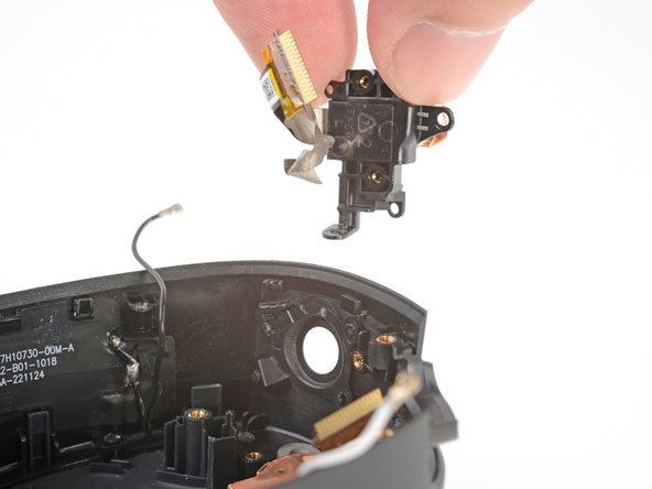

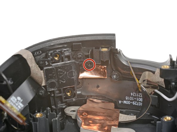

HTC Vive XR Elite Side Tracking Cameras Replacement
  1. HTC Vive XR Elite Side Tracking Cameras Replacement, Prepare your Vive XR Elite for disassembly: crwdns2935265:01crwdnd2935265:01crwdnd2935265:01crwdne2935265:0

  99. HTC Vive XR Elite Side Tracking Cameras Replacement, Unfasten the side tracking camera: crwdns2935265:099crwdnd2935265:01crwdnd2935265:02crwdne2935265:0 HTC Vive XR Elite Side Tracking Cameras Replacement, Unfasten the side tracking camera: crwdns2935265:099crwdnd2935265:02crwdnd2935265:02crwdne2935265:0
    • The next two steps will show you how to remove one side tracking camera, but the procedure is the same for both.
    • Use a T5 Torx screwdriver to remove the two 3.5 mm‑long screws securing the side tracking camera.
  100. HTC Vive XR Elite Side Tracking Cameras Replacement, Remove the side tracking camera: crwdns2935265:0100crwdnd2935265:01crwdnd2935265:02crwdne2935265:0 HTC Vive XR Elite Side Tracking Cameras Replacement, Remove the side tracking camera: crwdns2935265:0100crwdnd2935265:02crwdnd2935265:02crwdne2935265:0
    • Lift the side tracking camera out of the frame and remove it.
