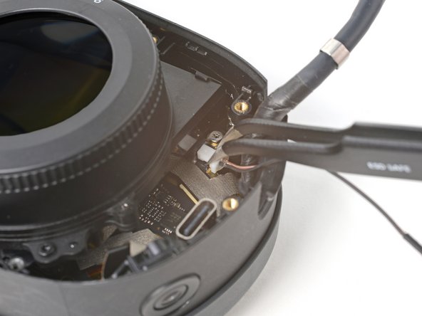

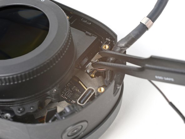

  34. HTC Vive XR Elite Right Speaker Replacement, Disconnect the right speaker: crwdns2935265:034crwdnd2935265:01crwdnd2935265:03crwdne2935265:0 HTC Vive XR Elite Right Speaker Replacement, Disconnect the right speaker: crwdns2935265:034crwdnd2935265:02crwdnd2935265:03crwdne2935265:0 HTC Vive XR Elite Right Speaker Replacement, Disconnect the right speaker: crwdns2935265:034crwdnd2935265:03crwdnd2935265:03crwdne2935265:0
    • Use tweezers to pull the right speaker connector out of its socket.
    • If you're having trouble, try rocking the connector side-to-side to help loosen the connector.
  35. HTC Vive XR Elite Right Speaker Replacement, Remove the right speaker: crwdns2935265:035crwdnd2935265:01crwdnd2935265:01crwdne2935265:0
    • Remove the right speaker.
