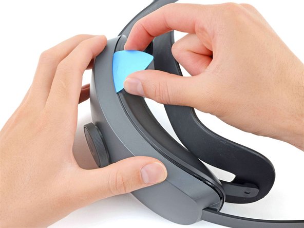

  2. HTC Vive XR Elite Rear Padding Replacement, Insert an opening pick: crwdns2935265:02crwdnd2935265:01crwdnd2935265:02crwdne2935265:0 HTC Vive XR Elite Rear Padding Replacement, Insert an opening pick: crwdns2935265:02crwdnd2935265:02crwdnd2935265:02crwdne2935265:0

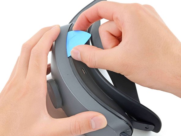

    • Insert a long edge of an opening pick in the gap between the two halves of the battery cradle, near the USB-C cable.

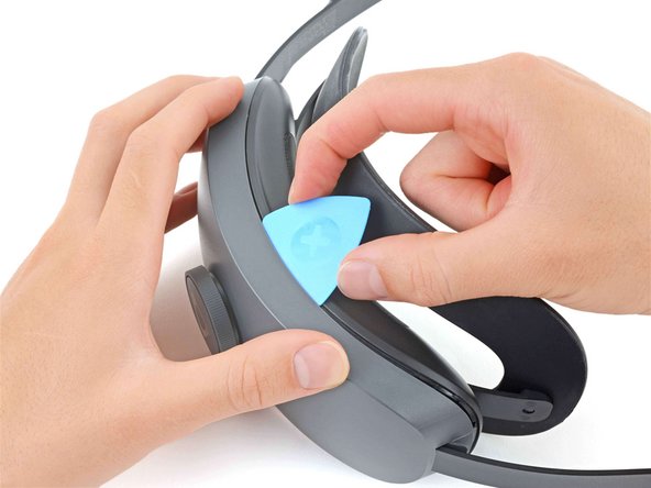

  3. HTC Vive XR Elite Rear Padding Replacement, Release the top clips: crwdns2935265:03crwdnd2935265:01crwdnd2935265:03crwdne2935265:0 HTC Vive XR Elite Rear Padding Replacement, Release the top clips: crwdns2935265:03crwdnd2935265:02crwdnd2935265:03crwdne2935265:0 HTC Vive XR Elite Rear Padding Replacement, Release the top clips: crwdns2935265:03crwdnd2935265:03crwdnd2935265:03crwdne2935265:0
    • Slide the opening pick along the top edge of battery cradle to release its plastic clips.

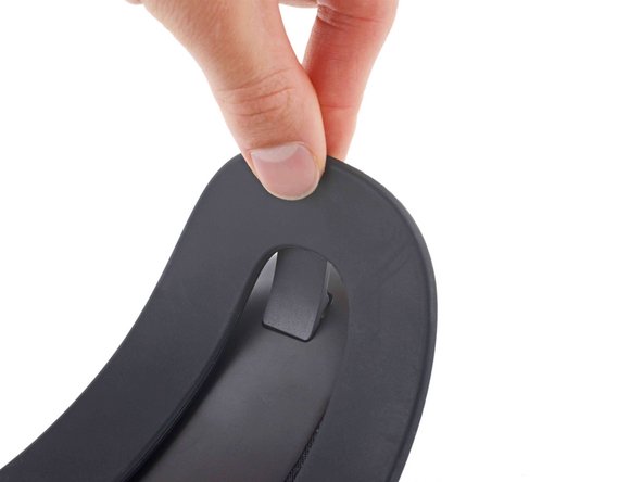

  4. HTC Vive XR Elite Rear Padding Replacement: crwdns2935265:04crwdnd2935265:01crwdnd2935265:02crwdne2935265:0 HTC Vive XR Elite Rear Padding Replacement: crwdns2935265:04crwdnd2935265:02crwdnd2935265:02crwdne2935265:0

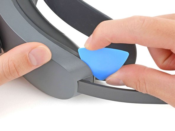

    • Flip the battery cradle over.
    • Insert the long edge of an opening pick in the gap between the two halves of the battery cradle.

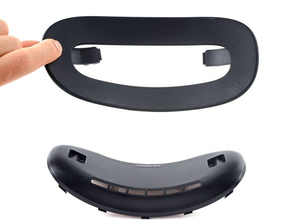

  5. HTC Vive XR Elite Rear Padding Replacement, Release the bottom clips: crwdns2935265:05crwdnd2935265:01crwdnd2935265:03crwdne2935265:0 HTC Vive XR Elite Rear Padding Replacement, Release the bottom clips: crwdns2935265:05crwdnd2935265:02crwdnd2935265:03crwdne2935265:0 HTC Vive XR Elite Rear Padding Replacement, Release the bottom clips: crwdns2935265:05crwdnd2935265:03crwdnd2935265:03crwdne2935265:0
    • Slide the opening pick along the bottom edge of battery cradle to release its plastic clips.

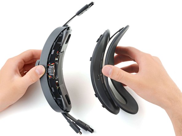

  6. HTC Vive XR Elite Rear Padding Replacement, Separate the battery cradle halves: crwdns2935265:06crwdnd2935265:01crwdnd2935265:02crwdne2935265:0 HTC Vive XR Elite Rear Padding Replacement, Separate the battery cradle halves: crwdns2935265:06crwdnd2935265:02crwdnd2935265:02crwdne2935265:0
    • Pull apart the two halves of the battery cradle to completely separate them.

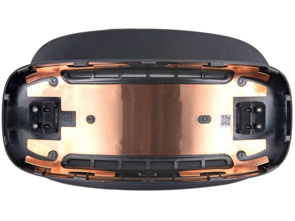

    • Use a T5 Torx screwdriver to remove the four 4.9 mm-long screws securing the rear padding.

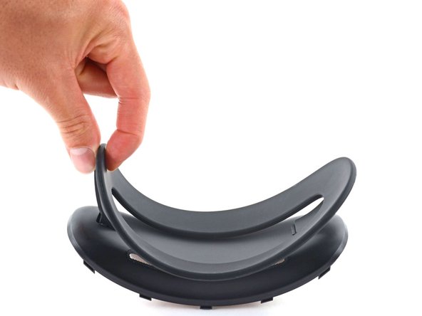

    • Pivot one of the rear padding clips toward the center of the frame.

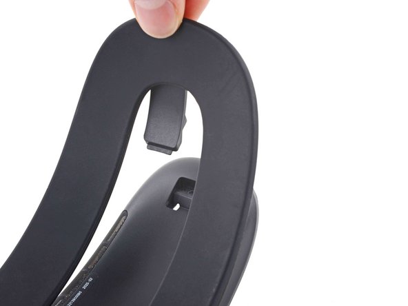

    • Lift the rear padding up to unclip it.
  9. HTC Vive XR Elite Rear Padding Replacement, Remove the rear padding: crwdns2935265:09crwdnd2935265:01crwdnd2935265:03crwdne2935265:0 HTC Vive XR Elite Rear Padding Replacement, Remove the rear padding: crwdns2935265:09crwdnd2935265:02crwdnd2935265:03crwdne2935265:0 HTC Vive XR Elite Rear Padding Replacement, Remove the rear padding: crwdns2935265:09crwdnd2935265:03crwdnd2935265:03crwdne2935265:0
    • The rear padding is not symmetrical. Note its orientation before continuing.
    • Unclip the remaining rear padding clip.
    • Remove the rear padding.
