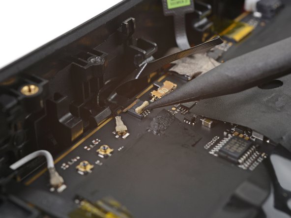

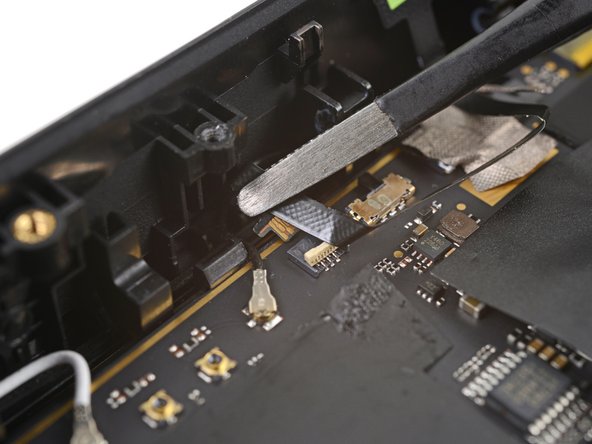

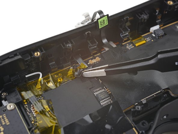

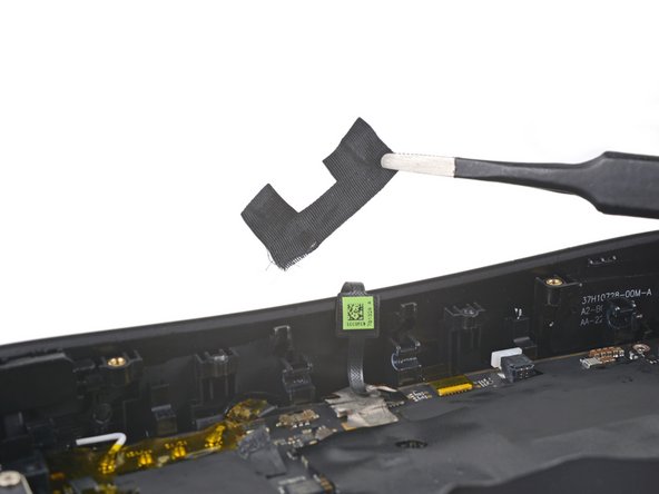

  39. HTC Vive XR Elite Proximity Sensor Replacement, Unfasten the lens assembly cables: crwdns2935265:039crwdnd2935265:01crwdnd2935265:01crwdne2935265:0
    • Use a T5 Torx screwdriver to remove the four 3.4 mm‑long screws securing the lens assembly cables.
  40. HTC Vive XR Elite Proximity Sensor Replacement, Disconnect the lens assembly cables: crwdns2935265:040crwdnd2935265:01crwdnd2935265:03crwdne2935265:0 HTC Vive XR Elite Proximity Sensor Replacement, Disconnect the lens assembly cables: crwdns2935265:040crwdnd2935265:02crwdnd2935265:03crwdne2935265:0 HTC Vive XR Elite Proximity Sensor Replacement, Disconnect the lens assembly cables: crwdns2935265:040crwdnd2935265:03crwdnd2935265:03crwdne2935265:0
    • Use the flat end of a spudger to pry up and disconnect the lens assembly cable connector.
    • Repeat this procedure for the other connector.

  47. HTC Vive XR Elite Proximity Sensor Replacement: crwdns2935265:047crwdnd2935265:01crwdnd2935265:01crwdne2935265:0
    • Peel off the yellow tape covering the proximity sensor connector.
  48. HTC Vive XR Elite Proximity Sensor Replacement, Disconnect the proximity sensor: crwdns2935265:048crwdnd2935265:01crwdnd2935265:02crwdne2935265:0 HTC Vive XR Elite Proximity Sensor Replacement, Disconnect the proximity sensor: crwdns2935265:048crwdnd2935265:02crwdnd2935265:02crwdne2935265:0
    • Use the point of a spudger to lift up the locking flap on the proximity sensor ZIF connector.
  49. HTC Vive XR Elite Proximity Sensor Replacement: crwdns2935265:049crwdnd2935265:01crwdnd2935265:02crwdne2935265:0 HTC Vive XR Elite Proximity Sensor Replacement: crwdns2935265:049crwdnd2935265:02crwdnd2935265:02crwdne2935265:0
    • Use tweezers to pull the proximity sensor cable out of its slot in the motherboard.
