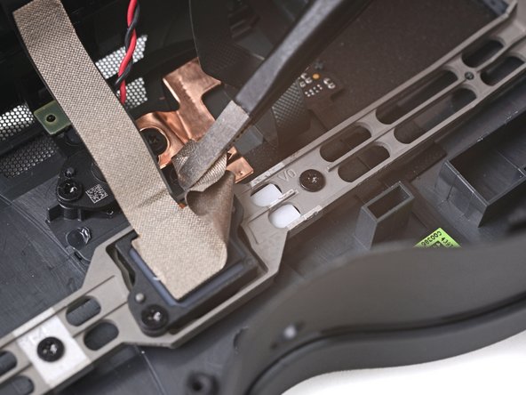

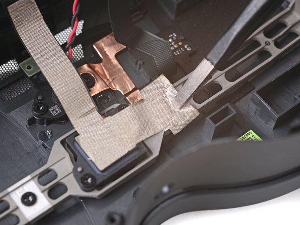

  99. HTC Vive XR Elite Pass-Through Camera Replacement, Peel the tape: crwdns2935265:099crwdnd2935265:01crwdnd2935265:03crwdne2935265:0 HTC Vive XR Elite Pass-Through Camera Replacement, Peel the tape: crwdns2935265:099crwdnd2935265:02crwdnd2935265:03crwdne2935265:0 HTC Vive XR Elite Pass-Through Camera Replacement, Peel the tape: crwdns2935265:099crwdnd2935265:03crwdnd2935265:03crwdne2935265:0
    • Peel back the grey conductive tape covering the pass-through camera screw.

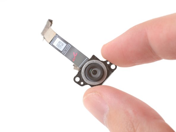

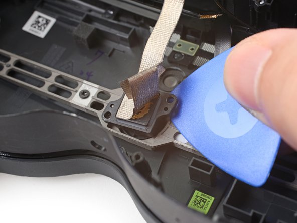

  101. HTC Vive XR Elite Pass-Through Camera Replacement, Remove the pass-through camera: crwdns2935265:0101crwdnd2935265:01crwdnd2935265:03crwdne2935265:0 HTC Vive XR Elite Pass-Through Camera Replacement, Remove the pass-through camera: crwdns2935265:0101crwdnd2935265:02crwdnd2935265:03crwdne2935265:0 HTC Vive XR Elite Pass-Through Camera Replacement, Remove the pass-through camera: crwdns2935265:0101crwdnd2935265:03crwdnd2935265:03crwdne2935265:0
    • The pass-through camera is lightly adhered to the camera array.
    • Insert an opening pick under the corner of the pass-through camera, near the screw hole.
    • Slide the opening pick forward and pry upward to separate the adhesive.
    • Lift the pass-through camera off its two alignment pegs and remove it.
