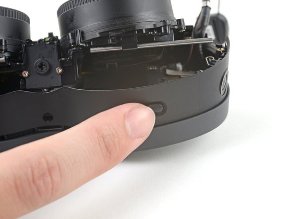

  3. HTC Vive XR Elite Motion Sensor Replacement, Disconnect the battery cradle: crwdns2935265:03crwdnd2935265:01crwdnd2935265:03crwdne2935265:0 HTC Vive XR Elite Motion Sensor Replacement, Disconnect the battery cradle: crwdns2935265:03crwdnd2935265:02crwdnd2935265:03crwdne2935265:0 HTC Vive XR Elite Motion Sensor Replacement, Disconnect the battery cradle: crwdns2935265:03crwdnd2935265:03crwdnd2935265:03crwdne2935265:0
    • Press the release button on the right battery cradle temple slot.
    • Pull the battery cradle away from the right temple slot to disconnect it.

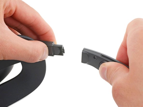

  5. HTC Vive XR Elite Motion Sensor Replacement, Separate the headset and battery cradle: crwdns2935265:05crwdnd2935265:01crwdnd2935265:01crwdne2935265:0
    • Separate the headset and battery cradle.

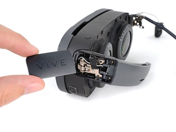

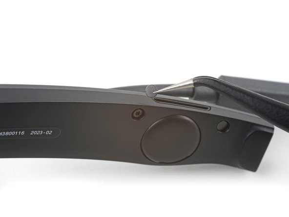

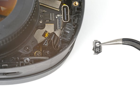

  7. HTC Vive XR Elite Motion Sensor Replacement, Remove the screw covers: crwdns2935265:07crwdnd2935265:01crwdnd2935265:02crwdne2935265:0 HTC Vive XR Elite Motion Sensor Replacement, Remove the screw covers: crwdns2935265:07crwdnd2935265:02crwdnd2935265:02crwdne2935265:0
    • Use tweezers to remove the six screw covers from the right temple.
  8. HTC Vive XR Elite Motion Sensor Replacement, Unfasten the right temple: crwdns2935265:08crwdnd2935265:01crwdnd2935265:02crwdne2935265:0 HTC Vive XR Elite Motion Sensor Replacement, Unfasten the right temple: crwdns2935265:08crwdnd2935265:02crwdnd2935265:02crwdne2935265:0
    • Use a T5 Torx screwdriver to remove the six 4.9 mm‑long screws securing the two right temple halves.
    • Use a T5 Torx screwdriver to remove the two 3.5 mm‑long screws securing the right hinge cover.

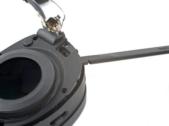

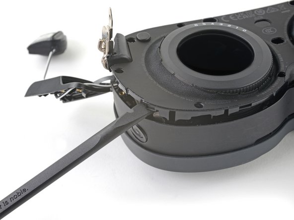

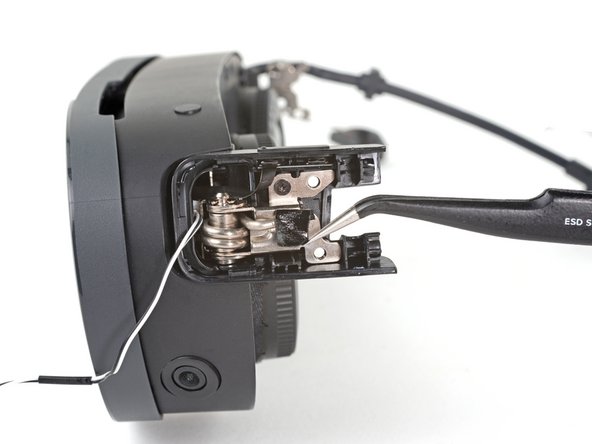

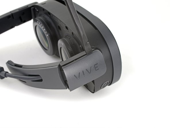

  9. HTC Vive XR Elite Motion Sensor Replacement, Remove the outer hinge cover: crwdns2935265:09crwdnd2935265:01crwdnd2935265:03crwdne2935265:0 HTC Vive XR Elite Motion Sensor Replacement, Remove the outer hinge cover: crwdns2935265:09crwdnd2935265:02crwdnd2935265:03crwdne2935265:0 HTC Vive XR Elite Motion Sensor Replacement, Remove the outer hinge cover: crwdns2935265:09crwdnd2935265:03crwdnd2935265:03crwdne2935265:0
    • Insert the flat end of a spudger in the gap between the right outer and inner hinge covers.
    • Slide the spudger along the gap to separate the clips securing the outer hinge cover.
    • Remove the outer hinge cover.

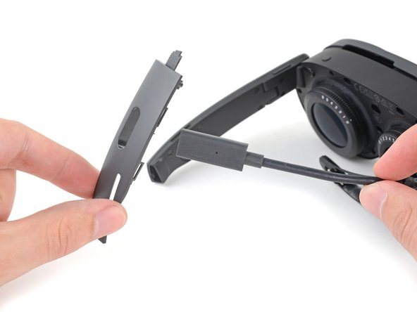

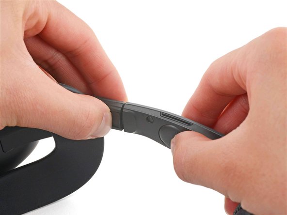

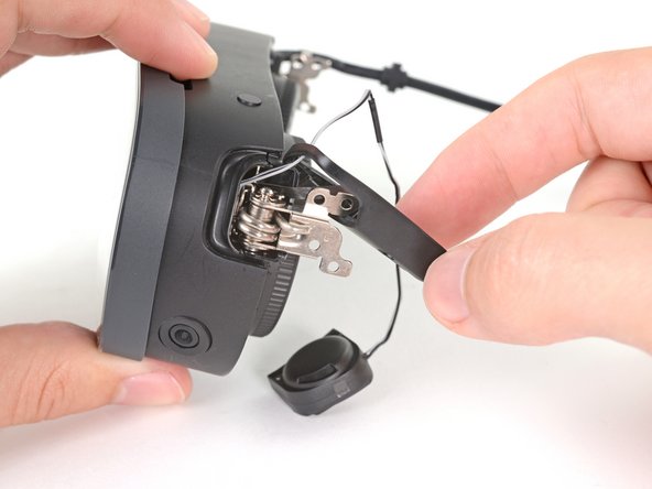

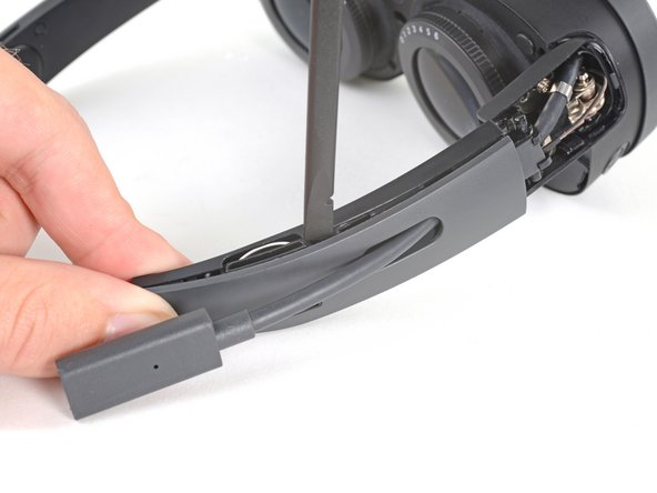

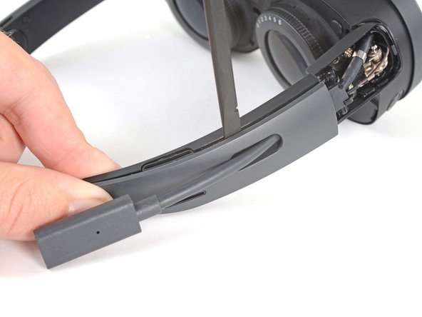

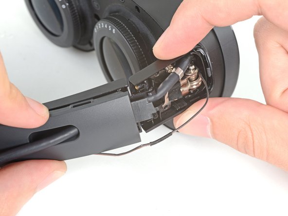

  10. HTC Vive XR Elite Motion Sensor Replacement, Remove the outer temple: crwdns2935265:010crwdnd2935265:01crwdnd2935265:03crwdne2935265:0 HTC Vive XR Elite Motion Sensor Replacement, Remove the outer temple: crwdns2935265:010crwdnd2935265:02crwdnd2935265:03crwdne2935265:0 HTC Vive XR Elite Motion Sensor Replacement, Remove the outer temple: crwdns2935265:010crwdnd2935265:03crwdnd2935265:03crwdne2935265:0
    • Insert the flat end of a spudger in the gap between the outer and inner temple.
    • Slide the spudger along the gap to separate the clips securing the outer temple.
  11. HTC Vive XR Elite Motion Sensor Replacement: crwdns2935265:011crwdnd2935265:01crwdnd2935265:03crwdne2935265:0 HTC Vive XR Elite Motion Sensor Replacement: crwdns2935265:011crwdnd2935265:02crwdnd2935265:03crwdne2935265:0 HTC Vive XR Elite Motion Sensor Replacement: crwdns2935265:011crwdnd2935265:03crwdnd2935265:03crwdne2935265:0
    • Slide the top of the outer temple out of its slot in the hinge.
  12. HTC Vive XR Elite Motion Sensor Replacement: crwdns2935265:012crwdnd2935265:01crwdnd2935265:02crwdne2935265:0 HTC Vive XR Elite Motion Sensor Replacement: crwdns2935265:012crwdnd2935265:02crwdnd2935265:02crwdne2935265:0
    Tesa 61395 Tape
    $6.99

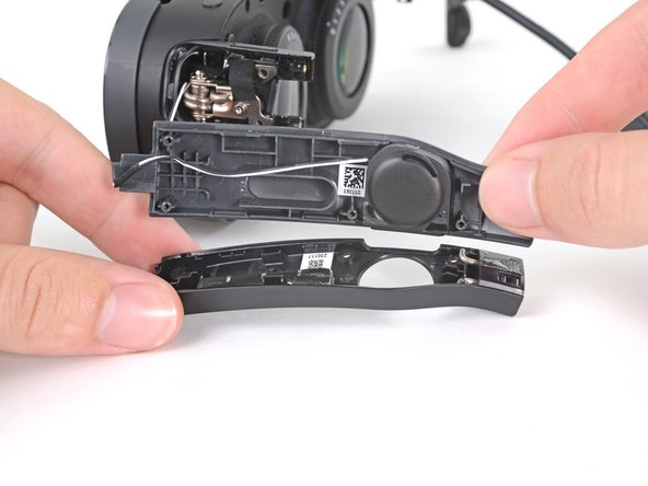

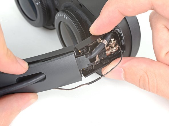

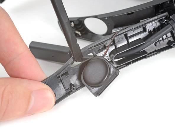

    • The speaker is lightly adhered to the outer temple.
    • Rotate the outer temple towards you to access the speaker.
    • Slide the flat end of a spudger under the speaker to separate its adhesive.
    • During reassembly, if your speaker adhesive isn't sticky, use double-sided tape to re-adhere the speaker to the outer temple.

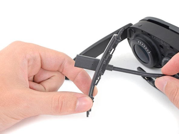

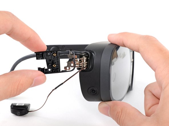

  13. HTC Vive XR Elite Motion Sensor Replacement: crwdns2935265:013crwdnd2935265:01crwdnd2935265:03crwdne2935265:0 HTC Vive XR Elite Motion Sensor Replacement: crwdns2935265:013crwdnd2935265:02crwdnd2935265:03crwdne2935265:0 HTC Vive XR Elite Motion Sensor Replacement: crwdns2935265:013crwdnd2935265:03crwdnd2935265:03crwdne2935265:0
    • Thread the outer temple off of the USB‑C cable and remove it.

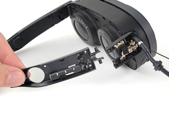

  14. HTC Vive XR Elite Motion Sensor Replacement: crwdns2935265:014crwdnd2935265:01crwdnd2935265:02crwdne2935265:0 HTC Vive XR Elite Motion Sensor Replacement: crwdns2935265:014crwdnd2935265:02crwdnd2935265:02crwdne2935265:0
    • Pull the inner temple out of its slot in the hinge and remove it.

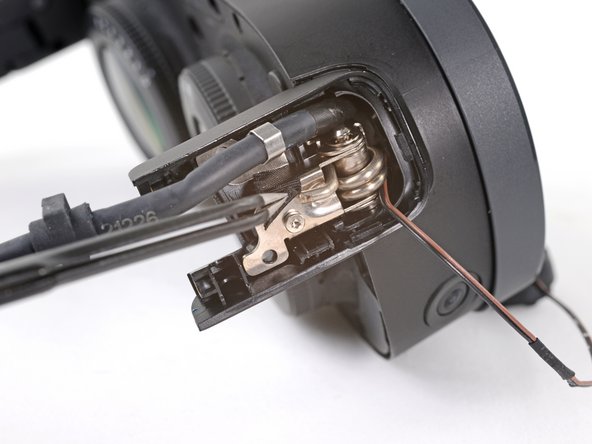

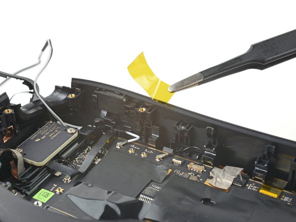

  15. HTC Vive XR Elite Motion Sensor Replacement, Peel the hinge tape: crwdns2935265:015crwdnd2935265:01crwdnd2935265:02crwdne2935265:0 HTC Vive XR Elite Motion Sensor Replacement, Peel the hinge tape: crwdns2935265:015crwdnd2935265:02crwdnd2935265:02crwdne2935265:0
    • Use tweezers to peel back the black tape covering one of the inner hinge cover screws.

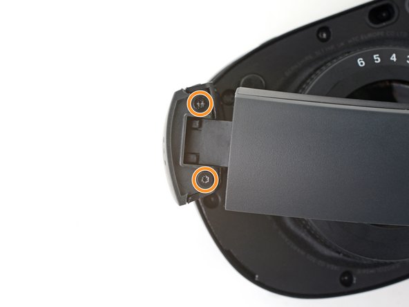

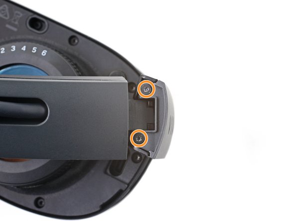

  16. HTC Vive XR Elite Motion Sensor Replacement, Unfasten the inner hinge cover: crwdns2935265:016crwdnd2935265:01crwdnd2935265:01crwdne2935265:0
    • Use a T5 Torx screwdriver to remove the two screws securing the inner hinge cover:
    • One 3.1 mm‑long screw
    • One 4.9 mm‑long screw
  17. HTC Vive XR Elite Motion Sensor Replacement, Remove the inner hinge cover: crwdns2935265:017crwdnd2935265:01crwdnd2935265:03crwdne2935265:0 HTC Vive XR Elite Motion Sensor Replacement, Remove the inner hinge cover: crwdns2935265:017crwdnd2935265:02crwdnd2935265:03crwdne2935265:0 HTC Vive XR Elite Motion Sensor Replacement, Remove the inner hinge cover: crwdns2935265:017crwdnd2935265:03crwdnd2935265:03crwdne2935265:0
    • Rotate the inner hinge cover off its groove in the frame.
    • Thread the inner hinge cover off of the USB-C and speaker cables and remove it.

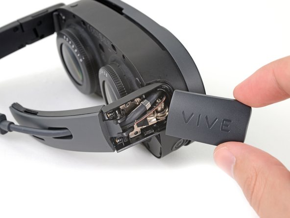

  18. HTC Vive XR Elite Motion Sensor Replacement, Remove the screw covers: crwdns2935265:018crwdnd2935265:01crwdnd2935265:02crwdne2935265:0 HTC Vive XR Elite Motion Sensor Replacement, Remove the screw covers: crwdns2935265:018crwdnd2935265:02crwdnd2935265:02crwdne2935265:0
    • Use tweezers to remove the six screw covers from the left temple.
  19. HTC Vive XR Elite Motion Sensor Replacement, Unfasten the left temple: crwdns2935265:019crwdnd2935265:01crwdnd2935265:02crwdne2935265:0 HTC Vive XR Elite Motion Sensor Replacement, Unfasten the left temple: crwdns2935265:019crwdnd2935265:02crwdnd2935265:02crwdne2935265:0
    • Use a T5 Torx screwdriver to remove the six 4.9 mm‑long screws securing the two left temple halves.
    • Use a T5 Torx screwdriver to remove the two 3.5 mm‑long screws securing the left hinge cover.

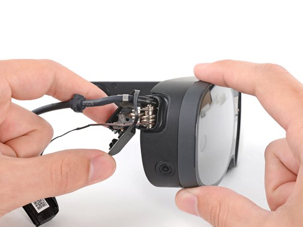

  21. HTC Vive XR Elite Motion Sensor Replacement, Remove the left temple: crwdns2935265:021crwdnd2935265:01crwdnd2935265:02crwdne2935265:0 HTC Vive XR Elite Motion Sensor Replacement, Remove the left temple: crwdns2935265:021crwdnd2935265:02crwdnd2935265:02crwdne2935265:0
    • Pull the left temple out of its slot in the hinge.
    • Don't try to fully remove it yet, as it's still connected by a cable.

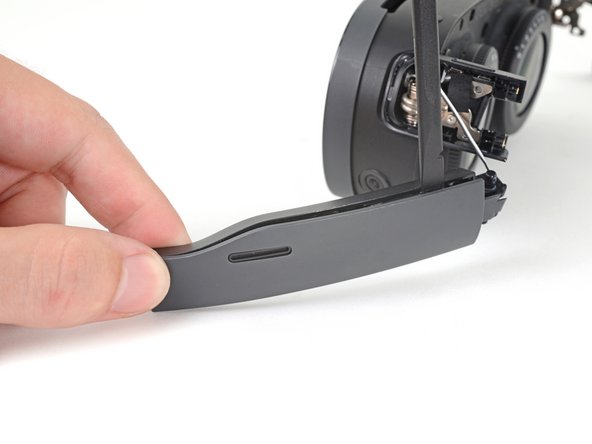

  22. HTC Vive XR Elite Motion Sensor Replacement: crwdns2935265:022crwdnd2935265:01crwdnd2935265:02crwdne2935265:0 HTC Vive XR Elite Motion Sensor Replacement: crwdns2935265:022crwdnd2935265:02crwdnd2935265:02crwdne2935265:0
    • Slide the spudger along the gap to separate the plastic clips securing the outer temple.

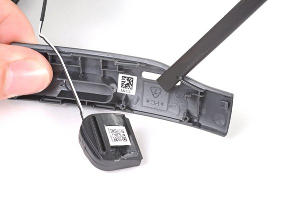

    • Let the speaker rest next to the headset before continuing.
    • During reassembly, if your speaker adhesive isn't sticky, use Tesa 61395 Tape to re-adhere the speaker to the outer temple.

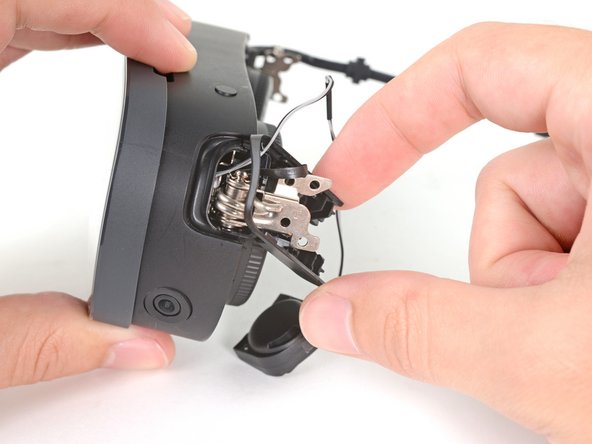

  27. HTC Vive XR Elite Motion Sensor Replacement, Reposition the inner hinge cover: crwdns2935265:027crwdnd2935265:01crwdnd2935265:03crwdne2935265:0 HTC Vive XR Elite Motion Sensor Replacement, Reposition the inner hinge cover: crwdns2935265:027crwdnd2935265:02crwdnd2935265:03crwdne2935265:0 HTC Vive XR Elite Motion Sensor Replacement, Reposition the inner hinge cover: crwdns2935265:027crwdnd2935265:03crwdnd2935265:03crwdne2935265:0
    • Don't fully remove the inner hinge cover, as it's connected by the volume button cable.
    • Let the cover hang off its volume button cable for now.

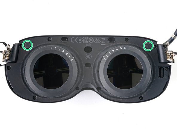

  28. HTC Vive XR Elite Motion Sensor Replacement, Unfasten the face plate: crwdns2935265:028crwdnd2935265:01crwdnd2935265:02crwdne2935265:0 HTC Vive XR Elite Motion Sensor Replacement, Unfasten the face plate: crwdns2935265:028crwdnd2935265:02crwdnd2935265:02crwdne2935265:0
    • Use a T5 Torx screwdriver to remove the 12 screws securing the face plate:
    • Six 3.5 mm‑long screws
    • Four 4.9 mm‑long screws
    • Two 6.5 mm‑long screws
    • There are two magnets at the top corners of the face plate. As you remove nearby screws, they might stick to them.

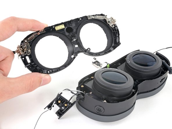

  29. HTC Vive XR Elite Motion Sensor Replacement, Unclip the face cover: crwdns2935265:029crwdnd2935265:01crwdnd2935265:02crwdne2935265:0 HTC Vive XR Elite Motion Sensor Replacement, Unclip the face cover: crwdns2935265:029crwdnd2935265:02crwdnd2935265:02crwdne2935265:0
    • Insert the flat end of the spudger in the gap between the frame and the bottom right corner of the face cover.
    • Pry up with the spudger to release the clips securing the face cover.
  30. HTC Vive XR Elite Motion Sensor Replacement: crwdns2935265:030crwdnd2935265:01crwdnd2935265:02crwdne2935265:0 HTC Vive XR Elite Motion Sensor Replacement: crwdns2935265:030crwdnd2935265:02crwdnd2935265:02crwdne2935265:0
    • Repeat the prying process for the middle and bottom left portions of the face cover.

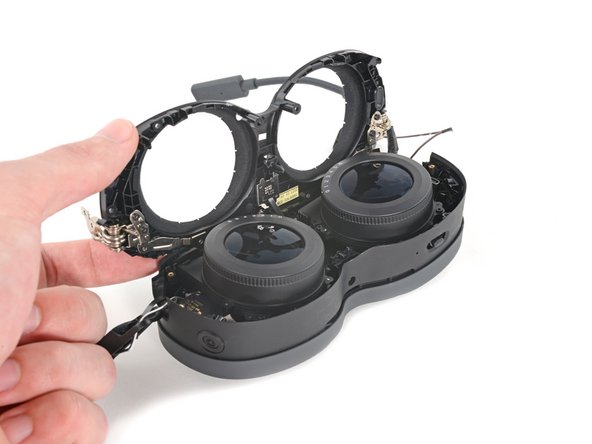

  31. HTC Vive XR Elite Motion Sensor Replacement, Reposition the face cover: crwdns2935265:031crwdnd2935265:01crwdnd2935265:03crwdne2935265:0 HTC Vive XR Elite Motion Sensor Replacement, Reposition the face cover: crwdns2935265:031crwdnd2935265:02crwdnd2935265:03crwdne2935265:0 HTC Vive XR Elite Motion Sensor Replacement, Reposition the face cover: crwdns2935265:031crwdnd2935265:03crwdnd2935265:03crwdne2935265:0
    • Don't fully remove the face cover completely, as it's connected by the proximity sensor cable.
    • Lift the face cover and rotate it over the top of the frame.
    • Lay the face cover face up before continuing.

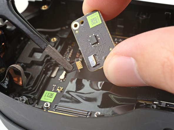

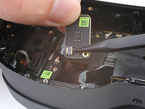

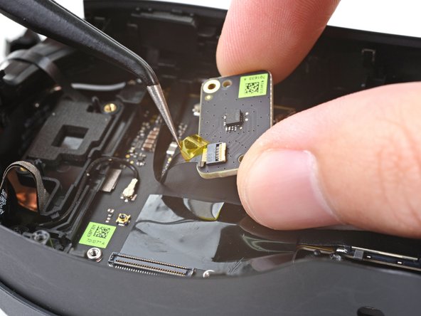

  32. HTC Vive XR Elite Motion Sensor Replacement, Unfasten the proximity sensor: crwdns2935265:032crwdnd2935265:01crwdnd2935265:01crwdne2935265:0
    • Use a T5 Torx screwdriver to remove the two 3.3 mm‑long screws securing the proximity sensor cable.
  33. HTC Vive XR Elite Motion Sensor Replacement, Remove the face cover: crwdns2935265:033crwdnd2935265:01crwdnd2935265:02crwdne2935265:0 HTC Vive XR Elite Motion Sensor Replacement, Remove the face cover: crwdns2935265:033crwdnd2935265:02crwdnd2935265:02crwdne2935265:0
    • Remove the face cover.

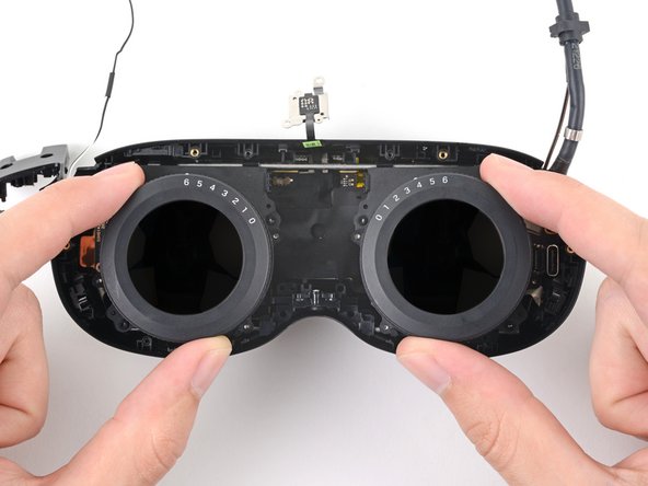

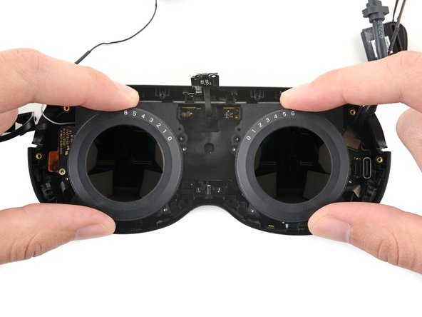

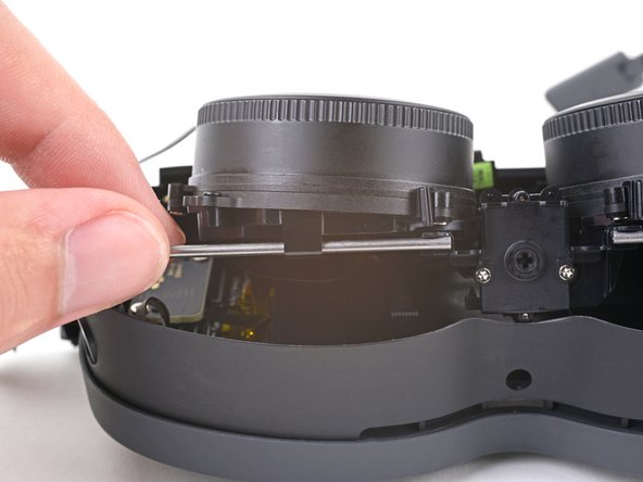

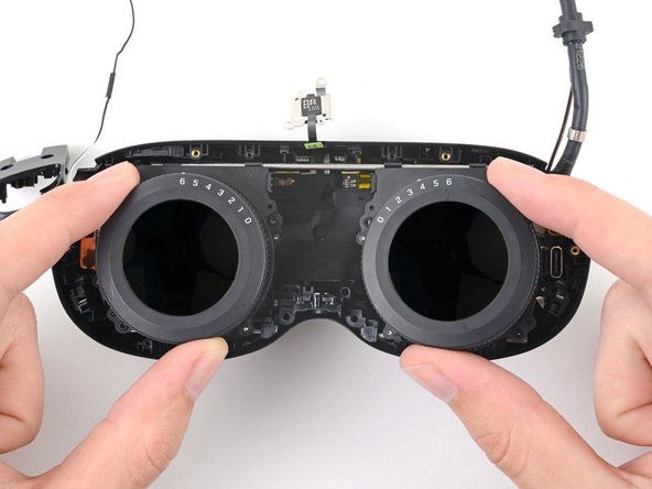

  34. HTC Vive XR Elite Motion Sensor Replacement, Reposition the lens assembly: crwdns2935265:034crwdnd2935265:01crwdnd2935265:02crwdne2935265:0 HTC Vive XR Elite Motion Sensor Replacement, Reposition the lens assembly: crwdns2935265:034crwdnd2935265:02crwdnd2935265:02crwdne2935265:0
    • Pull the two lenses outward so they're as far apart as possible.

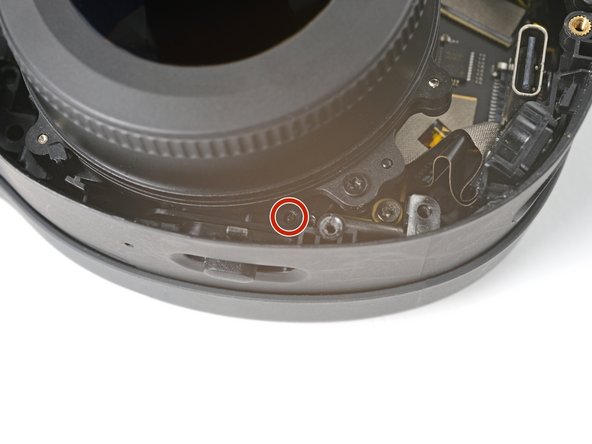

  35. HTC Vive XR Elite Motion Sensor Replacement, Unfasten the lens assembly: crwdns2935265:035crwdnd2935265:01crwdnd2935265:01crwdne2935265:0
    • Use a T5 Torx screwdriver to remove the four screws securing the lens assembly:
    • Three 4.9 mm‑long screws
    • One 3.3 mm‑long screw

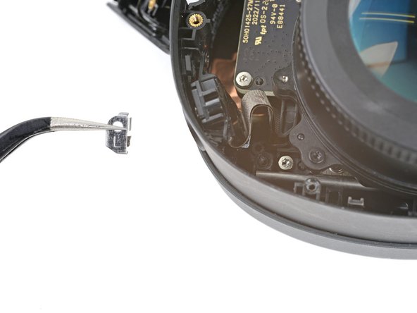

  36. HTC Vive XR Elite Motion Sensor Replacement, Remove the brackets: crwdns2935265:036crwdnd2935265:01crwdnd2935265:03crwdne2935265:0 HTC Vive XR Elite Motion Sensor Replacement, Remove the brackets: crwdns2935265:036crwdnd2935265:02crwdnd2935265:03crwdne2935265:0 HTC Vive XR Elite Motion Sensor Replacement, Remove the brackets: crwdns2935265:036crwdnd2935265:03crwdnd2935265:03crwdne2935265:0
    • The screw brackets are secured with clips and adhesive.
    • Use tweezers to pull the left screw bracket of its post in the frame.
    • This may require some force. Be careful not to scratch any surrounding components.
    • Repeat this process for the right bracket.
    • During reassembly, use tweezers to align the brackets on their posts. Press down with the flat end of a spudger to engage and re-adhere the clips.

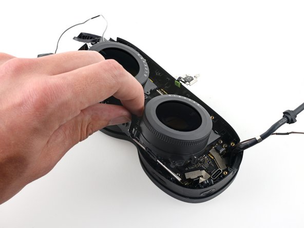

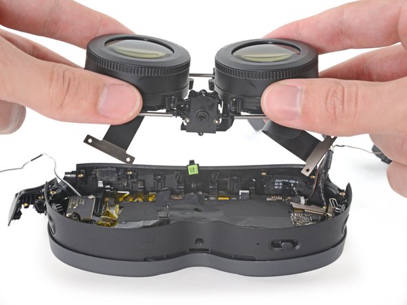

  37. HTC Vive XR Elite Motion Sensor Replacement, Reposition the lens assembly: crwdns2935265:037crwdnd2935265:01crwdnd2935265:02crwdne2935265:0 HTC Vive XR Elite Motion Sensor Replacement, Reposition the lens assembly: crwdns2935265:037crwdnd2935265:02crwdnd2935265:02crwdne2935265:0
    • Lift the bottom of the lens assembly up to separate the bottom rails from their slots in the frame.
  38. HTC Vive XR Elite Motion Sensor Replacement: crwdns2935265:038crwdnd2935265:01crwdnd2935265:03crwdne2935265:0 HTC Vive XR Elite Motion Sensor Replacement: crwdns2935265:038crwdnd2935265:02crwdnd2935265:03crwdne2935265:0 HTC Vive XR Elite Motion Sensor Replacement: crwdns2935265:038crwdnd2935265:03crwdnd2935265:03crwdne2935265:0
    • Pull the lens assembly upwards to separate the top rails from their slots in the frame.
    • Rotate the lens assembly towards the top of the frame so it sits upright with its cable connectors exposed.

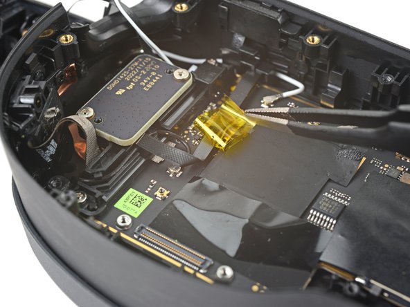

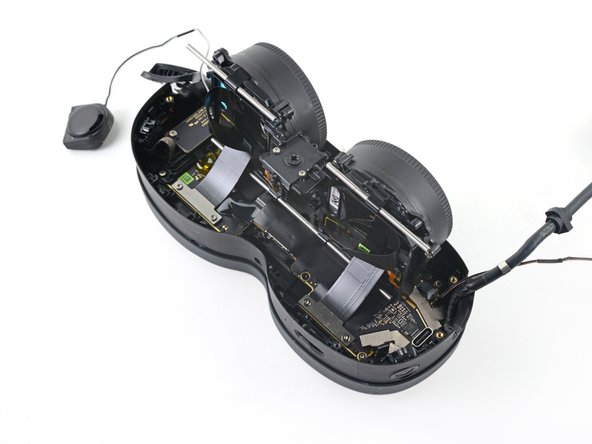

  39. HTC Vive XR Elite Motion Sensor Replacement, Unfasten the lens assembly cables: crwdns2935265:039crwdnd2935265:01crwdnd2935265:01crwdne2935265:0
    • Use a T5 Torx screwdriver to remove the four 3.4 mm‑long screws securing the lens assembly cables.

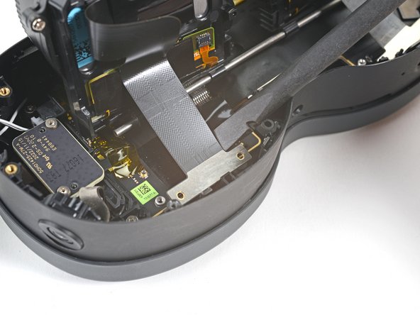

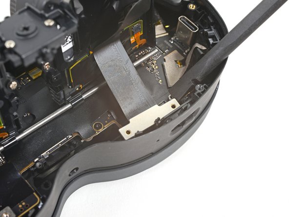

  40. HTC Vive XR Elite Motion Sensor Replacement, Disconnect the lens assembly cables: crwdns2935265:040crwdnd2935265:01crwdnd2935265:03crwdne2935265:0 HTC Vive XR Elite Motion Sensor Replacement, Disconnect the lens assembly cables: crwdns2935265:040crwdnd2935265:02crwdnd2935265:03crwdne2935265:0 HTC Vive XR Elite Motion Sensor Replacement, Disconnect the lens assembly cables: crwdns2935265:040crwdnd2935265:03crwdnd2935265:03crwdne2935265:0
    • Use the flat end of a spudger to pry up and disconnect the lens assembly cable connector.
    • Repeat this procedure for the other connector.
    • To re-attach press connectors like this one, carefully align and press down on one side until it clicks into place, then repeat on the other side. Don't press down on the middle. If the connector is misaligned, the pins can bend, causing permanent damage.

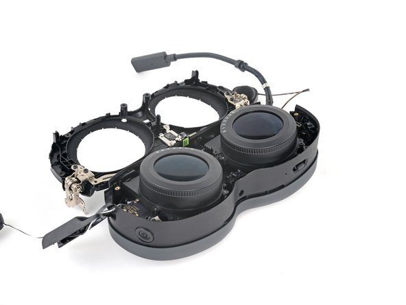

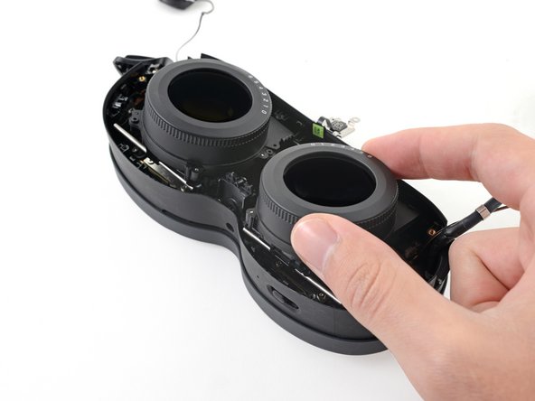

  41. HTC Vive XR Elite Motion Sensor Replacement, Remove the lens assembly: crwdns2935265:041crwdnd2935265:01crwdnd2935265:02crwdne2935265:0 HTC Vive XR Elite Motion Sensor Replacement, Remove the lens assembly: crwdns2935265:041crwdnd2935265:02crwdnd2935265:02crwdne2935265:0
    • Lift up and remove the lens assembly.

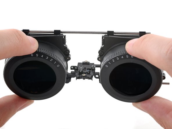

  42. HTC Vive XR Elite Motion Sensor Replacement, Reassembly information: crwdns2935265:042crwdnd2935265:01crwdnd2935265:03crwdne2935265:0 HTC Vive XR Elite Motion Sensor Replacement, Reassembly information: crwdns2935265:042crwdnd2935265:02crwdnd2935265:03crwdne2935265:0 HTC Vive XR Elite Motion Sensor Replacement, Reassembly information: crwdns2935265:042crwdnd2935265:03crwdnd2935265:03crwdne2935265:0
    • The next four steps demonstrate how to secure the lens assembly to the frame during reassembly.
    • In order for the lens assembly to rest in the frame properly, it needs to align with a peg in the IPD (interpupillary distance) slider.
    • Before reinstalling the lens assembly, push the IPD slider to its right-most position.

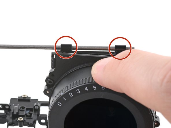

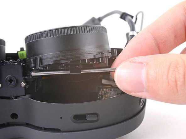

  43. HTC Vive XR Elite Motion Sensor Replacement: crwdns2935265:043crwdnd2935265:01crwdnd2935265:03crwdne2935265:0 HTC Vive XR Elite Motion Sensor Replacement: crwdns2935265:043crwdnd2935265:02crwdnd2935265:03crwdne2935265:0 HTC Vive XR Elite Motion Sensor Replacement: crwdns2935265:043crwdnd2935265:03crwdnd2935265:03crwdne2935265:0
    • Pull the lens assembly outward until its plastic clips sit close to the end of the top rails.
    • You may need to push and pull the top rail so it sits evenly across the plastic clips.
  44. HTC Vive XR Elite Motion Sensor Replacement: crwdns2935265:044crwdnd2935265:01crwdnd2935265:03crwdne2935265:0 HTC Vive XR Elite Motion Sensor Replacement: crwdns2935265:044crwdnd2935265:02crwdnd2935265:03crwdne2935265:0 HTC Vive XR Elite Motion Sensor Replacement: crwdns2935265:044crwdnd2935265:03crwdnd2935265:03crwdne2935265:0
    • Push the bottom rails inwards as far as they will go.
  45. HTC Vive XR Elite Motion Sensor Replacement: crwdns2935265:045crwdnd2935265:01crwdnd2935265:03crwdne2935265:0 HTC Vive XR Elite Motion Sensor Replacement: crwdns2935265:045crwdnd2935265:02crwdnd2935265:03crwdne2935265:0 HTC Vive XR Elite Motion Sensor Replacement: crwdns2935265:045crwdnd2935265:03crwdnd2935265:03crwdne2935265:0
    • To secure the lens assembly into the frame:
    • Slide the top left rail into its slot.
    • Align the other rails.
    • Press the lens assembly into place, making sure to realign the center peg.
  46. HTC Vive XR Elite Motion Sensor Replacement, Peel the tape: crwdns2935265:046crwdnd2935265:01crwdnd2935265:03crwdne2935265:0 HTC Vive XR Elite Motion Sensor Replacement, Peel the tape: crwdns2935265:046crwdnd2935265:02crwdnd2935265:03crwdne2935265:0 HTC Vive XR Elite Motion Sensor Replacement, Peel the tape: crwdns2935265:046crwdnd2935265:03crwdnd2935265:03crwdne2935265:0
    • Peel off the yellow tape covering the motion sensor cable.
  47. HTC Vive XR Elite Motion Sensor Replacement, Unfasten the motion sensor: crwdns2935265:047crwdnd2935265:01crwdnd2935265:01crwdne2935265:0
    • Use a T5 Torx screwdriver to remove the two 3.4 mm‑long screws securing the motion sensor.
  48. HTC Vive XR Elite Motion Sensor Replacement, Reposition the motion sensor: crwdns2935265:048crwdnd2935265:01crwdnd2935265:03crwdne2935265:0 HTC Vive XR Elite Motion Sensor Replacement, Reposition the motion sensor: crwdns2935265:048crwdnd2935265:02crwdnd2935265:03crwdne2935265:0 HTC Vive XR Elite Motion Sensor Replacement, Reposition the motion sensor: crwdns2935265:048crwdnd2935265:03crwdnd2935265:03crwdne2935265:0
    • Don't try to fully remove the motion sensor yet, as it's still connected by a cable.
    • Lift the motion sensor off its pegs in the frame.
    • Flip over the motion sensor and lay it on the frame before continuing.

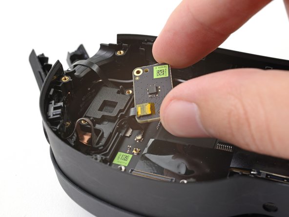

  49. HTC Vive XR Elite Motion Sensor Replacement, Peel the tape: crwdns2935265:049crwdnd2935265:01crwdnd2935265:02crwdne2935265:0 HTC Vive XR Elite Motion Sensor Replacement, Peel the tape: crwdns2935265:049crwdnd2935265:02crwdnd2935265:02crwdne2935265:0
    • Peel off the yellow tape covering the motion sensor cable connector.

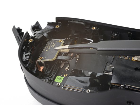

  50. HTC Vive XR Elite Motion Sensor Replacement, Disconnect the motion sensor: crwdns2935265:050crwdnd2935265:01crwdnd2935265:02crwdne2935265:0 HTC Vive XR Elite Motion Sensor Replacement, Disconnect the motion sensor: crwdns2935265:050crwdnd2935265:02crwdnd2935265:02crwdne2935265:0
    • Use the point of a spudger to lift up the locking flap on the motion sensor ZIF connector.
  51. HTC Vive XR Elite Motion Sensor Replacement, Remove the motion sensor: crwdns2935265:051crwdnd2935265:01crwdnd2935265:02crwdne2935265:0 HTC Vive XR Elite Motion Sensor Replacement, Remove the motion sensor: crwdns2935265:051crwdnd2935265:02crwdnd2935265:02crwdne2935265:0
    • Use tweezers to pull the motion sensor cable connector out of its slot.
    • Remove the motion sensor.
