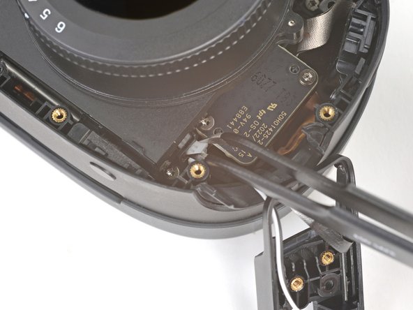

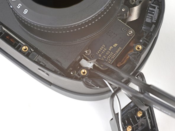

  34. HTC Vive XR Elite Left Speaker Replacement, Disconnect the left speaker: crwdns2935265:034crwdnd2935265:01crwdnd2935265:03crwdne2935265:0 HTC Vive XR Elite Left Speaker Replacement, Disconnect the left speaker: crwdns2935265:034crwdnd2935265:02crwdnd2935265:03crwdne2935265:0 HTC Vive XR Elite Left Speaker Replacement, Disconnect the left speaker: crwdns2935265:034crwdnd2935265:03crwdnd2935265:03crwdne2935265:0
    • Use tweezers to pull the left speaker connector out of its socket.
    • If you're having trouble, try rocking the connector side-to-side to help loosen it.
  35. HTC Vive XR Elite Left Speaker Replacement, Remove the left speaker: crwdns2935265:035crwdnd2935265:01crwdnd2935265:01crwdne2935265:0
    • Remove the left speaker.
