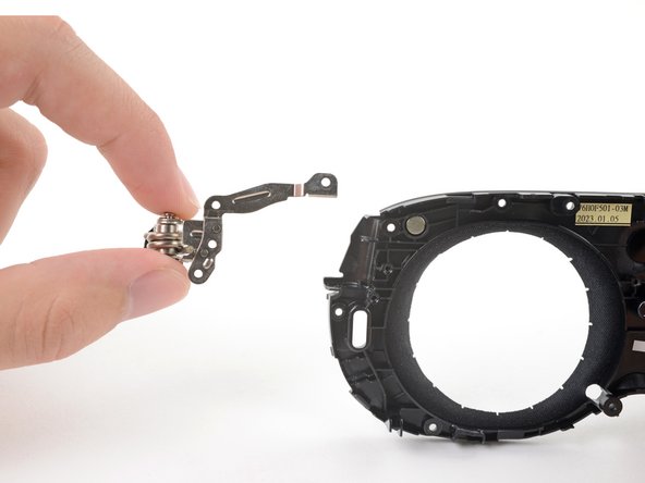

  34. HTC Vive XR Elite Hinges Replacement, Unfasten the hinges: crwdns2935265:034crwdnd2935265:01crwdnd2935265:01crwdne2935265:0
    • Use a T5 Torx screwdriver to remove the four 4.7 mm‑long screws securing the hinges.
  35. HTC Vive XR Elite Hinges Replacement, Remove the hinges: crwdns2935265:035crwdnd2935265:01crwdnd2935265:03crwdne2935265:0 HTC Vive XR Elite Hinges Replacement, Remove the hinges: crwdns2935265:035crwdnd2935265:02crwdnd2935265:03crwdne2935265:0 HTC Vive XR Elite Hinges Replacement, Remove the hinges: crwdns2935265:035crwdnd2935265:03crwdnd2935265:03crwdne2935265:0
    • Pull the hinges of their slots in the frame.
    • You might feel some resistance, as there's a magnet sitting underneath it.
