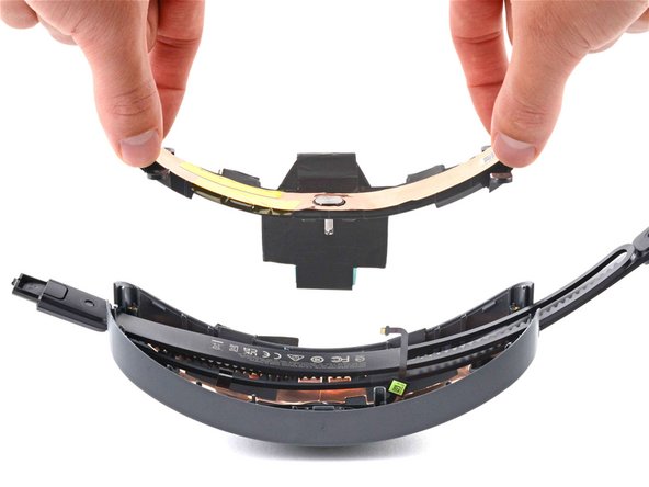

  10. HTC Vive XR Elite Headstraps Replacement, Separate the battery cradle halves: crwdns2935265:010crwdnd2935265:01crwdnd2935265:02crwdne2935265:0 HTC Vive XR Elite Headstraps Replacement, Separate the battery cradle halves: crwdns2935265:010crwdnd2935265:02crwdnd2935265:02crwdne2935265:0
    • Pull apart the two halves of the battery cradle to completely separate them.

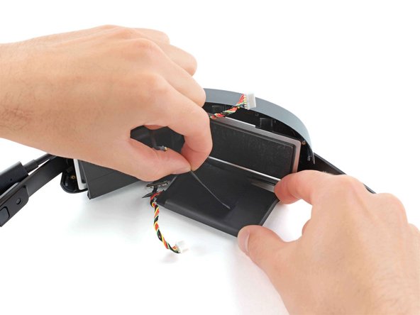

  11. HTC Vive XR Elite Headstraps Replacement, Peel back the graphite thermal tape: crwdns2935265:011crwdnd2935265:01crwdnd2935265:03crwdne2935265:0 HTC Vive XR Elite Headstraps Replacement, Peel back the graphite thermal tape: crwdns2935265:011crwdnd2935265:02crwdnd2935265:03crwdne2935265:0 HTC Vive XR Elite Headstraps Replacement, Peel back the graphite thermal tape: crwdns2935265:011crwdnd2935265:03crwdnd2935265:03crwdne2935265:0
    • Use tweezers to peel back the graphite thermal tape covering the inner plastic frame.
    • If the tape tears a little, don't worry! During reassembly, stick it back in its original place as if it were still one piece

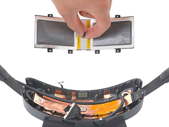

  16. HTC Vive XR Elite Headstraps Replacement, Peel back the battery board thermal pad: crwdns2935265:016crwdnd2935265:01crwdnd2935265:03crwdne2935265:0 HTC Vive XR Elite Headstraps Replacement, Peel back the battery board thermal pad: crwdns2935265:016crwdnd2935265:02crwdnd2935265:03crwdne2935265:0 HTC Vive XR Elite Headstraps Replacement, Peel back the battery board thermal pad: crwdns2935265:016crwdnd2935265:03crwdnd2935265:03crwdne2935265:0
    • Use tweezers or your fingers to peel back the thermal pad covering the battery board.
    • Work slowly to avoid tearing the thermal pad.
  17. HTC Vive XR Elite Headstraps Replacement, Disconnect the batteries: crwdns2935265:017crwdnd2935265:01crwdnd2935265:03crwdne2935265:0 HTC Vive XR Elite Headstraps Replacement, Disconnect the batteries: crwdns2935265:017crwdnd2935265:02crwdnd2935265:03crwdne2935265:0 HTC Vive XR Elite Headstraps Replacement, Disconnect the batteries: crwdns2935265:017crwdnd2935265:03crwdnd2935265:03crwdne2935265:0
    • Use the flat end of a spudger to push the left and right battery cell connectors out of their respective sockets.
  18. HTC Vive XR Elite Headstraps Replacement, Disconnect the power LED: crwdns2935265:018crwdnd2935265:01crwdnd2935265:03crwdne2935265:0 HTC Vive XR Elite Headstraps Replacement, Disconnect the power LED: crwdns2935265:018crwdnd2935265:02crwdnd2935265:03crwdne2935265:0 HTC Vive XR Elite Headstraps Replacement, Disconnect the power LED: crwdns2935265:018crwdnd2935265:03crwdnd2935265:03crwdne2935265:0
    • Use the point of a spudger to flip up the locking flap on the power LED ZIF connector.
    • Use tweezers or your fingers to disconnect the power LED cable.
    • During reassembly, slide the cable into the connector and close the locking flap. If the cable is getting stuck, gently remove it and realign it before trying again.
  19. HTC Vive XR Elite Headstraps Replacement, Disconnect the USB-C power cable: crwdns2935265:019crwdnd2935265:01crwdnd2935265:02crwdne2935265:0 HTC Vive XR Elite Headstraps Replacement, Disconnect the USB-C power cable: crwdns2935265:019crwdnd2935265:02crwdnd2935265:02crwdne2935265:0
    • Pull the black tab straight up on the USB-C power cable to disconnect it.
    • During reassembly, align the cable directly over the connector and press straight down to reconnect it.
  20. HTC Vive XR Elite Headstraps Replacement, Peel back the conductive tape: crwdns2935265:020crwdnd2935265:01crwdnd2935265:02crwdne2935265:0 HTC Vive XR Elite Headstraps Replacement, Peel back the conductive tape: crwdns2935265:020crwdnd2935265:02crwdnd2935265:02crwdne2935265:0
    • Use tweezers or your fingers to peel the conductive tape away from the front metal battery enclosure.
  21. HTC Vive XR Elite Headstraps Replacement, Unfasten the battery board: crwdns2935265:021crwdnd2935265:01crwdnd2935265:02crwdne2935265:0 HTC Vive XR Elite Headstraps Replacement, Unfasten the battery board: crwdns2935265:021crwdnd2935265:02crwdnd2935265:02crwdne2935265:0
    • Use a T5 Torx screwdriver to remove the four 4.1 mm-long screws securing the battery board.
  22. HTC Vive XR Elite Headstraps Replacement, Remove the battery board: crwdns2935265:022crwdnd2935265:01crwdnd2935265:02crwdne2935265:0 HTC Vive XR Elite Headstraps Replacement, Remove the battery board: crwdns2935265:022crwdnd2935265:02crwdnd2935265:02crwdne2935265:0
    • Remove the battery board.

  26. HTC Vive XR Elite Headstraps Replacement, Reposition the battery cradle: crwdns2935265:026crwdnd2935265:01crwdnd2935265:01crwdne2935265:0
    • Stand the battery cradle upright so the battery cells can fold flat on your work surface.

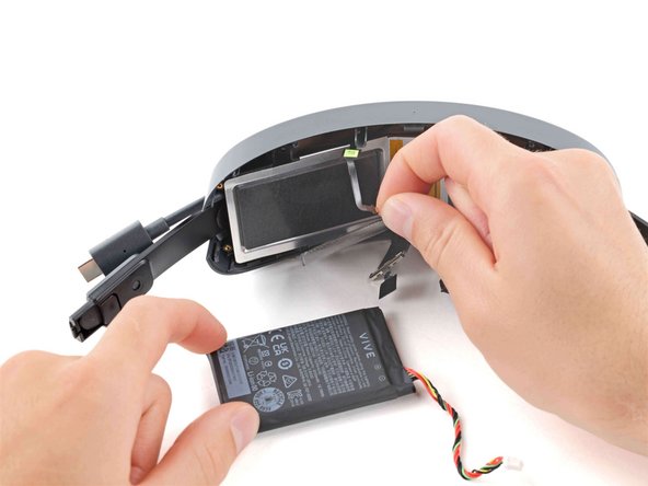

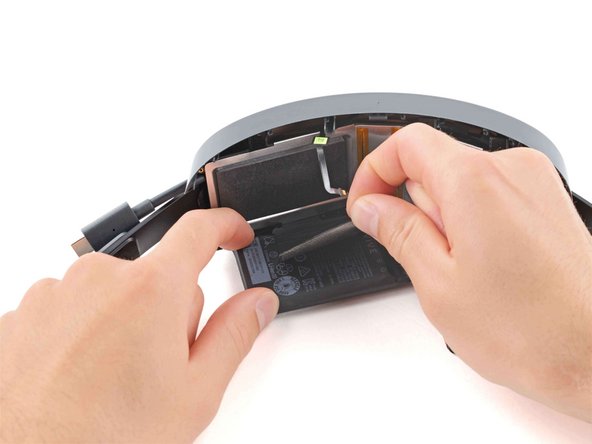

  27. HTC Vive XR Elite Headstraps Replacement, Remove the right battery cell: crwdns2935265:027crwdnd2935265:01crwdnd2935265:03crwdne2935265:0 HTC Vive XR Elite Headstraps Replacement, Remove the right battery cell: crwdns2935265:027crwdnd2935265:02crwdnd2935265:03crwdne2935265:0 HTC Vive XR Elite Headstraps Replacement, Remove the right battery cell: crwdns2935265:027crwdnd2935265:03crwdnd2935265:03crwdne2935265:0
    • Don't try to fully remove the batteries yet, as they're still attached to the cradle with graphite thermal tape.
    • Peel off the graphite thermal tape covering the right battery cell.
    • Remove the right battery cell.

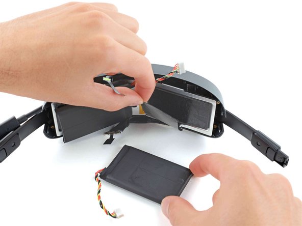

  28. HTC Vive XR Elite Headstraps Replacement, Remove the left battery cell: crwdns2935265:028crwdnd2935265:01crwdnd2935265:03crwdne2935265:0 HTC Vive XR Elite Headstraps Replacement, Remove the left battery cell: crwdns2935265:028crwdnd2935265:02crwdnd2935265:03crwdne2935265:0 HTC Vive XR Elite Headstraps Replacement, Remove the left battery cell: crwdns2935265:028crwdnd2935265:03crwdnd2935265:03crwdne2935265:0
    • Repeat the previous step for the left battery cell.

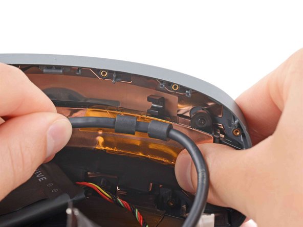

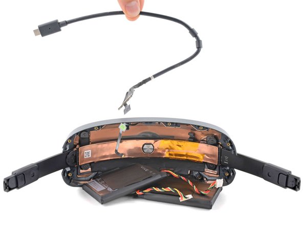

  30. HTC Vive XR Elite Headstraps Replacement, Remove the USB-C power cable: crwdns2935265:030crwdnd2935265:01crwdnd2935265:03crwdne2935265:0 HTC Vive XR Elite Headstraps Replacement, Remove the USB-C power cable: crwdns2935265:030crwdnd2935265:02crwdnd2935265:03crwdne2935265:0 HTC Vive XR Elite Headstraps Replacement, Remove the USB-C power cable: crwdns2935265:030crwdnd2935265:03crwdnd2935265:03crwdne2935265:0
    • Hold one end of the USB-C power cable and pull it straight back to unclip it.
    • Remove the USB-C power cable.

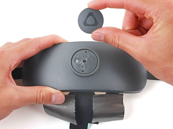

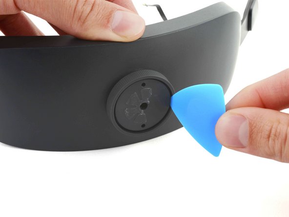

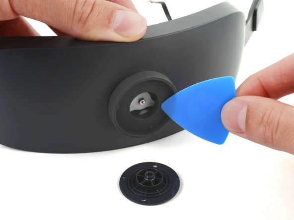

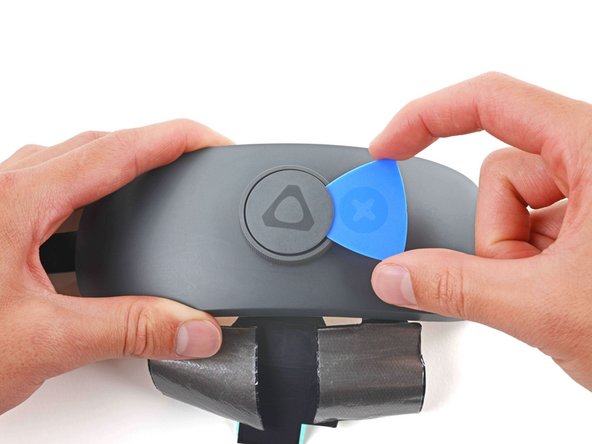

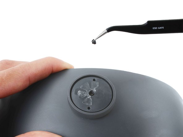

  31. HTC Vive XR Elite Headstraps Replacement, Remove the adjustment dial faceplate: crwdns2935265:031crwdnd2935265:01crwdnd2935265:03crwdne2935265:0 HTC Vive XR Elite Headstraps Replacement, Remove the adjustment dial faceplate: crwdns2935265:031crwdnd2935265:02crwdnd2935265:03crwdne2935265:0 HTC Vive XR Elite Headstraps Replacement, Remove the adjustment dial faceplate: crwdns2935265:031crwdnd2935265:03crwdnd2935265:03crwdne2935265:0
    Tesa 61395 Tape
    $2.99
    • Insert an opening pick under the adjustment dial faceplate.
    • Pry up to separate the adhesive securing the faceplate.
    • Remove the faceplate.
    • During reassembly, clean off any old adhesive using high-strength (>90%) isopropyl alcohol and a lint-free cloth. Use Tesa Tape to secure the faceplate to the adjustment dial.

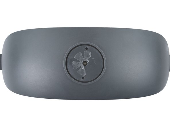

  32. HTC Vive XR Elite Headstraps Replacement, Remove the plastic tape: crwdns2935265:032crwdnd2935265:01crwdnd2935265:02crwdne2935265:0 HTC Vive XR Elite Headstraps Replacement, Remove the plastic tape: crwdns2935265:032crwdnd2935265:02crwdnd2935265:02crwdne2935265:0
    • Use tweezers to remove the plastic tape covering the adjustment dial screw.

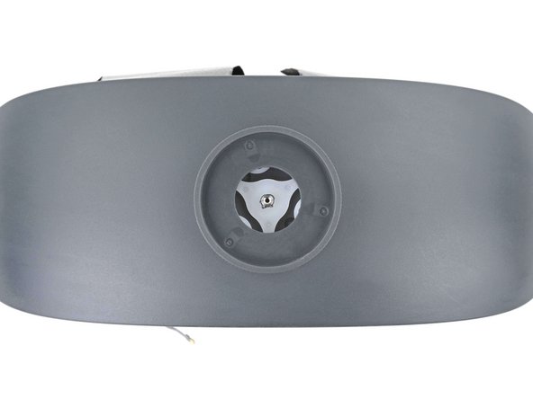

  33. HTC Vive XR Elite Headstraps Replacement, Unfasten the adjustment dial: crwdns2935265:033crwdnd2935265:01crwdnd2935265:02crwdne2935265:0 HTC Vive XR Elite Headstraps Replacement, Unfasten the adjustment dial: crwdns2935265:033crwdnd2935265:02crwdnd2935265:02crwdne2935265:0
    • Use a Torx T5 screwdriver to remove the 3.8 mm-long screw securing the adjustment dial.
  34. HTC Vive XR Elite Headstraps Replacement, Remove the adjustment dial screw spacer: crwdns2935265:034crwdnd2935265:01crwdnd2935265:03crwdne2935265:0 HTC Vive XR Elite Headstraps Replacement, Remove the adjustment dial screw spacer: crwdns2935265:034crwdnd2935265:02crwdnd2935265:03crwdne2935265:0 HTC Vive XR Elite Headstraps Replacement, Remove the adjustment dial screw spacer: crwdns2935265:034crwdnd2935265:03crwdnd2935265:03crwdne2935265:0
    • Insert an opening pick between the adjustment dial and the screw spacer.
    • Pry the screw spacer away from the adjustment dial to remove it.

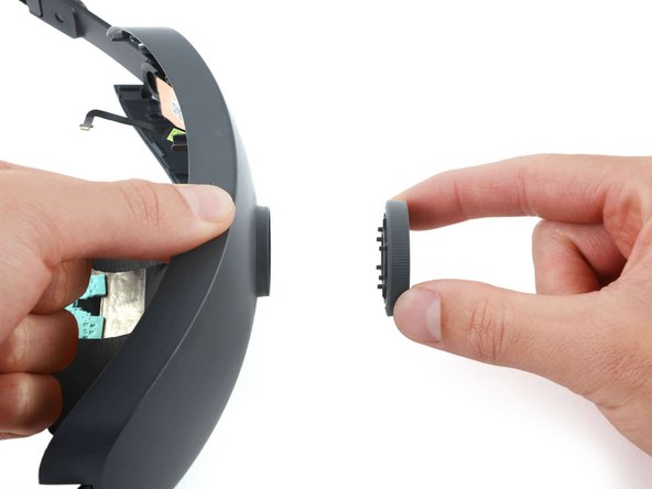

  35. HTC Vive XR Elite Headstraps Replacement, Remove the adjustment dial: crwdns2935265:035crwdnd2935265:01crwdnd2935265:02crwdne2935265:0 HTC Vive XR Elite Headstraps Replacement, Remove the adjustment dial: crwdns2935265:035crwdnd2935265:02crwdnd2935265:02crwdne2935265:0
    • Pull the adjustment dial straight off the cradle and remove it.

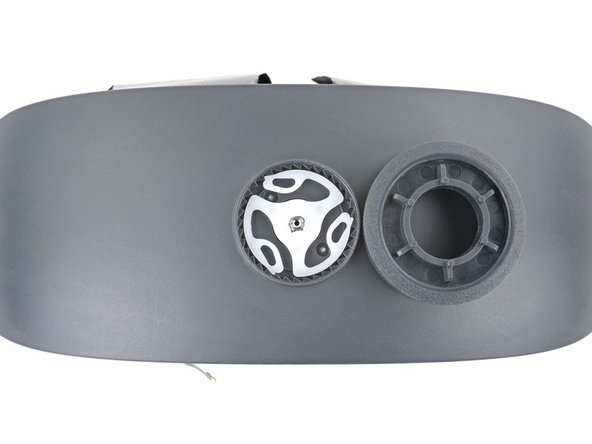

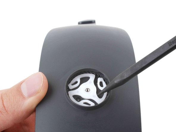

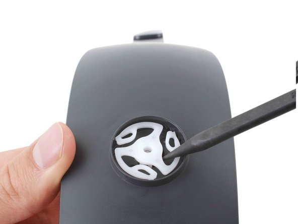

  36. HTC Vive XR Elite Headstraps Replacement, Remove the adjustment dial sprocket: crwdns2935265:036crwdnd2935265:01crwdnd2935265:03crwdne2935265:0 HTC Vive XR Elite Headstraps Replacement, Remove the adjustment dial sprocket: crwdns2935265:036crwdnd2935265:02crwdnd2935265:03crwdne2935265:0 HTC Vive XR Elite Headstraps Replacement, Remove the adjustment dial sprocket: crwdns2935265:036crwdnd2935265:03crwdnd2935265:03crwdne2935265:0
    • Use the point of a spudger to pry up the center of the sprocket.
    • Remove the adjustment dial sprocket.

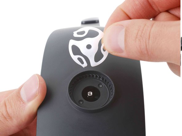

  37. HTC Vive XR Elite Headstraps Replacement, Adjustment dial sprocket reassembly information: crwdns2935265:037crwdnd2935265:01crwdnd2935265:02crwdne2935265:0 HTC Vive XR Elite Headstraps Replacement, Adjustment dial sprocket reassembly information: crwdns2935265:037crwdnd2935265:02crwdnd2935265:02crwdne2935265:0
    • Adjust the headstraps so they're fully retracted into the cradle.
    • Insert the sprocket so its teeth fully mesh with the teeth in the socket.
  38. HTC Vive XR Elite Headstraps Replacement, Adjustment dial reassembly information: crwdns2935265:038crwdnd2935265:01crwdnd2935265:03crwdne2935265:0 HTC Vive XR Elite Headstraps Replacement, Adjustment dial reassembly information: crwdns2935265:038crwdnd2935265:02crwdnd2935265:03crwdne2935265:0 HTC Vive XR Elite Headstraps Replacement, Adjustment dial reassembly information: crwdns2935265:038crwdnd2935265:03crwdnd2935265:03crwdne2935265:0
    • During reassembly, make sure three pegs on the adjustment dial are inserted into the three cutouts on the sprocket:
    • Three adjustment dial pegs
    • Three sprocket cutouts
    • Use the molding marks to align the dial over the cutouts on the sprocket.
    • You'll know the dial is installed correctly when it easily turns counterclockwise and clicks when turned clockwise.

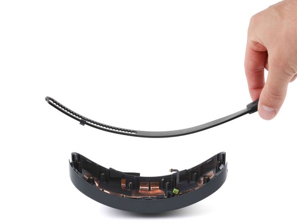

    • The headstraps will spring up when the guide is removed.

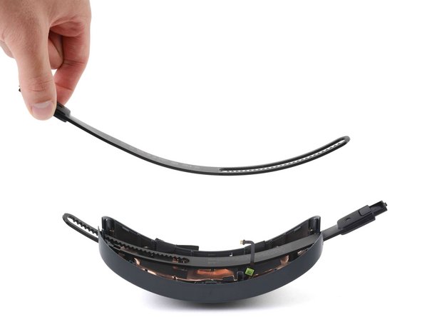

  41. HTC Vive XR Elite Headstraps Replacement, Remove the headstraps: crwdns2935265:041crwdnd2935265:01crwdnd2935265:03crwdne2935265:0 HTC Vive XR Elite Headstraps Replacement, Remove the headstraps: crwdns2935265:041crwdnd2935265:02crwdnd2935265:03crwdne2935265:0 HTC Vive XR Elite Headstraps Replacement, Remove the headstraps: crwdns2935265:041crwdnd2935265:03crwdnd2935265:03crwdne2935265:0
    • Remove the left and right headstraps
    • During reassembly, reinstall the right headstrap first and the left one on top of it.
