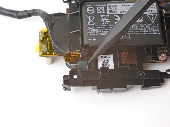

  99. HTC Vive XR Elite Headset Battery Replacement, Disconnect the battery: crwdns2935265:099crwdnd2935265:01crwdnd2935265:02crwdne2935265:0 HTC Vive XR Elite Headset Battery Replacement, Disconnect the battery: crwdns2935265:099crwdnd2935265:02crwdnd2935265:02crwdne2935265:0
    • Flip the motherboard assembly over so the fan is facing upward.
    • Use the point of a spudger to pry up and disconnect the headset battery press connector.

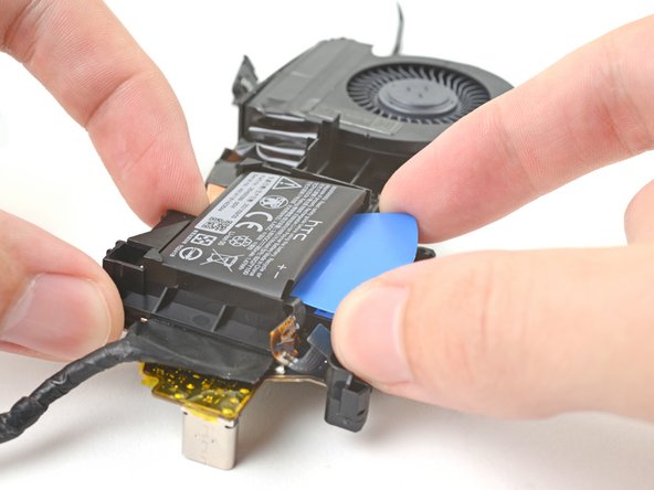

  100. HTC Vive XR Elite Headset Battery Replacement, Remove the battery: crwdns2935265:0100crwdnd2935265:01crwdnd2935265:02crwdne2935265:0 HTC Vive XR Elite Headset Battery Replacement, Remove the battery: crwdns2935265:0100crwdnd2935265:02crwdnd2935265:02crwdne2935265:0
    • The battery is lightly adhered to the motherboard frame.
    • Take care not to puncture or bend the battery—it can leak dangerous chemicals and/or catch fire.
    • Slide an opening pick under the battery.

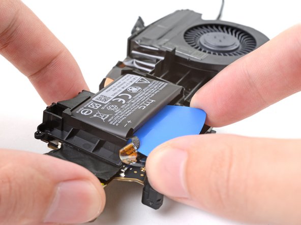

  101. HTC Vive XR Elite Headset Battery Replacement: crwdns2935265:0101crwdnd2935265:01crwdnd2935265:02crwdne2935265:0 HTC Vive XR Elite Headset Battery Replacement: crwdns2935265:0101crwdnd2935265:02crwdnd2935265:02crwdne2935265:0
    • Slide the opening pick back and forth to separate the adhesive securing the battery.

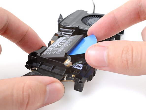

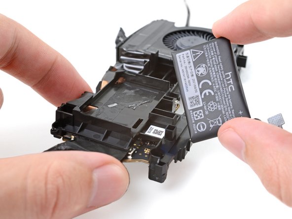

  102. HTC Vive XR Elite Headset Battery Replacement: crwdns2935265:0102crwdnd2935265:01crwdnd2935265:03crwdne2935265:0 HTC Vive XR Elite Headset Battery Replacement: crwdns2935265:0102crwdnd2935265:02crwdnd2935265:03crwdne2935265:0 HTC Vive XR Elite Headset Battery Replacement: crwdns2935265:0102crwdnd2935265:03crwdnd2935265:03crwdne2935265:0
    • Lift the opening pick to separate the battery from the motherboard frame.
    • Remove the battery.
