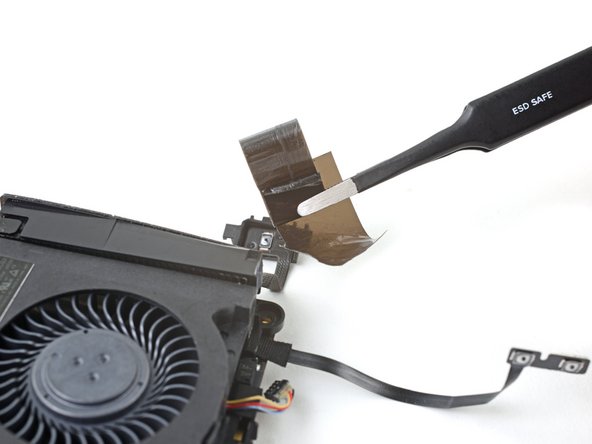

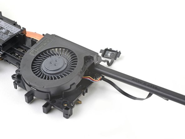

  15. HTC Vive XR Elite Fan Replacement, Peel the hinge tape: crwdns2935265:015crwdnd2935265:01crwdnd2935265:02crwdne2935265:0 HTC Vive XR Elite Fan Replacement, Peel the hinge tape: crwdns2935265:015crwdnd2935265:02crwdnd2935265:02crwdne2935265:0
    • Use tweezers to peel back the black tape covering one of the inner hinge cover screws.
  16. HTC Vive XR Elite Fan Replacement, Unfasten the inner hinge cover: crwdns2935265:016crwdnd2935265:01crwdnd2935265:01crwdne2935265:0
    • Use a T5 Torx screwdriver to remove the two screws securing the inner hinge cover:
    • One 3.1 mm‑long screw
    • One 4.9 mm‑long screw
  17. HTC Vive XR Elite Fan Replacement, Remove the inner hinge cover: crwdns2935265:017crwdnd2935265:01crwdnd2935265:03crwdne2935265:0 HTC Vive XR Elite Fan Replacement, Remove the inner hinge cover: crwdns2935265:017crwdnd2935265:02crwdnd2935265:03crwdne2935265:0 HTC Vive XR Elite Fan Replacement, Remove the inner hinge cover: crwdns2935265:017crwdnd2935265:03crwdnd2935265:03crwdne2935265:0
    • Rotate the inner hinge cover off its groove in the frame.
    • Thread the inner hinge cover off of the USB-C and speaker cables and remove it.

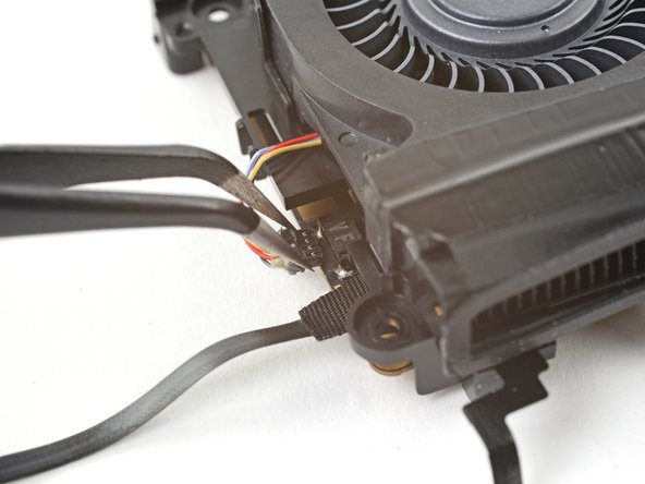

  100. HTC Vive XR Elite Fan Replacement, Disconnect the fan: crwdns2935265:0100crwdnd2935265:01crwdnd2935265:02crwdne2935265:0 HTC Vive XR Elite Fan Replacement, Disconnect the fan: crwdns2935265:0100crwdnd2935265:02crwdnd2935265:02crwdne2935265:0
    • Use tweezers to pull the fan cable connector out of its slot in the motherboard.

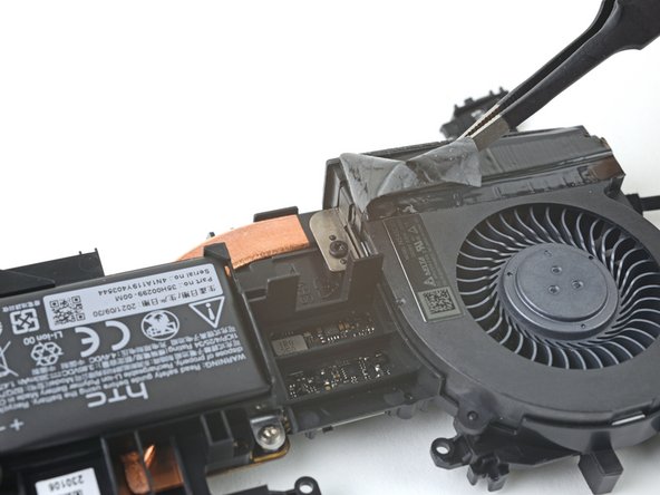

  101. HTC Vive XR Elite Fan Replacement, Peel the tape: crwdns2935265:0101crwdnd2935265:01crwdnd2935265:03crwdne2935265:0 HTC Vive XR Elite Fan Replacement, Peel the tape: crwdns2935265:0101crwdnd2935265:02crwdnd2935265:03crwdne2935265:0 HTC Vive XR Elite Fan Replacement, Peel the tape: crwdns2935265:0101crwdnd2935265:03crwdnd2935265:03crwdne2935265:0
    • Peel off the black tape covering the top of the fan.

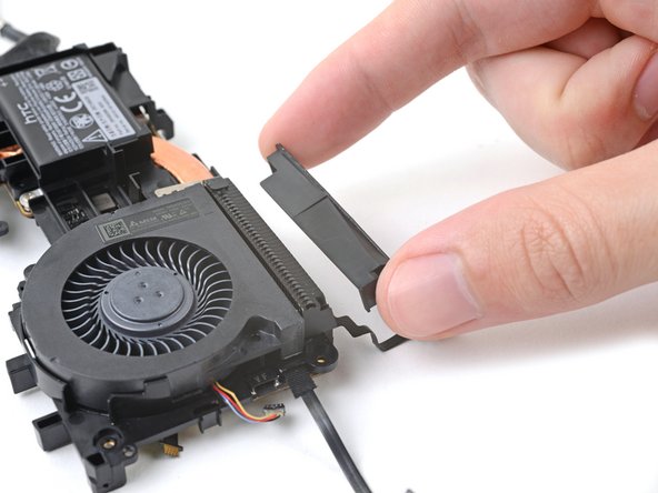

  102. HTC Vive XR Elite Fan Replacement, Remove the heat sink cover: crwdns2935265:0102crwdnd2935265:01crwdnd2935265:02crwdne2935265:0 HTC Vive XR Elite Fan Replacement, Remove the heat sink cover: crwdns2935265:0102crwdnd2935265:02crwdnd2935265:02crwdne2935265:0
    • Pull the heatsink cover off the motherboard frame and remove it.

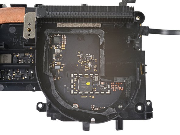

  103. HTC Vive XR Elite Fan Replacement, Disassembly information: crwdns2935265:0103crwdnd2935265:01crwdnd2935265:02crwdne2935265:0 HTC Vive XR Elite Fan Replacement, Disassembly information: crwdns2935265:0103crwdnd2935265:02crwdnd2935265:02crwdne2935265:0
    • The fan is secured with adhesive around its perimeter.
    • The middle portion of the fan housing exposes the motherboard. Keep tools away from the middle of the fan to avoid damaging the motherboard.

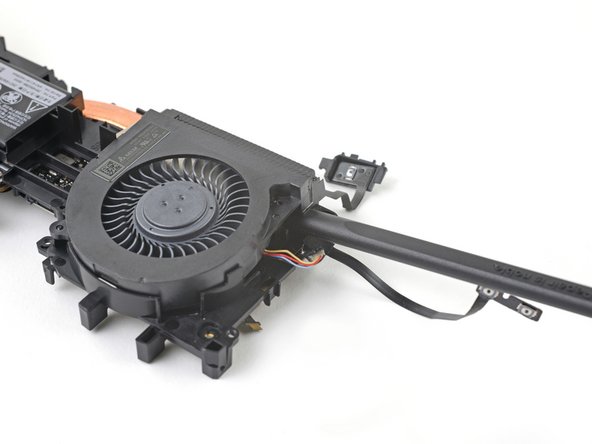

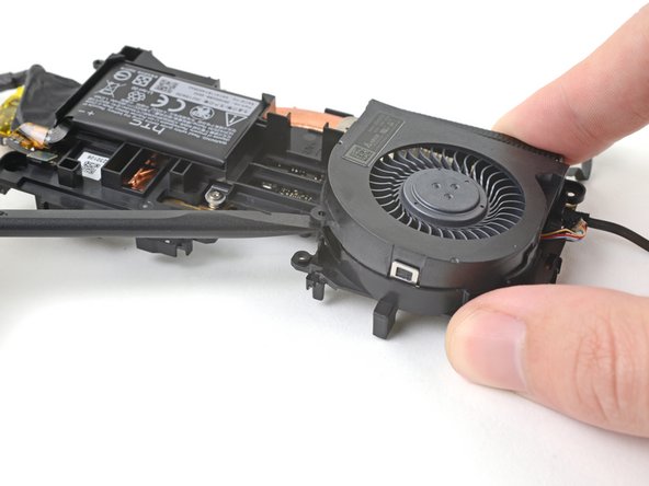

  104. HTC Vive XR Elite Fan Replacement, Separate the fan adhesive: crwdns2935265:0104crwdnd2935265:01crwdnd2935265:03crwdne2935265:0 HTC Vive XR Elite Fan Replacement, Separate the fan adhesive: crwdns2935265:0104crwdnd2935265:02crwdnd2935265:03crwdne2935265:0 HTC Vive XR Elite Fan Replacement, Separate the fan adhesive: crwdns2935265:0104crwdnd2935265:03crwdnd2935265:03crwdne2935265:0
    • Support the motherboard with one hand before during this step.
    • Insert the flat end of the spudger under the top right corner of the fan.
    • Slide the spudger under the top of the fan to separate the top adhesive.

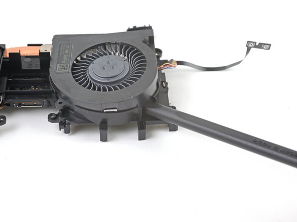

  105. HTC Vive XR Elite Fan Replacement: crwdns2935265:0105crwdnd2935265:01crwdnd2935265:02crwdne2935265:0 HTC Vive XR Elite Fan Replacement: crwdns2935265:0105crwdnd2935265:02crwdnd2935265:02crwdne2935265:0
    • Insert the flat end of the spudger under the bottom right corner of the fan.
    • Only insert the spudger up to 5 mm to avoid touching the motherboard.
    • Twist the spudger to separate the bottom adhesive.

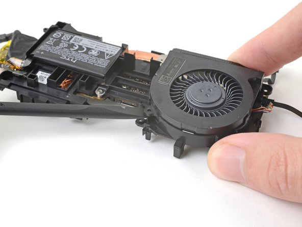

  106. HTC Vive XR Elite Fan Replacement: crwdns2935265:0106crwdnd2935265:01crwdnd2935265:03crwdne2935265:0 HTC Vive XR Elite Fan Replacement: crwdns2935265:0106crwdnd2935265:02crwdnd2935265:03crwdne2935265:0 HTC Vive XR Elite Fan Replacement: crwdns2935265:0106crwdnd2935265:03crwdnd2935265:03crwdne2935265:0
    • Insert the flat end of a spudger under the lip in the fan's peg hole.
    • Lift up with the spudger to separate the remaining fan adhesive.

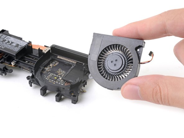

  107. HTC Vive XR Elite Fan Replacement, Remove the fan: crwdns2935265:0107crwdnd2935265:01crwdnd2935265:02crwdne2935265:0 HTC Vive XR Elite Fan Replacement, Remove the fan: crwdns2935265:0107crwdnd2935265:02crwdnd2935265:02crwdne2935265:0
    • Lift the fan out of its housing and remove it.
