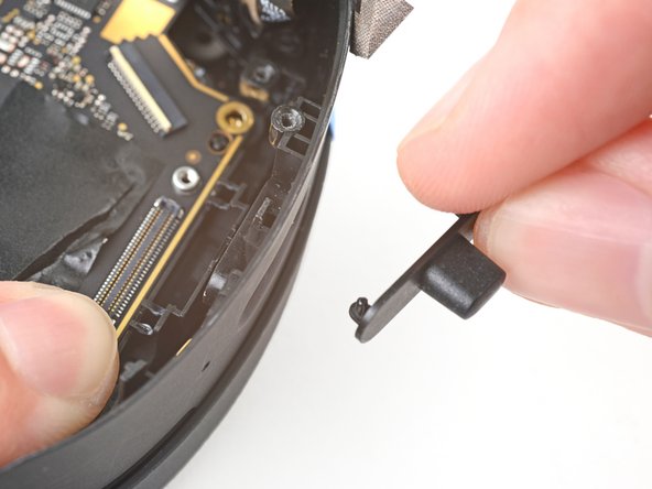

  7. HTC Vive XR Elite Depth Sensor Replacement, Remove the screw covers: crwdns2935265:07crwdnd2935265:01crwdnd2935265:02crwdne2935265:0 HTC Vive XR Elite Depth Sensor Replacement, Remove the screw covers: crwdns2935265:07crwdnd2935265:02crwdnd2935265:02crwdne2935265:0
    • Use tweezers to remove the six screw covers from the right temple.

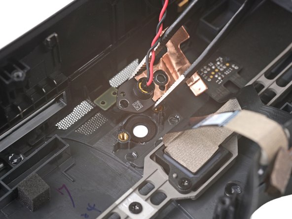

  32. HTC Vive XR Elite Depth Sensor Replacement, Unfasten the proximity sensor: crwdns2935265:032crwdnd2935265:01crwdnd2935265:01crwdne2935265:0
    • Use a T5 Torx screwdriver to remove the two 3.3 mm‑long screws securing the proximity sensor cable.
  33. HTC Vive XR Elite Depth Sensor Replacement, Remove the face cover: crwdns2935265:033crwdnd2935265:01crwdnd2935265:02crwdne2935265:0 HTC Vive XR Elite Depth Sensor Replacement, Remove the face cover: crwdns2935265:033crwdnd2935265:02crwdnd2935265:02crwdne2935265:0
    • Remove the face cover.

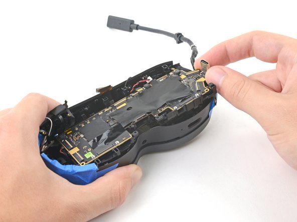

  34. HTC Vive XR Elite Depth Sensor Replacement, Reposition the lens assembly: crwdns2935265:034crwdnd2935265:01crwdnd2935265:02crwdne2935265:0 HTC Vive XR Elite Depth Sensor Replacement, Reposition the lens assembly: crwdns2935265:034crwdnd2935265:02crwdnd2935265:02crwdne2935265:0
    • Pull the two lenses outward so they're as far apart as possible.
  35. HTC Vive XR Elite Depth Sensor Replacement, Unfasten the lens assembly: crwdns2935265:035crwdnd2935265:01crwdnd2935265:01crwdne2935265:0
    • Use a T5 Torx screwdriver to remove the four screws securing the lens assembly:
    • Three 4.9 mm‑long screws
    • One 3.3 mm‑long screw

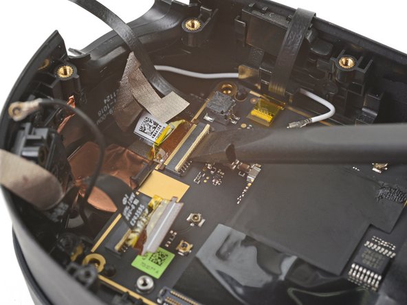

  38. HTC Vive XR Elite Depth Sensor Replacement: crwdns2935265:038crwdnd2935265:01crwdnd2935265:03crwdne2935265:0 HTC Vive XR Elite Depth Sensor Replacement: crwdns2935265:038crwdnd2935265:02crwdnd2935265:03crwdne2935265:0 HTC Vive XR Elite Depth Sensor Replacement: crwdns2935265:038crwdnd2935265:03crwdnd2935265:03crwdne2935265:0
    • Pull the lens assembly upwards to separate the top rails from their slots in the frame.
    • Rotate the lens assembly towards the top of the frame so it sits upright with its cable connectors exposed.

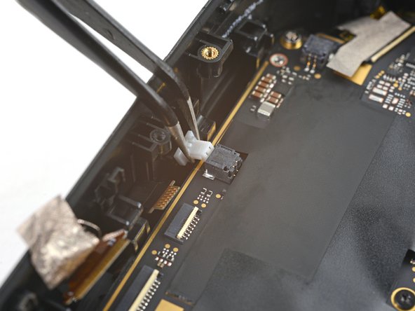

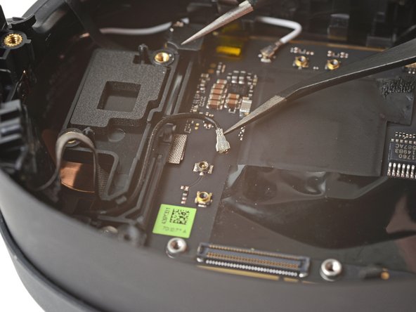

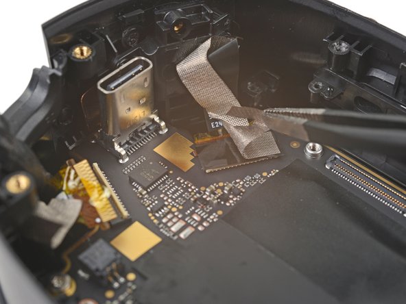

  39. HTC Vive XR Elite Depth Sensor Replacement, Unfasten the lens assembly cables: crwdns2935265:039crwdnd2935265:01crwdnd2935265:01crwdne2935265:0
    • Use a T5 Torx screwdriver to remove the four 3.4 mm‑long screws securing the lens assembly cables.
  40. HTC Vive XR Elite Depth Sensor Replacement, Disconnect the lens assembly cables: crwdns2935265:040crwdnd2935265:01crwdnd2935265:03crwdne2935265:0 HTC Vive XR Elite Depth Sensor Replacement, Disconnect the lens assembly cables: crwdns2935265:040crwdnd2935265:02crwdnd2935265:03crwdne2935265:0 HTC Vive XR Elite Depth Sensor Replacement, Disconnect the lens assembly cables: crwdns2935265:040crwdnd2935265:03crwdnd2935265:03crwdne2935265:0
    • Use the flat end of a spudger to pry up and disconnect the lens assembly cable connector.
    • Repeat this procedure for the other connector.
    • To re-attach press connectors like this one, carefully align and press down on one side until it clicks into place, then repeat on the other side. Don't press down on the middle. If the connector is misaligned, the pins can bend, causing permanent damage.

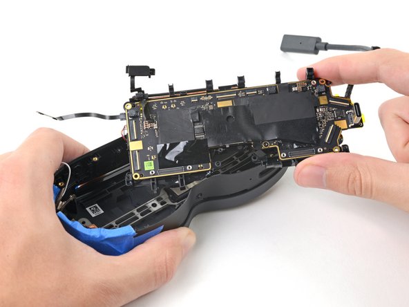

  41. HTC Vive XR Elite Depth Sensor Replacement, Remove the lens assembly: crwdns2935265:041crwdnd2935265:01crwdnd2935265:02crwdne2935265:0 HTC Vive XR Elite Depth Sensor Replacement, Remove the lens assembly: crwdns2935265:041crwdnd2935265:02crwdnd2935265:02crwdne2935265:0
    • Lift up and remove the lens assembly.
  42. HTC Vive XR Elite Depth Sensor Replacement, Reassembly information: crwdns2935265:042crwdnd2935265:01crwdnd2935265:03crwdne2935265:0 HTC Vive XR Elite Depth Sensor Replacement, Reassembly information: crwdns2935265:042crwdnd2935265:02crwdnd2935265:03crwdne2935265:0 HTC Vive XR Elite Depth Sensor Replacement, Reassembly information: crwdns2935265:042crwdnd2935265:03crwdnd2935265:03crwdne2935265:0
    • The next four steps demonstrate how to secure the lens assembly to the frame during reassembly.
    • In order for the lens assembly to rest in the frame properly, it needs to align with a peg in the IPD (interpupillary distance) slider.
    • Before reinstalling the lens assembly, push the IPD slider to its right-most position.

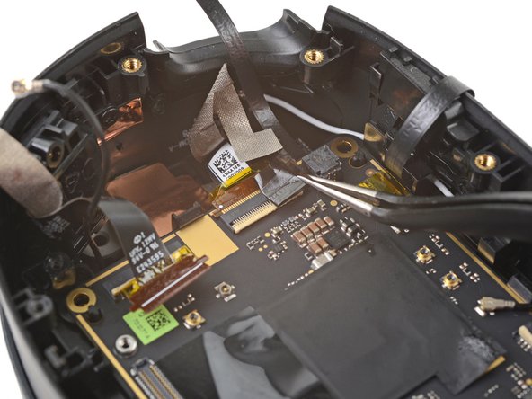

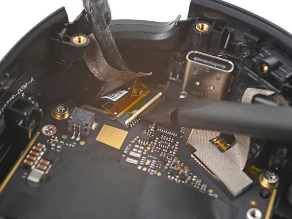

    • Peel off the yellow tape covering the proximity sensor connector.
  48. HTC Vive XR Elite Depth Sensor Replacement, Disconnect the proximity sensor: crwdns2935265:048crwdnd2935265:01crwdnd2935265:02crwdne2935265:0 HTC Vive XR Elite Depth Sensor Replacement, Disconnect the proximity sensor: crwdns2935265:048crwdnd2935265:02crwdnd2935265:02crwdne2935265:0
    • Use the point of a spudger to lift up the locking flap on the proximity sensor ZIF connector.
  49. HTC Vive XR Elite Depth Sensor Replacement: crwdns2935265:049crwdnd2935265:01crwdnd2935265:02crwdne2935265:0 HTC Vive XR Elite Depth Sensor Replacement: crwdns2935265:049crwdnd2935265:02crwdnd2935265:02crwdne2935265:0
    • Use tweezers to pull the proximity sensor cable out of its slot in the motherboard.
  50. HTC Vive XR Elite Depth Sensor Replacement, Remove the proximity sensor: crwdns2935265:050crwdnd2935265:01crwdnd2935265:01crwdne2935265:0
    • Remove the proximity sensor.

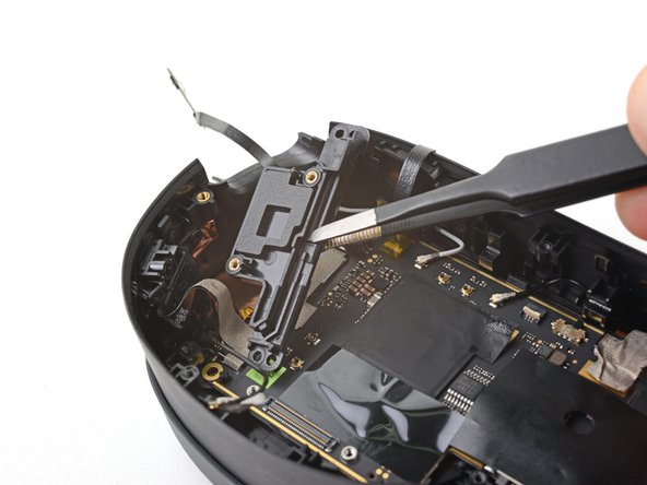

  51. HTC Vive XR Elite Depth Sensor Replacement, Peel the tape: crwdns2935265:051crwdnd2935265:01crwdnd2935265:03crwdne2935265:0 HTC Vive XR Elite Depth Sensor Replacement, Peel the tape: crwdns2935265:051crwdnd2935265:02crwdnd2935265:03crwdne2935265:0 HTC Vive XR Elite Depth Sensor Replacement, Peel the tape: crwdns2935265:051crwdnd2935265:03crwdnd2935265:03crwdne2935265:0
    • Peel off the yellow tape covering the motion sensor cable.
  52. HTC Vive XR Elite Depth Sensor Replacement, Unfasten the motion sensor: crwdns2935265:052crwdnd2935265:01crwdnd2935265:01crwdne2935265:0
    • Use a T5 Torx screwdriver to remove the two 3.4 mm‑long screws securing the motion sensor.

  57. HTC Vive XR Elite Depth Sensor Replacement, Disconnect the right speaker: crwdns2935265:057crwdnd2935265:01crwdnd2935265:03crwdne2935265:0 HTC Vive XR Elite Depth Sensor Replacement, Disconnect the right speaker: crwdns2935265:057crwdnd2935265:02crwdnd2935265:03crwdne2935265:0 HTC Vive XR Elite Depth Sensor Replacement, Disconnect the right speaker: crwdns2935265:057crwdnd2935265:03crwdnd2935265:03crwdne2935265:0
    • Use tweezers to pull the right speaker connector out of its socket.
    • If you're having trouble, try rocking the connector side-to-side to help loosen it.
  58. HTC Vive XR Elite Depth Sensor Replacement, Remove the right speaker: crwdns2935265:058crwdnd2935265:01crwdnd2935265:01crwdne2935265:0
    • Remove the right speaker.

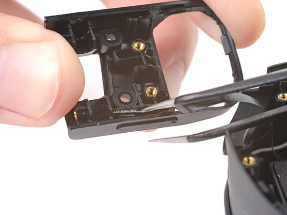

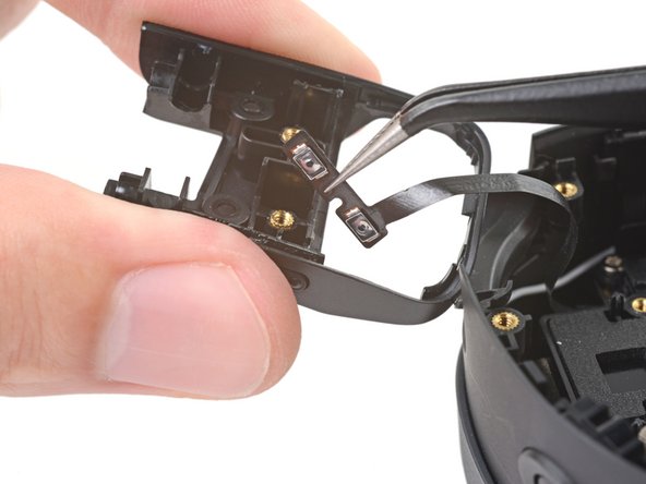

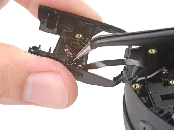

  61. HTC Vive XR Elite Depth Sensor Replacement, Separate the volume button cable: crwdns2935265:061crwdnd2935265:01crwdnd2935265:02crwdne2935265:0 HTC Vive XR Elite Depth Sensor Replacement, Separate the volume button cable: crwdns2935265:061crwdnd2935265:02crwdnd2935265:02crwdne2935265:0
    • The volume button cable is lightly adhered to the left inner hinge cover.
    • Insert one arm of your tweezers between the volume button cable and the hinge cover.
    • Pry away from the hinge cover to separate the adhesive.
  62. HTC Vive XR Elite Depth Sensor Replacement: crwdns2935265:062crwdnd2935265:01crwdnd2935265:03crwdne2935265:0 HTC Vive XR Elite Depth Sensor Replacement: crwdns2935265:062crwdnd2935265:02crwdnd2935265:03crwdne2935265:0 HTC Vive XR Elite Depth Sensor Replacement: crwdns2935265:062crwdnd2935265:03crwdnd2935265:03crwdne2935265:0
    • Use your tweezers to pull the volume button cable out of its slot in the hinge cover.

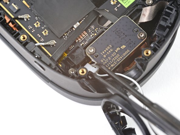

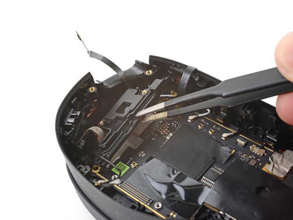

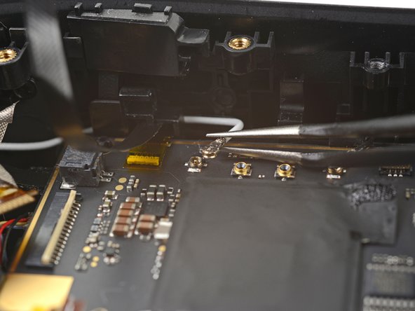

  63. HTC Vive XR Elite Depth Sensor Replacement, Disconnect the bottom left antenna: crwdns2935265:063crwdnd2935265:01crwdnd2935265:02crwdne2935265:0 HTC Vive XR Elite Depth Sensor Replacement, Disconnect the bottom left antenna: crwdns2935265:063crwdnd2935265:02crwdnd2935265:02crwdne2935265:0
    • Use one arm of your tweezers to pry up and disconnect the bottom left antenna cable.
    • During reassembly, these can be tricky to reconnect. Hold the connector in place over its socket and press down with the flat end of a spudger. The connector should snap into place.
  64. HTC Vive XR Elite Depth Sensor Replacement, Reposition the bottom left antenna cable: crwdns2935265:064crwdnd2935265:01crwdnd2935265:02crwdne2935265:0 HTC Vive XR Elite Depth Sensor Replacement, Reposition the bottom left antenna cable: crwdns2935265:064crwdnd2935265:02crwdnd2935265:02crwdne2935265:0

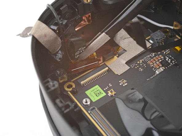

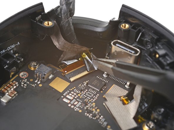

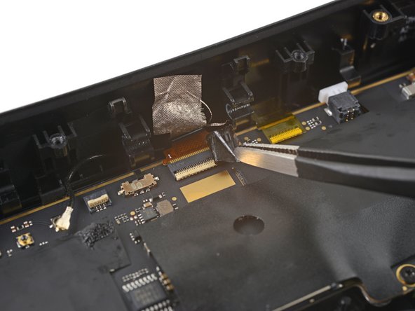

  67. HTC Vive XR Elite Depth Sensor Replacement, Peel the tape: crwdns2935265:067crwdnd2935265:01crwdnd2935265:02crwdne2935265:0 HTC Vive XR Elite Depth Sensor Replacement, Peel the tape: crwdns2935265:067crwdnd2935265:02crwdnd2935265:02crwdne2935265:0
    • Use tweezers to peel back the gray conductive tape covering the left side‑camera ZIF connector.

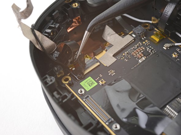

  68. HTC Vive XR Elite Depth Sensor Replacement: crwdns2935265:068crwdnd2935265:01crwdnd2935265:02crwdne2935265:0 HTC Vive XR Elite Depth Sensor Replacement: crwdns2935265:068crwdnd2935265:02crwdnd2935265:02crwdne2935265:0
    • Use tweezers to peel off the black tape covering the left side‑camera ZIF connector.
  69. HTC Vive XR Elite Depth Sensor Replacement, Disconnect the left side camera: crwdns2935265:069crwdnd2935265:01crwdnd2935265:02crwdne2935265:0 HTC Vive XR Elite Depth Sensor Replacement, Disconnect the left side camera: crwdns2935265:069crwdnd2935265:02crwdnd2935265:02crwdne2935265:0
    • Use flat end of a spudger to lift up the locking flap on the left side‑camera ZIF connector.
  70. HTC Vive XR Elite Depth Sensor Replacement: crwdns2935265:070crwdnd2935265:01crwdnd2935265:02crwdne2935265:0 HTC Vive XR Elite Depth Sensor Replacement: crwdns2935265:070crwdnd2935265:02crwdnd2935265:02crwdne2935265:0
    • Use tweezers to pull the left side‑camera cable connector out of its slot in the motherboard.

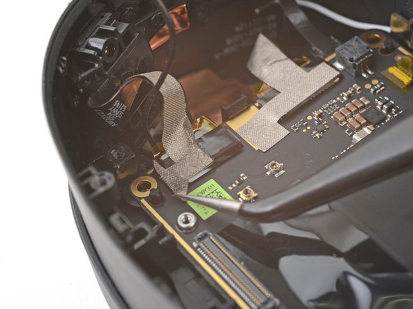

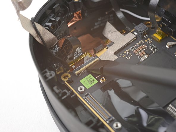

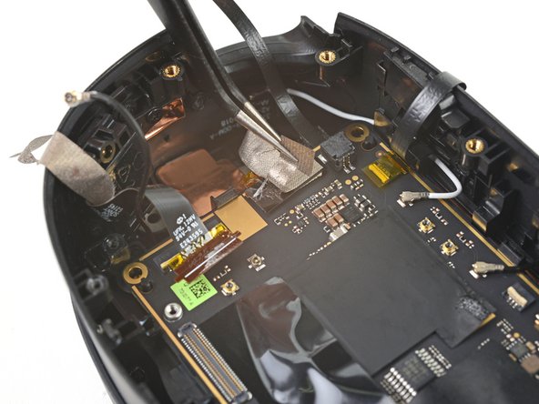

  71. HTC Vive XR Elite Depth Sensor Replacement, Peel the tape: crwdns2935265:071crwdnd2935265:01crwdnd2935265:02crwdne2935265:0 HTC Vive XR Elite Depth Sensor Replacement, Peel the tape: crwdns2935265:071crwdnd2935265:02crwdnd2935265:02crwdne2935265:0
    • Use tweezers to peel back the gray conductive tape covering the left tracking camera ZIF connector.
  72. HTC Vive XR Elite Depth Sensor Replacement: crwdns2935265:072crwdnd2935265:01crwdnd2935265:02crwdne2935265:0 HTC Vive XR Elite Depth Sensor Replacement: crwdns2935265:072crwdnd2935265:02crwdnd2935265:02crwdne2935265:0
    • Use tweezers to peel off the black tape covering the left tracking camera ZIF connector.
  73. HTC Vive XR Elite Depth Sensor Replacement, Disconnect the left tracking camera: crwdns2935265:073crwdnd2935265:01crwdnd2935265:02crwdne2935265:0 HTC Vive XR Elite Depth Sensor Replacement, Disconnect the left tracking camera: crwdns2935265:073crwdnd2935265:02crwdnd2935265:02crwdne2935265:0
    • Use a spudger to lift up the locking flap on the left tracking camera ZIF connector.
  74. HTC Vive XR Elite Depth Sensor Replacement: crwdns2935265:074crwdnd2935265:01crwdnd2935265:01crwdne2935265:0
    • Use tweezers to pull the left tracking camera cable connector out of its slot in the motherboard.

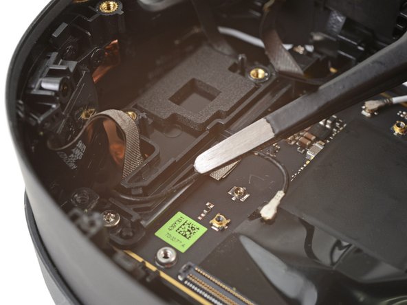

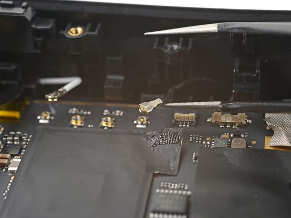

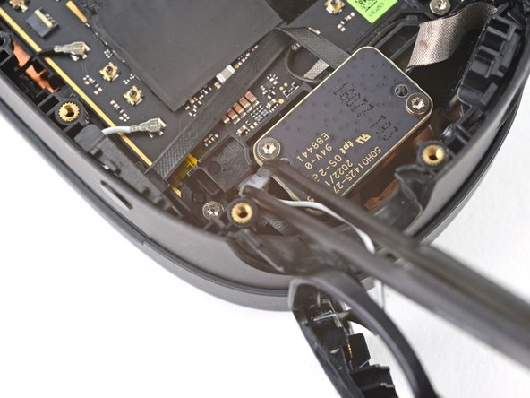

  75. HTC Vive XR Elite Depth Sensor Replacement, Disconnect the antennas: crwdns2935265:075crwdnd2935265:01crwdnd2935265:03crwdne2935265:0 HTC Vive XR Elite Depth Sensor Replacement, Disconnect the antennas: crwdns2935265:075crwdnd2935265:02crwdnd2935265:03crwdne2935265:0 HTC Vive XR Elite Depth Sensor Replacement, Disconnect the antennas: crwdns2935265:075crwdnd2935265:03crwdnd2935265:03crwdne2935265:0

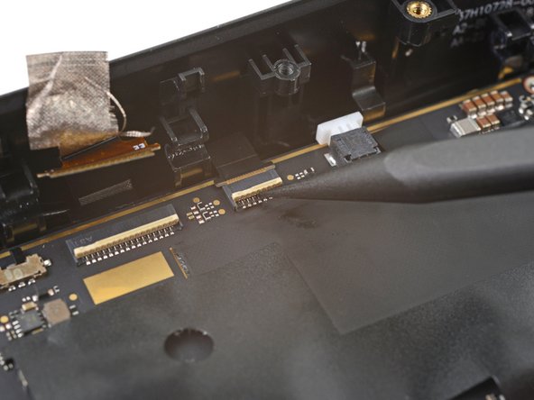

  81. HTC Vive XR Elite Depth Sensor Replacement, Disconnect the microphone: crwdns2935265:081crwdnd2935265:01crwdnd2935265:02crwdne2935265:0 HTC Vive XR Elite Depth Sensor Replacement, Disconnect the microphone: crwdns2935265:081crwdnd2935265:02crwdnd2935265:02crwdne2935265:0
    • Use the point of a spudger to lift up the locking flap on the microphone ZIF connector.
  82. HTC Vive XR Elite Depth Sensor Replacement: crwdns2935265:082crwdnd2935265:01crwdnd2935265:02crwdne2935265:0 HTC Vive XR Elite Depth Sensor Replacement: crwdns2935265:082crwdnd2935265:02crwdnd2935265:02crwdne2935265:0
    • Use tweezers to pull the microphone cable connector out of its slot in the motherboard.

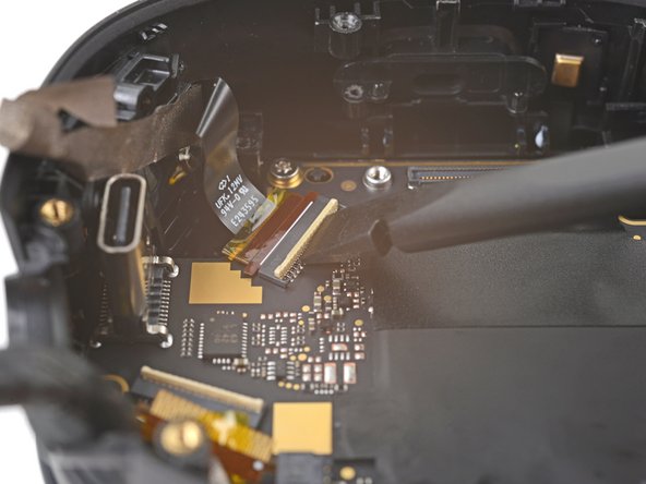

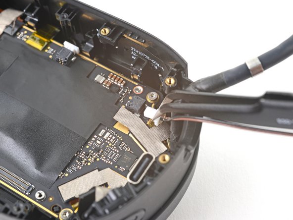

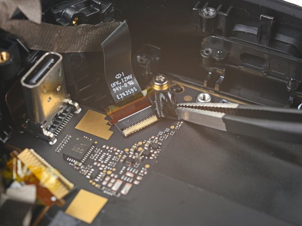

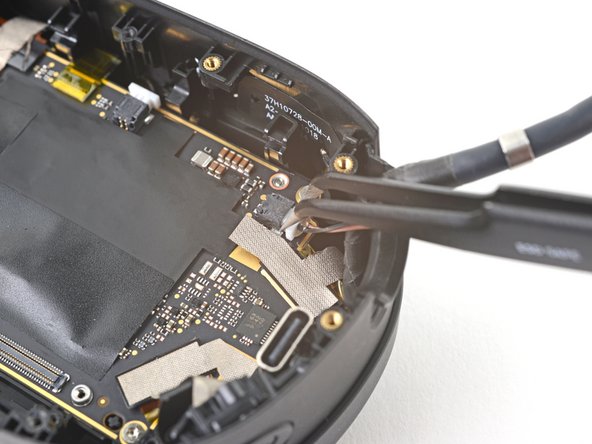

  83. HTC Vive XR Elite Depth Sensor Replacement, Disconnect the depth sensor: crwdns2935265:083crwdnd2935265:01crwdnd2935265:02crwdne2935265:0 HTC Vive XR Elite Depth Sensor Replacement, Disconnect the depth sensor: crwdns2935265:083crwdnd2935265:02crwdnd2935265:02crwdne2935265:0
    • Use tweezers to pull the depth sensor cable connector out of its slot in the motherboard.

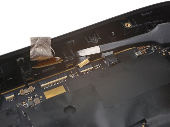

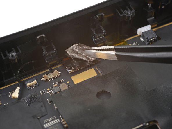

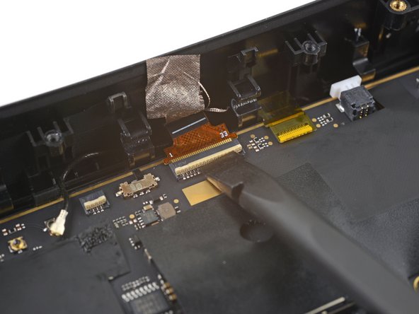

  84. HTC Vive XR Elite Depth Sensor Replacement, Peel the tape: crwdns2935265:084crwdnd2935265:01crwdnd2935265:02crwdne2935265:0 HTC Vive XR Elite Depth Sensor Replacement, Peel the tape: crwdns2935265:084crwdnd2935265:02crwdnd2935265:02crwdne2935265:0
    • Use tweezers to peel back the gray conductive tape covering the right tracking camera ZIF connector.

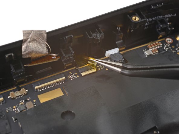

  85. HTC Vive XR Elite Depth Sensor Replacement: crwdns2935265:085crwdnd2935265:01crwdnd2935265:02crwdne2935265:0 HTC Vive XR Elite Depth Sensor Replacement: crwdns2935265:085crwdnd2935265:02crwdnd2935265:02crwdne2935265:0
    • Use tweezers to peel off the black tape covering the right tracking camera ZIF connector.

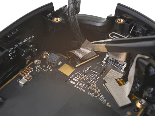

  88. HTC Vive XR Elite Depth Sensor Replacement, Peel the tape: crwdns2935265:088crwdnd2935265:01crwdnd2935265:02crwdne2935265:0 HTC Vive XR Elite Depth Sensor Replacement, Peel the tape: crwdns2935265:088crwdnd2935265:02crwdnd2935265:02crwdne2935265:0
    • Use tweezers to peel back the gray conductive tape covering the right side‑camera ZIF connector.
  89. HTC Vive XR Elite Depth Sensor Replacement: crwdns2935265:089crwdnd2935265:01crwdnd2935265:02crwdne2935265:0 HTC Vive XR Elite Depth Sensor Replacement: crwdns2935265:089crwdnd2935265:02crwdnd2935265:02crwdne2935265:0
    • Use tweezers to peel off the black tape covering the right side‑camera ZIF connector.

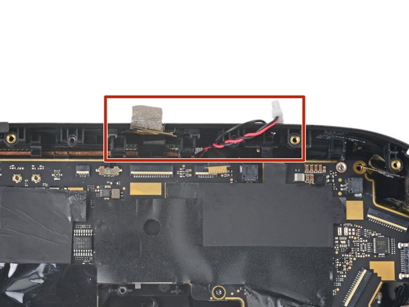

  93. HTC Vive XR Elite Depth Sensor Replacement, Tape the cables: crwdns2935265:093crwdnd2935265:01crwdnd2935265:02crwdne2935265:0 HTC Vive XR Elite Depth Sensor Replacement, Tape the cables: crwdns2935265:093crwdnd2935265:02crwdnd2935265:02crwdne2935265:0
    • Use tape with light adhesive, such as painter's tape, to keep the left and right side cables away from the motherboard.
    • The cables near the top edge need slack for the motherboard to rest properly in the frame. Avoid taping them tightly—or avoid taping them altogether.

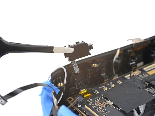

  94. HTC Vive XR Elite Depth Sensor Replacement, Disconnect the power button: crwdns2935265:094crwdnd2935265:01crwdnd2935265:02crwdne2935265:0 HTC Vive XR Elite Depth Sensor Replacement, Disconnect the power button: crwdns2935265:094crwdnd2935265:02crwdnd2935265:02crwdne2935265:0
    • Lift the power button out of its slot in the frame.
    • Don't remove the button completely, as it's still attached by a cable.
  95. HTC Vive XR Elite Depth Sensor Replacement, Remove the IPD slider: crwdns2935265:095crwdnd2935265:01crwdnd2935265:02crwdne2935265:0 HTC Vive XR Elite Depth Sensor Replacement, Remove the IPD slider: crwdns2935265:095crwdnd2935265:02crwdnd2935265:02crwdne2935265:0
    • Press down the bottom right corner of the motherboard so its edge rests under the IPD slider.
  96. HTC Vive XR Elite Depth Sensor Replacement: crwdns2935265:096crwdnd2935265:01crwdnd2935265:03crwdne2935265:0 HTC Vive XR Elite Depth Sensor Replacement: crwdns2935265:096crwdnd2935265:02crwdnd2935265:03crwdne2935265:0 HTC Vive XR Elite Depth Sensor Replacement: crwdns2935265:096crwdnd2935265:03crwdnd2935265:03crwdne2935265:0
    • While pressing down on the motherboard, push the IPD slider out of its slot in the frame.
    • Remove the IPD slider.

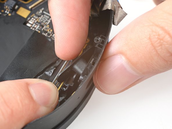

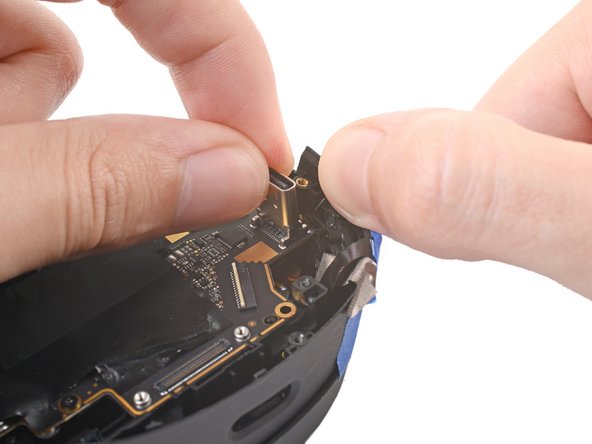

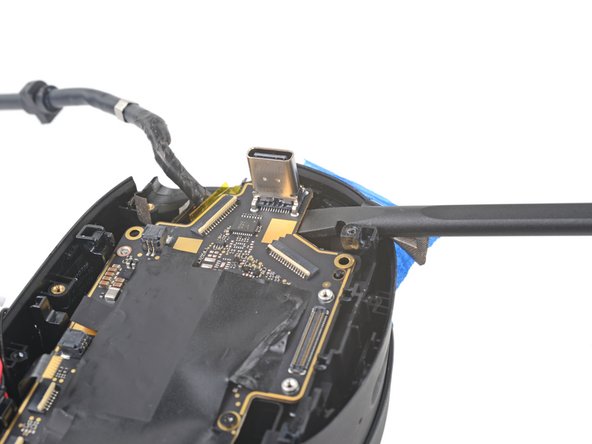

  97. HTC Vive XR Elite Depth Sensor Replacement, Remove the motherboard assembly: crwdns2935265:097crwdnd2935265:01crwdnd2935265:03crwdne2935265:0 HTC Vive XR Elite Depth Sensor Replacement, Remove the motherboard assembly: crwdns2935265:097crwdnd2935265:02crwdnd2935265:03crwdne2935265:0 HTC Vive XR Elite Depth Sensor Replacement, Remove the motherboard assembly: crwdns2935265:097crwdnd2935265:03crwdnd2935265:03crwdne2935265:0
    • Grip the USB-C port with one hand and the right side of the frame with the other.
    • Pull the frame outward while lifting the motherboard assembly until it clears its slot next to the right side‑camera.
    • Use a spudger to pry up the motherboard assembly until its right side completely clears the frame.

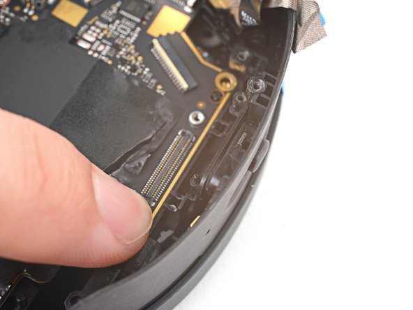

  98. HTC Vive XR Elite Depth Sensor Replacement: crwdns2935265:098crwdnd2935265:01crwdnd2935265:03crwdne2935265:0 HTC Vive XR Elite Depth Sensor Replacement: crwdns2935265:098crwdnd2935265:02crwdnd2935265:03crwdne2935265:0 HTC Vive XR Elite Depth Sensor Replacement: crwdns2935265:098crwdnd2935265:03crwdnd2935265:03crwdne2935265:0
    • Pull the right side of the motherboard assembly toward the bottom edge of the device to separate it from the frame.
    • Remove the motherboard assembly.
    • During reassembly, make sure the cables stay above the motherboard assembly as you reinstall it.

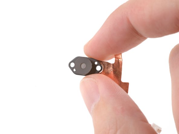

  99. HTC Vive XR Elite Depth Sensor Replacement, Unfasten the depth sensor: crwdns2935265:099crwdnd2935265:01crwdnd2935265:01crwdne2935265:0
    • Use a T5 Torx screwdriver to remove the two 3.5 mm‑long screws securing the depth sensor.
  100. HTC Vive XR Elite Depth Sensor Replacement, Remove the depth sensor: crwdns2935265:0100crwdnd2935265:01crwdnd2935265:03crwdne2935265:0 HTC Vive XR Elite Depth Sensor Replacement, Remove the depth sensor: crwdns2935265:0100crwdnd2935265:02crwdnd2935265:03crwdne2935265:0 HTC Vive XR Elite Depth Sensor Replacement, Remove the depth sensor: crwdns2935265:0100crwdnd2935265:03crwdnd2935265:03crwdne2935265:0
