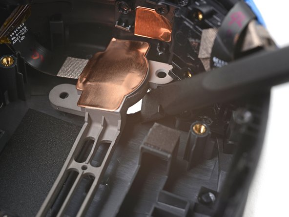

  36. HTC Vive XR Elite Camera Array Replacement, Remove the brackets: crwdns2935265:036crwdnd2935265:01crwdnd2935265:03crwdne2935265:0 HTC Vive XR Elite Camera Array Replacement, Remove the brackets: crwdns2935265:036crwdnd2935265:02crwdnd2935265:03crwdne2935265:0 HTC Vive XR Elite Camera Array Replacement, Remove the brackets: crwdns2935265:036crwdnd2935265:03crwdnd2935265:03crwdne2935265:0
    • The screw brackets are secured with clips and adhesive.
    • Use tweezers to pull the left screw bracket of its post in the frame.
    • This may require some force. Be careful not to scratch any surrounding components.
    • Repeat this process for the right bracket.
    • During reassembly, use tweezers to align the brackets on their posts. Press down with the flat end of a spudger to engage and re-adhere the clips.
  37. HTC Vive XR Elite Camera Array Replacement, Reposition the lens assembly: crwdns2935265:037crwdnd2935265:01crwdnd2935265:02crwdne2935265:0 HTC Vive XR Elite Camera Array Replacement, Reposition the lens assembly: crwdns2935265:037crwdnd2935265:02crwdnd2935265:02crwdne2935265:0
    • Lift the bottom of the lens assembly up to separate the bottom rails from their slots in the frame.
  38. HTC Vive XR Elite Camera Array Replacement: crwdns2935265:038crwdnd2935265:01crwdnd2935265:03crwdne2935265:0 HTC Vive XR Elite Camera Array Replacement: crwdns2935265:038crwdnd2935265:02crwdnd2935265:03crwdne2935265:0 HTC Vive XR Elite Camera Array Replacement: crwdns2935265:038crwdnd2935265:03crwdnd2935265:03crwdne2935265:0
    • Pull the lens assembly upwards to separate the top rails from their slots in the frame.
    • Rotate the lens assembly towards the top of the frame so it sits upright with its cable connectors exposed.

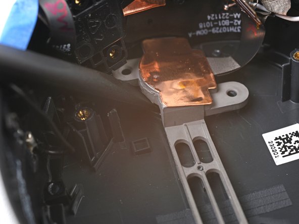

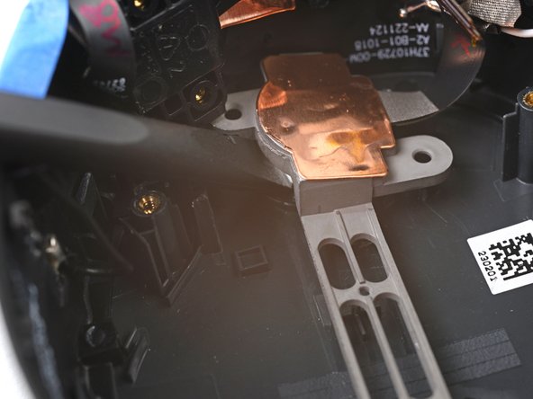

  51. HTC Vive XR Elite Camera Array Replacement, Peel the tape: crwdns2935265:051crwdnd2935265:01crwdnd2935265:03crwdne2935265:0 HTC Vive XR Elite Camera Array Replacement, Peel the tape: crwdns2935265:051crwdnd2935265:02crwdnd2935265:03crwdne2935265:0 HTC Vive XR Elite Camera Array Replacement, Peel the tape: crwdns2935265:051crwdnd2935265:03crwdnd2935265:03crwdne2935265:0
    • Peel off the yellow tape covering the motion sensor cable.
  52. HTC Vive XR Elite Camera Array Replacement, Unfasten the motion sensor: crwdns2935265:052crwdnd2935265:01crwdnd2935265:01crwdne2935265:0
    • Use a T5 Torx screwdriver to remove the two 3.4 mm‑long screws securing the motion sensor.
  53. HTC Vive XR Elite Camera Array Replacement, Reposition the motion sensor: crwdns2935265:053crwdnd2935265:01crwdnd2935265:03crwdne2935265:0 HTC Vive XR Elite Camera Array Replacement, Reposition the motion sensor: crwdns2935265:053crwdnd2935265:02crwdnd2935265:03crwdne2935265:0 HTC Vive XR Elite Camera Array Replacement, Reposition the motion sensor: crwdns2935265:053crwdnd2935265:03crwdnd2935265:03crwdne2935265:0
    • Don't try to fully remove the motion sensor yet, as it's still connected by a cable.
    • Lift the motion sensor off its pegs in the frame.
    • Flip over the motion sensor and lay it on the frame before continuing.

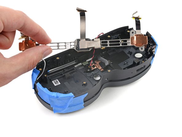

  56. HTC Vive XR Elite Camera Array Replacement, Remove the motion sensor: crwdns2935265:056crwdnd2935265:01crwdnd2935265:02crwdne2935265:0 HTC Vive XR Elite Camera Array Replacement, Remove the motion sensor: crwdns2935265:056crwdnd2935265:02crwdnd2935265:02crwdne2935265:0
    • Use tweezers to pull the motion sensor cable connector out of its slot.
    • Remove the motion sensor.

  65. HTC Vive XR Elite Camera Array Replacement, Unfasten the motion sensor bracket: crwdns2935265:065crwdnd2935265:01crwdnd2935265:01crwdne2935265:0
    • Use a T5 Torx screwdriver to remove the two 4.9 mm‑long screws securing the motion sensor bracket.
  66. HTC Vive XR Elite Camera Array Replacement, Remove the motion sensor bracket: crwdns2935265:066crwdnd2935265:01crwdnd2935265:03crwdne2935265:0 HTC Vive XR Elite Camera Array Replacement, Remove the motion sensor bracket: crwdns2935265:066crwdnd2935265:02crwdnd2935265:03crwdne2935265:0 HTC Vive XR Elite Camera Array Replacement, Remove the motion sensor bracket: crwdns2935265:066crwdnd2935265:03crwdnd2935265:03crwdne2935265:0
    • Lift the motion sensor off its pegs on the motherboard.
    • Remove the motion sensor bracket.

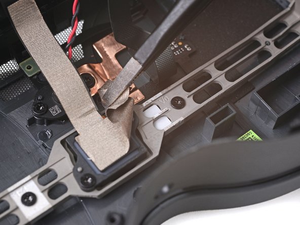

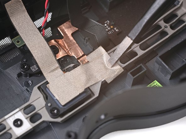

  67. HTC Vive XR Elite Camera Array Replacement, Peel the tape: crwdns2935265:067crwdnd2935265:01crwdnd2935265:02crwdne2935265:0 HTC Vive XR Elite Camera Array Replacement, Peel the tape: crwdns2935265:067crwdnd2935265:02crwdnd2935265:02crwdne2935265:0
    • Use tweezers to peel back the gray conductive tape covering the left side‑camera ZIF connector.

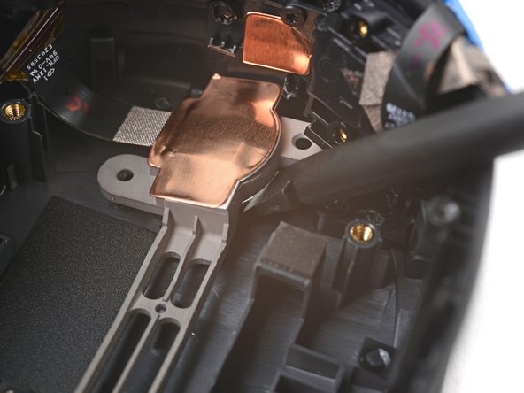

  68. HTC Vive XR Elite Camera Array Replacement: crwdns2935265:068crwdnd2935265:01crwdnd2935265:02crwdne2935265:0 HTC Vive XR Elite Camera Array Replacement: crwdns2935265:068crwdnd2935265:02crwdnd2935265:02crwdne2935265:0
    • Use tweezers to peel off the black tape covering the left side‑camera ZIF connector.
