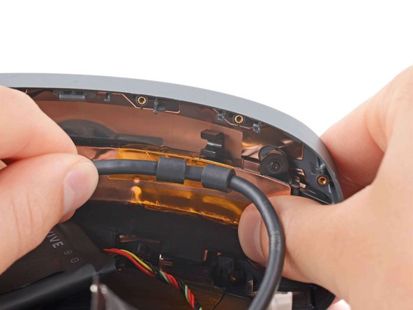

  24. HTC Vive XR Elite Battery Cradle USB-C Cable Replacement, Unclip the USB-C power cable: crwdns2935265:024crwdnd2935265:01crwdnd2935265:02crwdne2935265:0 HTC Vive XR Elite Battery Cradle USB-C Cable Replacement, Unclip the USB-C power cable: crwdns2935265:024crwdnd2935265:02crwdnd2935265:02crwdne2935265:0
    • Slide the USB-C power cable to the left to unclip it.
  25. HTC Vive XR Elite Battery Cradle USB-C Cable Replacement, Remove the front metal battery enclosure: crwdns2935265:025crwdnd2935265:01crwdnd2935265:02crwdne2935265:0 HTC Vive XR Elite Battery Cradle USB-C Cable Replacement, Remove the front metal battery enclosure: crwdns2935265:025crwdnd2935265:02crwdnd2935265:02crwdne2935265:0
    • Remove the front metal battery enclosure.

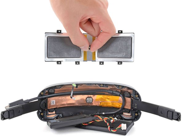

  26. HTC Vive XR Elite Battery Cradle USB-C Cable Replacement, Reposition the battery cradle: crwdns2935265:026crwdnd2935265:01crwdnd2935265:01crwdne2935265:0
    • Stand the battery cradle upright so the battery cells can fold flat on your work surface.
  27. HTC Vive XR Elite Battery Cradle USB-C Cable Replacement, Remove the rear metal battery enclosure: crwdns2935265:027crwdnd2935265:01crwdnd2935265:02crwdne2935265:0 HTC Vive XR Elite Battery Cradle USB-C Cable Replacement, Remove the rear metal battery enclosure: crwdns2935265:027crwdnd2935265:02crwdnd2935265:02crwdne2935265:0
    • Remove the rear metal battery enclosure.

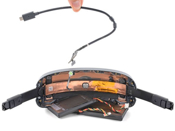

  28. HTC Vive XR Elite Battery Cradle USB-C Cable Replacement, Unclip the USB-C power cable: crwdns2935265:028crwdnd2935265:01crwdnd2935265:03crwdne2935265:0 HTC Vive XR Elite Battery Cradle USB-C Cable Replacement, Unclip the USB-C power cable: crwdns2935265:028crwdnd2935265:02crwdnd2935265:03crwdne2935265:0 HTC Vive XR Elite Battery Cradle USB-C Cable Replacement, Unclip the USB-C power cable: crwdns2935265:028crwdnd2935265:03crwdnd2935265:03crwdne2935265:0
    • Pull the USB-C power cable straight out of its slot to unclip it.
    • Remove the USB-C power cable.
