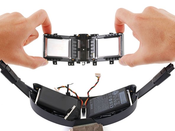

  10. HTC Vive XR Elite Battery Cradle Power LED Replacement, Separate the battery cradle halves: crwdns2935265:010crwdnd2935265:01crwdnd2935265:02crwdne2935265:0 HTC Vive XR Elite Battery Cradle Power LED Replacement, Separate the battery cradle halves: crwdns2935265:010crwdnd2935265:02crwdnd2935265:02crwdne2935265:0
    • Pull apart the two halves of the battery cradle to completely separate them.

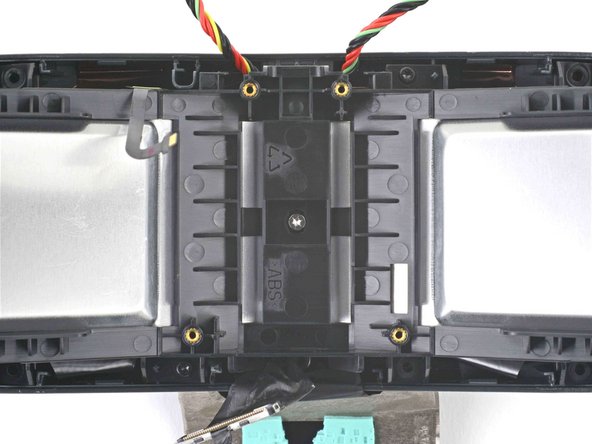

  12. HTC Vive XR Elite Battery Cradle Power LED Replacement, Unfasten the inner plastic frame: crwdns2935265:012crwdnd2935265:01crwdnd2935265:02crwdne2935265:0 HTC Vive XR Elite Battery Cradle Power LED Replacement, Unfasten the inner plastic frame: crwdns2935265:012crwdnd2935265:02crwdnd2935265:02crwdne2935265:0
    FixMat
    $36.95
    • Use a T5 Torx screwdriver to remove the nine screws securing the inner plastic frame:
    • Five 11.8 mm-long screws
    • Three 5.6 mm-long screws
    • One 5.6 mm-long screw
    • This screw is covered by a piece of black plastic tape. Use tweezers to remove it before unscrewing.
  13. HTC Vive XR Elite Battery Cradle Power LED Replacement, Remove the inner plastic frame: crwdns2935265:013crwdnd2935265:01crwdnd2935265:02crwdne2935265:0 HTC Vive XR Elite Battery Cradle Power LED Replacement, Remove the inner plastic frame: crwdns2935265:013crwdnd2935265:02crwdnd2935265:02crwdne2935265:0
    • Remove the inner plastic frame, making sure to thread the graphite thermal tape through it.

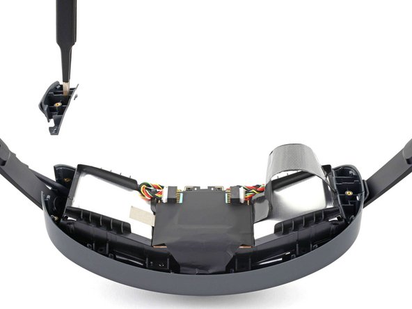

    • Use a T5 Torx screwdriver to remove the two 5.6 mm-long screws securing the headstrap clips.
  15. HTC Vive XR Elite Battery Cradle Power LED Replacement, Remove the headstrap clips: crwdns2935265:015crwdnd2935265:01crwdnd2935265:03crwdne2935265:0 HTC Vive XR Elite Battery Cradle Power LED Replacement, Remove the headstrap clips: crwdns2935265:015crwdnd2935265:02crwdnd2935265:03crwdne2935265:0 HTC Vive XR Elite Battery Cradle Power LED Replacement, Remove the headstrap clips: crwdns2935265:015crwdnd2935265:03crwdnd2935265:03crwdne2935265:0
    • Use tweezers to remove the left and right headstrap clips.

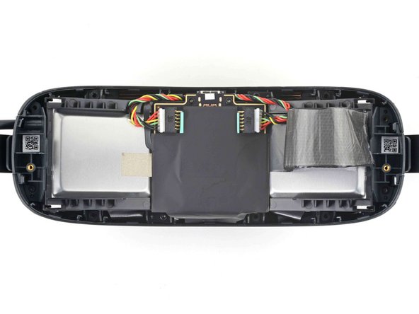

  16. HTC Vive XR Elite Battery Cradle Power LED Replacement, Peel back the battery board thermal pad: crwdns2935265:016crwdnd2935265:01crwdnd2935265:03crwdne2935265:0 HTC Vive XR Elite Battery Cradle Power LED Replacement, Peel back the battery board thermal pad: crwdns2935265:016crwdnd2935265:02crwdnd2935265:03crwdne2935265:0 HTC Vive XR Elite Battery Cradle Power LED Replacement, Peel back the battery board thermal pad: crwdns2935265:016crwdnd2935265:03crwdnd2935265:03crwdne2935265:0
    • Use tweezers or your fingers to peel back the thermal pad covering the battery board.
    • Work slowly to avoid tearing the thermal pad.

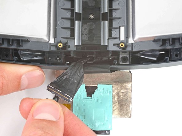

  18. HTC Vive XR Elite Battery Cradle Power LED Replacement, Disconnect the power LED: crwdns2935265:018crwdnd2935265:01crwdnd2935265:03crwdne2935265:0 HTC Vive XR Elite Battery Cradle Power LED Replacement, Disconnect the power LED: crwdns2935265:018crwdnd2935265:02crwdnd2935265:03crwdne2935265:0 HTC Vive XR Elite Battery Cradle Power LED Replacement, Disconnect the power LED: crwdns2935265:018crwdnd2935265:03crwdnd2935265:03crwdne2935265:0
    • Use the point of a spudger to flip up the locking flap on the power LED ZIF connector.
    • Use tweezers or your fingers to disconnect the power LED cable.
    • During reassembly, slide the cable into the connector and close the locking flap. If the cable is getting stuck, gently remove it and realign it before trying again.

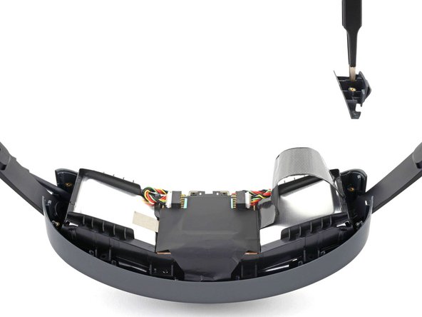

  20. HTC Vive XR Elite Battery Cradle Power LED Replacement, Peel back the conductive tape: crwdns2935265:020crwdnd2935265:01crwdnd2935265:02crwdne2935265:0 HTC Vive XR Elite Battery Cradle Power LED Replacement, Peel back the conductive tape: crwdns2935265:020crwdnd2935265:02crwdnd2935265:02crwdne2935265:0
    • Use tweezers or your fingers to peel the conductive tape away from the front metal battery enclosure.

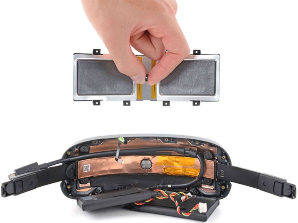

  25. HTC Vive XR Elite Battery Cradle Power LED Replacement, Remove the front metal battery enclosure: crwdns2935265:025crwdnd2935265:01crwdnd2935265:02crwdne2935265:0 HTC Vive XR Elite Battery Cradle Power LED Replacement, Remove the front metal battery enclosure: crwdns2935265:025crwdnd2935265:02crwdnd2935265:02crwdne2935265:0
    • Remove the front metal battery enclosure.
  26. HTC Vive XR Elite Battery Cradle Power LED Replacement, Reposition the battery cradle: crwdns2935265:026crwdnd2935265:01crwdnd2935265:01crwdne2935265:0
    • Stand the battery cradle upright so the battery cells can fold flat on your work surface.
  27. HTC Vive XR Elite Battery Cradle Power LED Replacement, Remove the rear metal battery enclosure: crwdns2935265:027crwdnd2935265:01crwdnd2935265:02crwdne2935265:0 HTC Vive XR Elite Battery Cradle Power LED Replacement, Remove the rear metal battery enclosure: crwdns2935265:027crwdnd2935265:02crwdnd2935265:02crwdne2935265:0
    • Remove the rear metal battery enclosure.

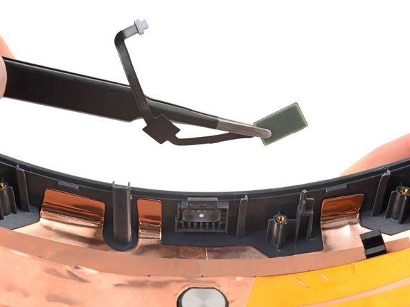

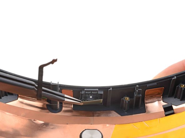

  28. HTC Vive XR Elite Battery Cradle Power LED Replacement, Remove the power LED: crwdns2935265:028crwdnd2935265:01crwdnd2935265:03crwdne2935265:0 HTC Vive XR Elite Battery Cradle Power LED Replacement, Remove the power LED: crwdns2935265:028crwdnd2935265:02crwdnd2935265:03crwdne2935265:0 HTC Vive XR Elite Battery Cradle Power LED Replacement, Remove the power LED: crwdns2935265:028crwdnd2935265:03crwdnd2935265:03crwdne2935265:0
    • Use tweezers to pull out and remove the power LED.
