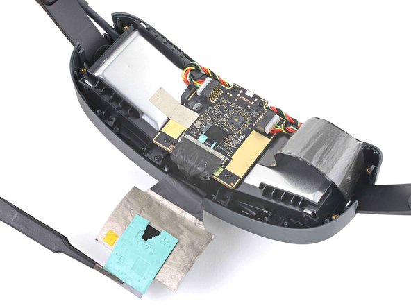

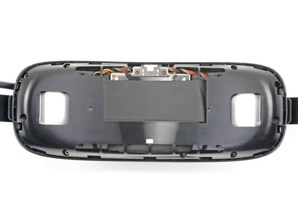

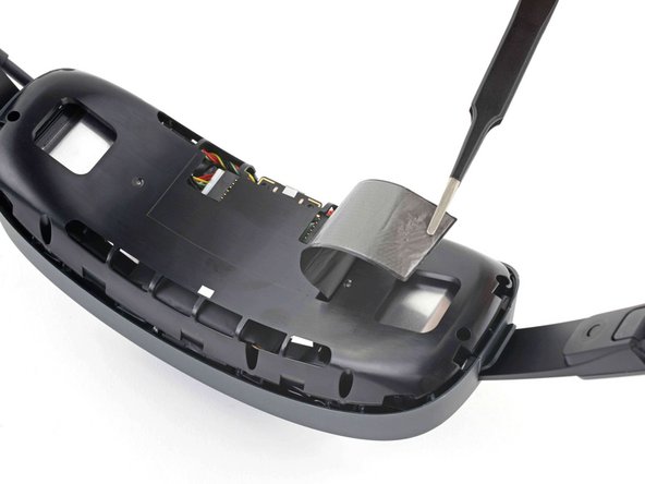

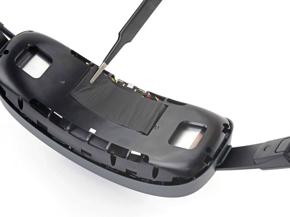

  11. HTC Vive XR Elite Battery Cradle Board Replacement, Peel back the graphite thermal tape: crwdns2935265:011crwdnd2935265:01crwdnd2935265:03crwdne2935265:0 HTC Vive XR Elite Battery Cradle Board Replacement, Peel back the graphite thermal tape: crwdns2935265:011crwdnd2935265:02crwdnd2935265:03crwdne2935265:0 HTC Vive XR Elite Battery Cradle Board Replacement, Peel back the graphite thermal tape: crwdns2935265:011crwdnd2935265:03crwdnd2935265:03crwdne2935265:0
    • Use tweezers to peel back the graphite thermal tape covering the inner plastic frame.
    • If the tape tears a little, don't worry! During reassembly, stick it back in its original place as if it were still one piece

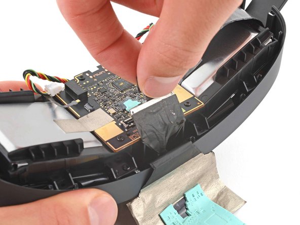

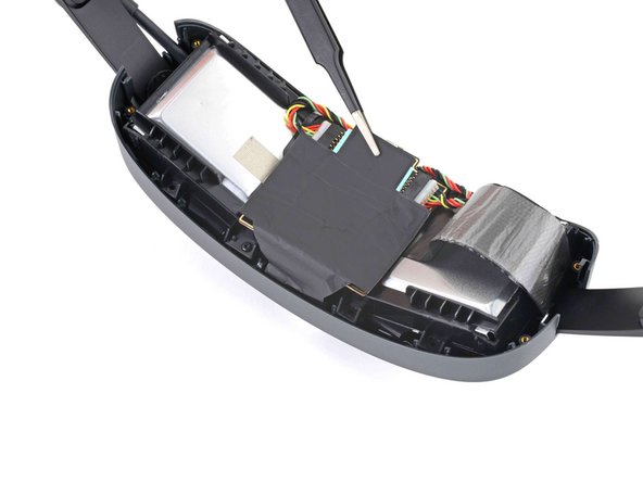

  14. HTC Vive XR Elite Battery Cradle Board Replacement, Peel back the battery board thermal pad: crwdns2935265:014crwdnd2935265:01crwdnd2935265:03crwdne2935265:0 HTC Vive XR Elite Battery Cradle Board Replacement, Peel back the battery board thermal pad: crwdns2935265:014crwdnd2935265:02crwdnd2935265:03crwdne2935265:0 HTC Vive XR Elite Battery Cradle Board Replacement, Peel back the battery board thermal pad: crwdns2935265:014crwdnd2935265:03crwdnd2935265:03crwdne2935265:0
    • Use tweezers or your fingers to peel back the thermal pad covering the battery board.
    • Work slowly to avoid tearing the thermal pad.

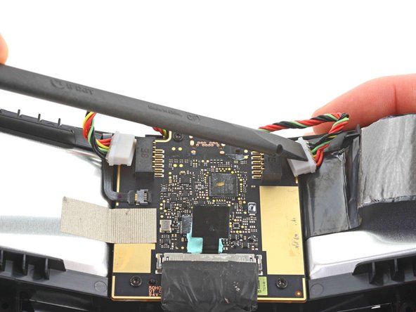

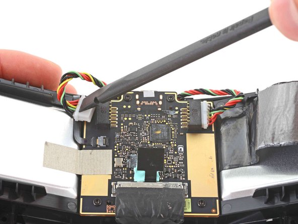

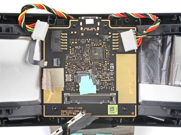

  15. HTC Vive XR Elite Battery Cradle Board Replacement, Disconnect the batteries: crwdns2935265:015crwdnd2935265:01crwdnd2935265:03crwdne2935265:0 HTC Vive XR Elite Battery Cradle Board Replacement, Disconnect the batteries: crwdns2935265:015crwdnd2935265:02crwdnd2935265:03crwdne2935265:0 HTC Vive XR Elite Battery Cradle Board Replacement, Disconnect the batteries: crwdns2935265:015crwdnd2935265:03crwdnd2935265:03crwdne2935265:0
    • Use the flat end of a spudger to push the left and right battery cell connectors out of their respective sockets.

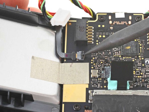

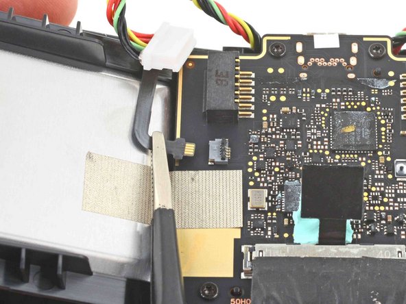

  16. HTC Vive XR Elite Battery Cradle Board Replacement, Disconnect the power LED: crwdns2935265:016crwdnd2935265:01crwdnd2935265:03crwdne2935265:0 HTC Vive XR Elite Battery Cradle Board Replacement, Disconnect the power LED: crwdns2935265:016crwdnd2935265:02crwdnd2935265:03crwdne2935265:0 HTC Vive XR Elite Battery Cradle Board Replacement, Disconnect the power LED: crwdns2935265:016crwdnd2935265:03crwdnd2935265:03crwdne2935265:0
    • Use the point of a spudger to flip up the locking flap on the power LED ZIF connector.
    • Use tweezers or your fingers to disconnect the power LED cable.
    • During reassembly, slide the cable into the connector and close the locking flap. If the cable is getting stuck, gently remove it and realign it before trying again.
  17. HTC Vive XR Elite Battery Cradle Board Replacement, Disconnect the USB-C power cable: crwdns2935265:017crwdnd2935265:01crwdnd2935265:02crwdne2935265:0 HTC Vive XR Elite Battery Cradle Board Replacement, Disconnect the USB-C power cable: crwdns2935265:017crwdnd2935265:02crwdnd2935265:02crwdne2935265:0
    • Pull the black tab straight up on the USB-C power cable to disconnect it.
    • During reassembly, align the cable directly over the connector and press straight down to reconnect it.

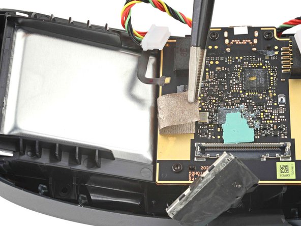

  18. HTC Vive XR Elite Battery Cradle Board Replacement, Peel back the conductive tape: crwdns2935265:018crwdnd2935265:01crwdnd2935265:02crwdne2935265:0 HTC Vive XR Elite Battery Cradle Board Replacement, Peel back the conductive tape: crwdns2935265:018crwdnd2935265:02crwdnd2935265:02crwdne2935265:0
    • Use tweezers or your fingers to peel the conductive tape away from the front metal battery enclosure.

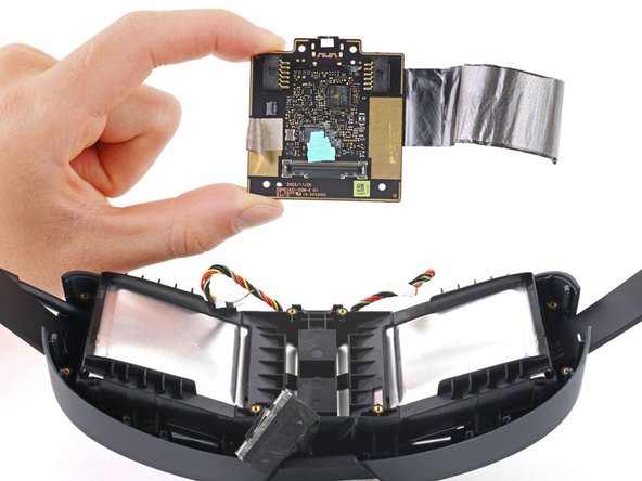

  19. HTC Vive XR Elite Battery Cradle Board Replacement, Unfasten the battery board: crwdns2935265:019crwdnd2935265:01crwdnd2935265:02crwdne2935265:0 HTC Vive XR Elite Battery Cradle Board Replacement, Unfasten the battery board: crwdns2935265:019crwdnd2935265:02crwdnd2935265:02crwdne2935265:0
    • Use a T5 Torx screwdriver to remove the four 4.1 mm-long screws securing the battery board.
  20. HTC Vive XR Elite Battery Cradle Board Replacement, Remove the battery board: crwdns2935265:020crwdnd2935265:01crwdnd2935265:02crwdne2935265:0 HTC Vive XR Elite Battery Cradle Board Replacement, Remove the battery board: crwdns2935265:020crwdnd2935265:02crwdnd2935265:02crwdne2935265:0
    • Remove the battery board.
