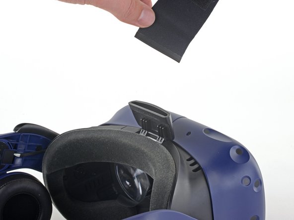

    1. HTC Vive Pro 2 Sensor Array Replacement, Remove the top strap: crwdns2935265:04crwdnd2935265:01crwdnd2935265:02crwdne2935265:0 HTC Vive Pro 2 Sensor Array Replacement, Remove the top strap: crwdns2935265:04crwdnd2935265:02crwdnd2935265:02crwdne2935265:0
      • Separate the top strap from itself where the Velcro secures it.
    2. HTC Vive Pro 2 Sensor Array Replacement: crwdns2935265:05crwdnd2935265:01crwdnd2935265:03crwdne2935265:0 HTC Vive Pro 2 Sensor Array Replacement: crwdns2935265:05crwdnd2935265:02crwdnd2935265:03crwdne2935265:0 HTC Vive Pro 2 Sensor Array Replacement: crwdns2935265:05crwdnd2935265:03crwdnd2935265:03crwdne2935265:0
      • Peel back the Velcro securing the rear of the top strap.
      • Feed the top strap out through the head strap to partially remove it.
    3. HTC Vive Pro 2 Sensor Array Replacement: crwdns2935265:06crwdnd2935265:01crwdnd2935265:03crwdne2935265:0 HTC Vive Pro 2 Sensor Array Replacement: crwdns2935265:06crwdnd2935265:02crwdnd2935265:03crwdne2935265:0 HTC Vive Pro 2 Sensor Array Replacement: crwdns2935265:06crwdnd2935265:03crwdnd2935265:03crwdne2935265:0
      • Feed the top strap through the clip near the front of headset to fully remove it.

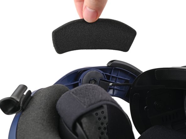

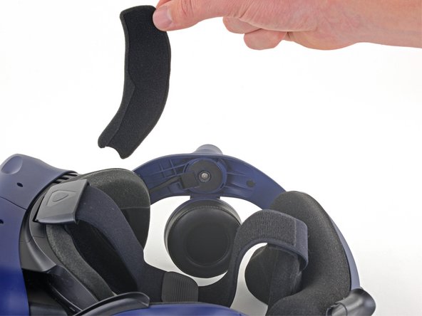

    1. HTC Vive Pro 2 Sensor Array Replacement, Remove the front side foam pads: crwdns2935265:07crwdnd2935265:01crwdnd2935265:03crwdne2935265:0 HTC Vive Pro 2 Sensor Array Replacement, Remove the front side foam pads: crwdns2935265:07crwdnd2935265:02crwdnd2935265:03crwdne2935265:0 HTC Vive Pro 2 Sensor Array Replacement, Remove the front side foam pads: crwdns2935265:07crwdnd2935265:03crwdnd2935265:03crwdne2935265:0
      • Peel off both front side foam pads to uncover the speaker wires.

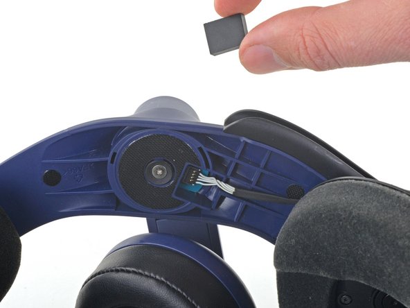

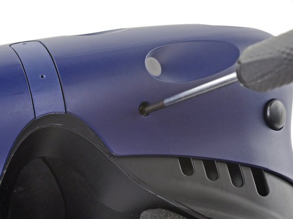

    2. HTC Vive Pro 2 Sensor Array Replacement, Remove the two rubber spacers: crwdns2935265:08crwdnd2935265:01crwdnd2935265:03crwdne2935265:0 HTC Vive Pro 2 Sensor Array Replacement, Remove the two rubber spacers: crwdns2935265:08crwdnd2935265:02crwdnd2935265:03crwdne2935265:0 HTC Vive Pro 2 Sensor Array Replacement, Remove the two rubber spacers: crwdns2935265:08crwdnd2935265:03crwdnd2935265:03crwdne2935265:0
      • Use the point of your spudger to pry out the two rubber spacers next to the headphone screws.
      • Be careful not to accidentally pry any of the speaker wires under the rubber spacer.

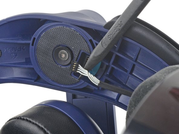

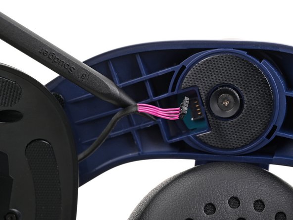

    3. HTC Vive Pro 2 Sensor Array Replacement, Disconnect the speaker wires: crwdns2935265:09crwdnd2935265:01crwdnd2935265:03crwdne2935265:0 HTC Vive Pro 2 Sensor Array Replacement, Disconnect the speaker wires: crwdns2935265:09crwdnd2935265:02crwdnd2935265:03crwdne2935265:0 HTC Vive Pro 2 Sensor Array Replacement, Disconnect the speaker wires: crwdns2935265:09crwdnd2935265:03crwdnd2935265:03crwdne2935265:0
      • Use the point of your spudger to pry up and disconnect both the left and right headphone speaker wires.

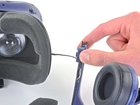

    4. HTC Vive Pro 2 Sensor Array Replacement, Remove the head strap: crwdns2935265:010crwdnd2935265:01crwdnd2935265:02crwdne2935265:0 HTC Vive Pro 2 Sensor Array Replacement, Remove the head strap: crwdns2935265:010crwdnd2935265:02crwdnd2935265:02crwdne2935265:0
      • Use a T6 Torx screwdriver to remove the two 12.1 mm screws (one on each side) securing the head strap to the headset.
      • Use a T5 Torx screwdriver to remove the following screws securing the head strap to the headset:
      • Four 3.9 mm screws (two on each side)
      • Two 4.1 mm screws (one on each side)

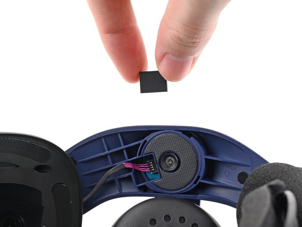

    5. HTC Vive Pro 2 Sensor Array Replacement: crwdns2935265:011crwdnd2935265:01crwdnd2935265:01crwdne2935265:0
      • Remove the two plastic spacers underneath the previously removed Torx T6 screw.

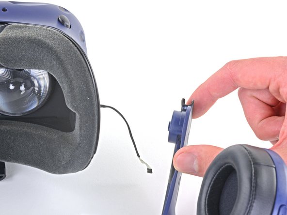

    6. HTC Vive Pro 2 Sensor Array Replacement: crwdns2935265:012crwdnd2935265:01crwdnd2935265:03crwdne2935265:0 HTC Vive Pro 2 Sensor Array Replacement: crwdns2935265:012crwdnd2935265:02crwdnd2935265:03crwdne2935265:0 HTC Vive Pro 2 Sensor Array Replacement: crwdns2935265:012crwdnd2935265:03crwdnd2935265:03crwdne2935265:0
      • Thread the headphone speaker wires out through both ends of the head strap.

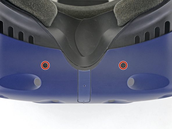

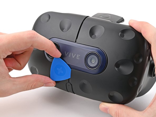

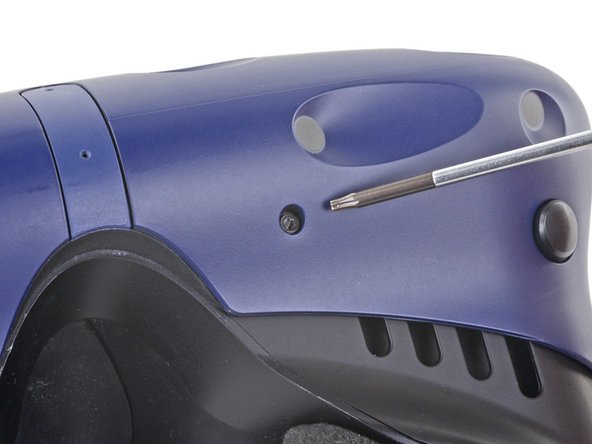

    1. HTC Vive Pro 2 Sensor Array Replacement, Remove the outer shell: crwdns2935265:013crwdnd2935265:01crwdnd2935265:03crwdne2935265:0 HTC Vive Pro 2 Sensor Array Replacement, Remove the outer shell: crwdns2935265:013crwdnd2935265:02crwdnd2935265:03crwdne2935265:0 HTC Vive Pro 2 Sensor Array Replacement, Remove the outer shell: crwdns2935265:013crwdnd2935265:03crwdnd2935265:03crwdne2935265:0
      • The four screws securing the outer shell are covered with black stickers. If the stickers are difficult to remove, simply press your T6 Torx driver through them.
    2. HTC Vive Pro 2 Sensor Array Replacement: crwdns2935265:014crwdnd2935265:01crwdnd2935265:02crwdne2935265:0 HTC Vive Pro 2 Sensor Array Replacement: crwdns2935265:014crwdnd2935265:02crwdnd2935265:02crwdne2935265:0
      • Use a T6 Torx screwdriver to remove the four 3.9 mm screws (two on top, two on bottom) securing the outer shell to the headset.
    3. HTC Vive Pro 2 Sensor Array Replacement: crwdns2935265:015crwdnd2935265:01crwdnd2935265:03crwdne2935265:0 HTC Vive Pro 2 Sensor Array Replacement: crwdns2935265:015crwdnd2935265:02crwdnd2935265:03crwdne2935265:0 HTC Vive Pro 2 Sensor Array Replacement: crwdns2935265:015crwdnd2935265:03crwdnd2935265:03crwdne2935265:0

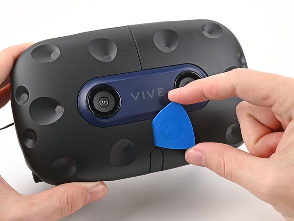

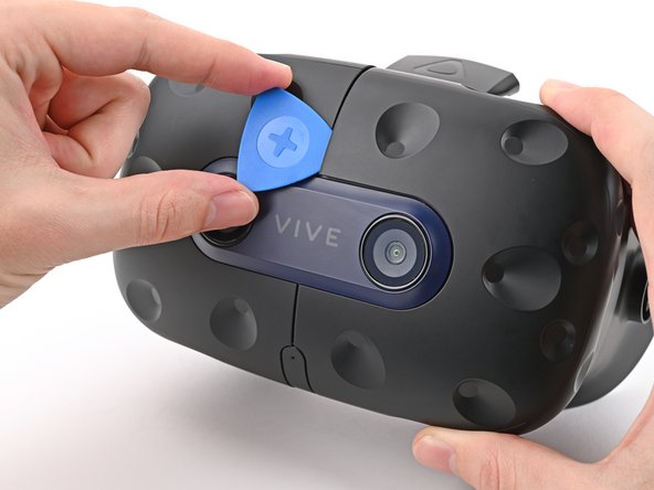

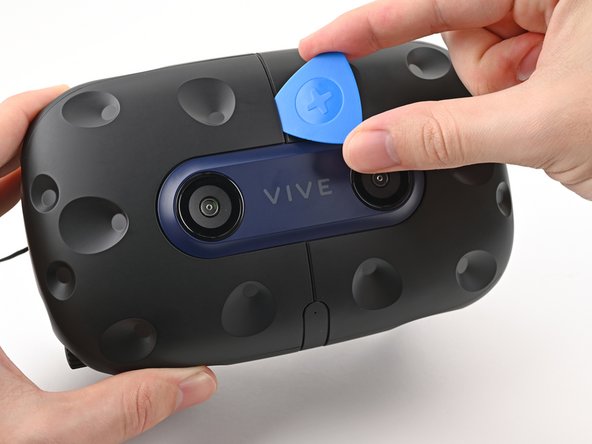

      • Insert an opening pick into the seam between the two halves of the outer shell.
      • Slide the opening pick through the seam to dislodge the clips securing it to the headset.
      • Only insert the opening pick as far as necessary. There are ribbon cables underneath the outer shell.
    4. HTC Vive Pro 2 Sensor Array Replacement: crwdns2935265:016crwdnd2935265:01crwdnd2935265:03crwdne2935265:0 HTC Vive Pro 2 Sensor Array Replacement: crwdns2935265:016crwdnd2935265:02crwdnd2935265:03crwdne2935265:0 HTC Vive Pro 2 Sensor Array Replacement: crwdns2935265:016crwdnd2935265:03crwdnd2935265:03crwdne2935265:0
      • Continue sliding the opening pick through each seam until all clips have been dislodged.

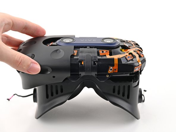

    5. HTC Vive Pro 2 Sensor Array Replacement: crwdns2935265:017crwdnd2935265:01crwdnd2935265:03crwdne2935265:0 HTC Vive Pro 2 Sensor Array Replacement: crwdns2935265:017crwdnd2935265:02crwdnd2935265:03crwdne2935265:0 HTC Vive Pro 2 Sensor Array Replacement: crwdns2935265:017crwdnd2935265:03crwdnd2935265:03crwdne2935265:0
      • Carefully slide each half of the outer shell off of the sensor array.
      • Be careful not to snag any of the ribbon cables underneath.

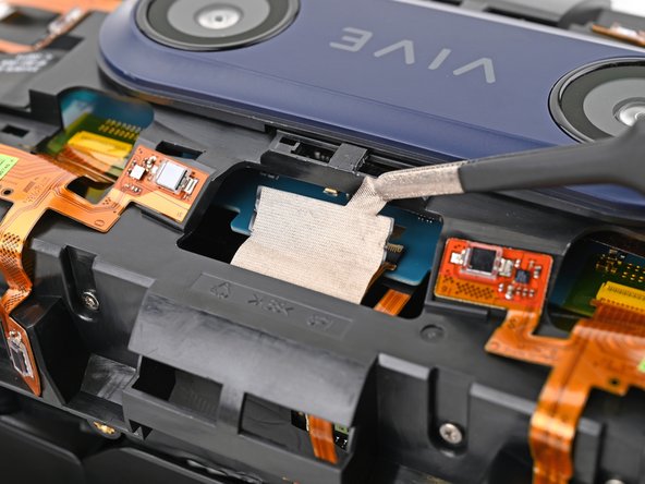

    3. HTC Vive Pro 2 Sensor Array Replacement, Disconnect the sensor array: crwdns2935265:021crwdnd2935265:01crwdnd2935265:02crwdne2935265:0 HTC Vive Pro 2 Sensor Array Replacement, Disconnect the sensor array: crwdns2935265:021crwdnd2935265:02crwdnd2935265:02crwdne2935265:0
      • Use tweezers, or your fingers, to peel the conductive fabric off the sensor array ZIF connector on the motherboard.

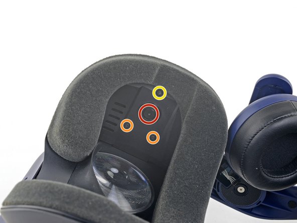

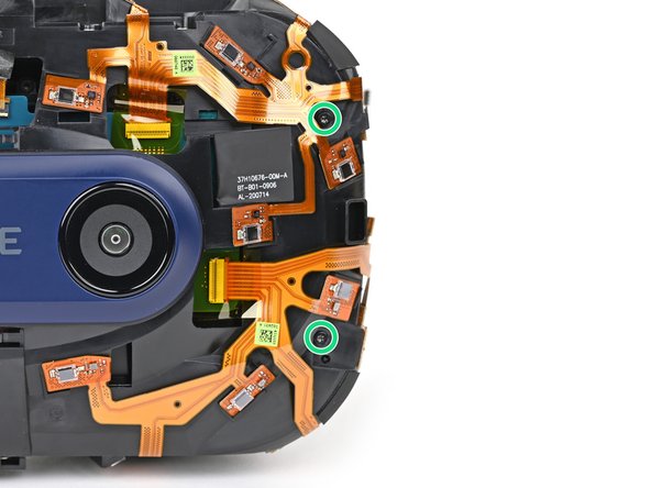

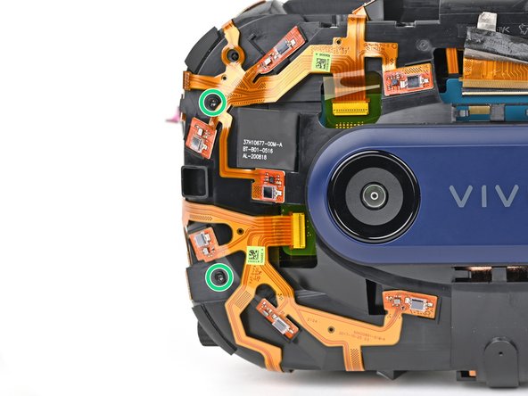

    6. HTC Vive Pro 2 Sensor Array Replacement, Remove the sensor array screws: crwdns2935265:024crwdnd2935265:01crwdnd2935265:02crwdne2935265:0 HTC Vive Pro 2 Sensor Array Replacement, Remove the sensor array screws: crwdns2935265:024crwdnd2935265:02crwdnd2935265:02crwdne2935265:0
      • Use a T5 Torx screwdriver to remove the four 3.0 mm‑long screws securing the top of the sensor array.
    7. HTC Vive Pro 2 Sensor Array Replacement: crwdns2935265:025crwdnd2935265:01crwdnd2935265:03crwdne2935265:0 HTC Vive Pro 2 Sensor Array Replacement: crwdns2935265:025crwdnd2935265:02crwdnd2935265:03crwdne2935265:0 HTC Vive Pro 2 Sensor Array Replacement: crwdns2935265:025crwdnd2935265:03crwdnd2935265:03crwdne2935265:0
      • Use a T6 Torx screwdriver to remove the four 3.8 mm‑long screws securing the front of the sensor array.

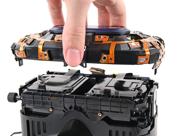

    8. HTC Vive Pro 2 Sensor Array Replacement, Remove the sensor array: crwdns2935265:026crwdnd2935265:01crwdnd2935265:02crwdne2935265:0 HTC Vive Pro 2 Sensor Array Replacement, Remove the sensor array: crwdns2935265:026crwdnd2935265:02crwdnd2935265:02crwdne2935265:0
      • Lift the sensor array straight off the lens assembly and remove it, making sure you thread the cable through its slot.
      • During reassembly, make sure the sensor assembly cable is threaded through its slot before continuing.

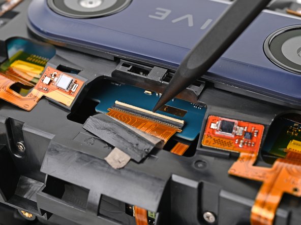

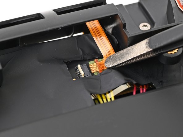

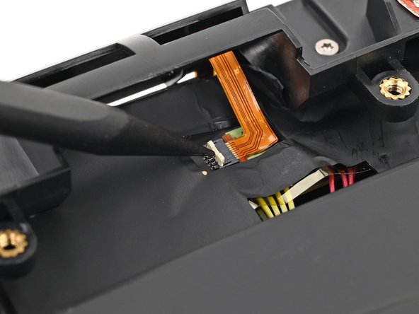

    1. HTC Vive Pro 2 Sensor Array Replacement, Disconnect the motherboard from the sensor array: crwdns2935265:027crwdnd2935265:01crwdnd2935265:03crwdne2935265:0 HTC Vive Pro 2 Sensor Array Replacement, Disconnect the motherboard from the sensor array: crwdns2935265:027crwdnd2935265:02crwdnd2935265:03crwdne2935265:0 HTC Vive Pro 2 Sensor Array Replacement, Disconnect the motherboard from the sensor array: crwdns2935265:027crwdnd2935265:03crwdnd2935265:03crwdne2935265:0
      • Use a pair of tweezers or your fingers to remove the four pieces of Kapton tape covering the ZIF connectors.
    2. HTC Vive Pro 2 Sensor Array Replacement: crwdns2935265:028crwdnd2935265:01crwdnd2935265:03crwdne2935265:0 HTC Vive Pro 2 Sensor Array Replacement: crwdns2935265:028crwdnd2935265:02crwdnd2935265:03crwdne2935265:0 HTC Vive Pro 2 Sensor Array Replacement: crwdns2935265:028crwdnd2935265:03crwdnd2935265:03crwdne2935265:0
      • Use the flat end of your spudger to flip up the locking flap on a ZIF connector on the sensor array.
      • Use the pointed end of your spudger to disconnect the ribbon cable from its ZIF connector.
      • Repeat this procedure for all four of the ZIF connectors.

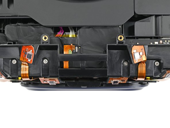

    8. HTC Vive Pro 2 Sensor Array Replacement, Remove the motherboard: crwdns2935265:034crwdnd2935265:01crwdnd2935265:02crwdne2935265:0 HTC Vive Pro 2 Sensor Array Replacement, Remove the motherboard: crwdns2935265:034crwdnd2935265:02crwdnd2935265:02crwdne2935265:0
      • Reposition the long ribbon cable covering the back of the motherboard so it's out of the way.
      • Don't sharply crease or fold the ribbon cable.

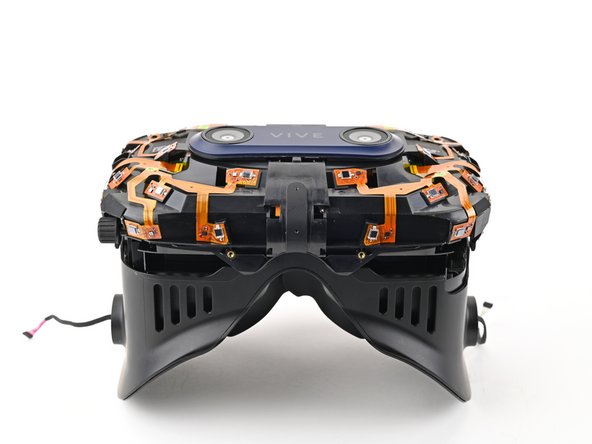

    1. HTC Vive Pro 2 Sensor Array Replacement, Only the sensor array remains: crwdns2935265:038crwdnd2935265:01crwdnd2935265:01crwdne2935265:0
      • Only the sensor array remains.
