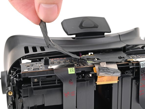

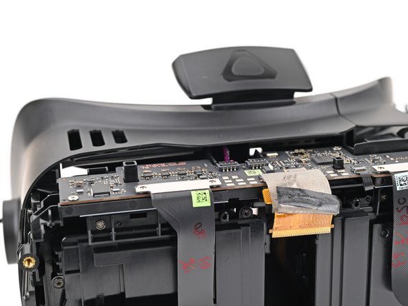

  27. HTC Vive Pro 2 Lens Assembly Replacement, Remove the thermal pad: crwdns2935265:027crwdnd2935265:01crwdnd2935265:03crwdne2935265:0 HTC Vive Pro 2 Lens Assembly Replacement, Remove the thermal pad: crwdns2935265:027crwdnd2935265:02crwdnd2935265:03crwdne2935265:0 HTC Vive Pro 2 Lens Assembly Replacement, Remove the thermal pad: crwdns2935265:027crwdnd2935265:03crwdnd2935265:03crwdne2935265:0
    • Use your fingers to peel up the thermal pad covering the daughterboard.
    • The thermal pad will likely remove the Kapton tape from the ZIF connectors on the daughterboard. Replace the Kapton tape if necessary.
    • Set aside the thermal pad. You'll reuse it during reassembly.

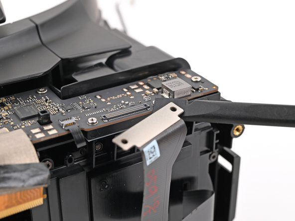

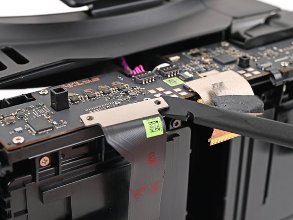

  28. HTC Vive Pro 2 Lens Assembly Replacement, Disconnect the lens assembly: crwdns2935265:028crwdnd2935265:01crwdnd2935265:03crwdne2935265:0 HTC Vive Pro 2 Lens Assembly Replacement, Disconnect the lens assembly: crwdns2935265:028crwdnd2935265:02crwdnd2935265:03crwdne2935265:0 HTC Vive Pro 2 Lens Assembly Replacement, Disconnect the lens assembly: crwdns2935265:028crwdnd2935265:03crwdnd2935265:03crwdne2935265:0
    • Insert the flat end of a spudger under a corner of the lens assembly press connector.
    • Don't insert your spudger anywhere else, as you risk dislodging nearby surface-mounted components.
    • Twist the spudger to lift the press connector up and disconnect it.
    • Repeat the same process to disconnect the other lens assembly press connector.
    • To re-attach press connectors like this one, carefully align and press down on one side until it clicks into place, then repeat on the other side. Don't press down in the middle. If the connector is misaligned, the pins can bend and cause permanent damage.

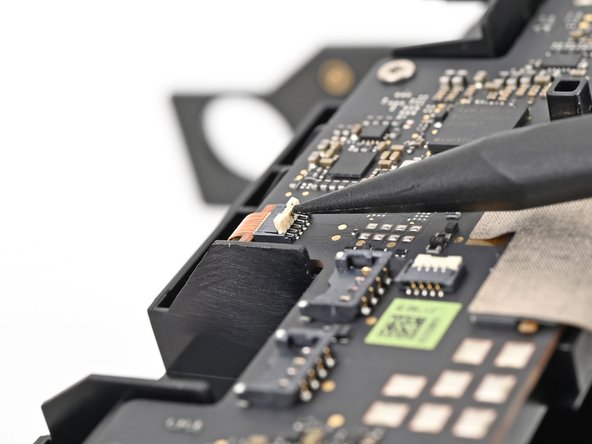

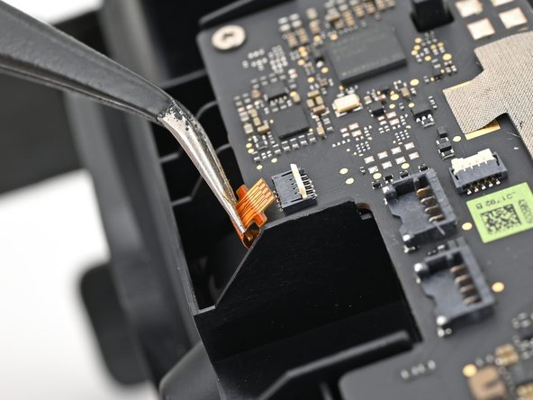

  29. HTC Vive Pro 2 Lens Assembly Replacement, Disconnect the IPD sensor: crwdns2935265:029crwdnd2935265:01crwdnd2935265:02crwdne2935265:0 HTC Vive Pro 2 Lens Assembly Replacement, Disconnect the IPD sensor: crwdns2935265:029crwdnd2935265:02crwdnd2935265:02crwdne2935265:0
    • Use the point of a spudger to lift up the locking tab on the IPD sensor ZIF connector.
  30. HTC Vive Pro 2 Lens Assembly Replacement: crwdns2935265:030crwdnd2935265:01crwdnd2935265:02crwdne2935265:0 HTC Vive Pro 2 Lens Assembly Replacement: crwdns2935265:030crwdnd2935265:02crwdnd2935265:02crwdne2935265:0
    • Use tweezers, or your fingers, to pull the IPD sensor cable straight out of its socket.

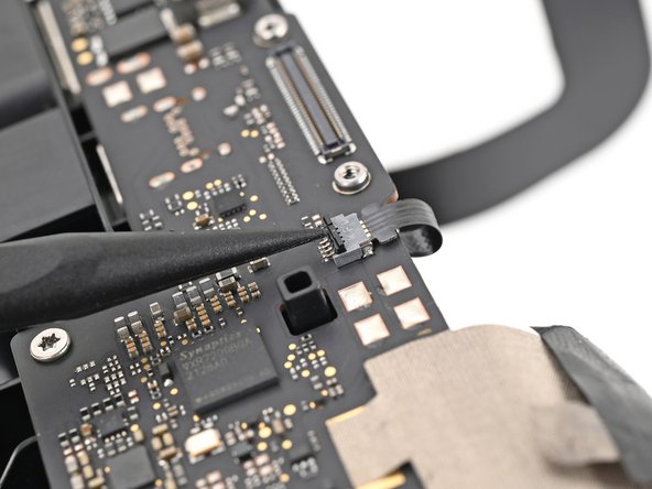

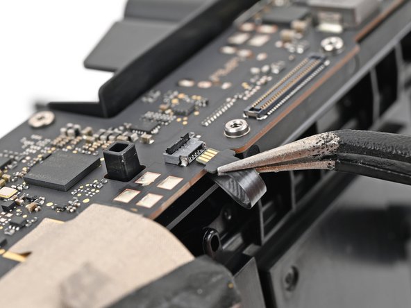

  31. HTC Vive Pro 2 Lens Assembly Replacement, Disconnect the proximity sensor: crwdns2935265:031crwdnd2935265:01crwdnd2935265:02crwdne2935265:0 HTC Vive Pro 2 Lens Assembly Replacement, Disconnect the proximity sensor: crwdns2935265:031crwdnd2935265:02crwdnd2935265:02crwdne2935265:0
    • Use the point of a spudger to lift up the locking tab on the proximity sensor ZIF connector.
  32. HTC Vive Pro 2 Lens Assembly Replacement: crwdns2935265:032crwdnd2935265:01crwdnd2935265:02crwdne2935265:0 HTC Vive Pro 2 Lens Assembly Replacement: crwdns2935265:032crwdnd2935265:02crwdnd2935265:02crwdne2935265:0
    • Use tweezers, or your fingers, to pull the proximity sensor cable straight out of its socket.

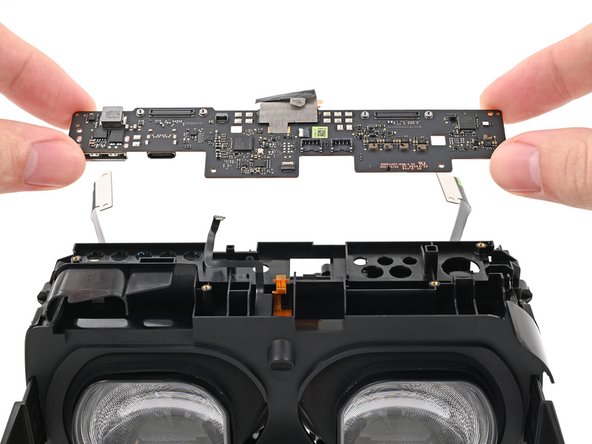

  33. HTC Vive Pro 2 Lens Assembly Replacement, Remove the daughterboard screws: crwdns2935265:033crwdnd2935265:01crwdnd2935265:02crwdne2935265:0 HTC Vive Pro 2 Lens Assembly Replacement, Remove the daughterboard screws: crwdns2935265:033crwdnd2935265:02crwdnd2935265:02crwdne2935265:0
    • Use a T5 Torx screwdriver to remove the four 3.0 mm‑long screws securing the daughterboard.
  34. HTC Vive Pro 2 Lens Assembly Replacement, Remove the daughterboard: crwdns2935265:034crwdnd2935265:01crwdnd2935265:02crwdne2935265:0 HTC Vive Pro 2 Lens Assembly Replacement, Remove the daughterboard: crwdns2935265:034crwdnd2935265:02crwdnd2935265:02crwdne2935265:0
    • Lift the daughterboard straight off the lens assembly and remove it.
    • During reassembly, make sure no cables are trapped under the daughterboard when placing it back on the headset.

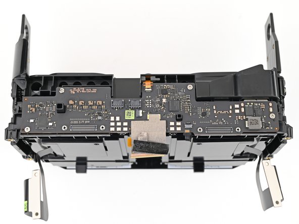

  35. HTC Vive Pro 2 Lens Assembly Replacement, The lens assembly remains: crwdns2935265:035crwdnd2935265:01crwdnd2935265:01crwdne2935265:0
    • Only the lens assembly remains.
