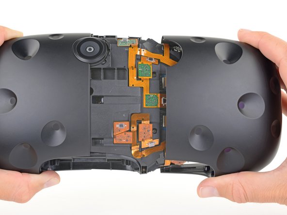

    1. HTC Vive Outer Shell Replacement, Unscrew the outer shell: crwdns2935265:04crwdnd2935265:01crwdnd2935265:03crwdne2935265:0 HTC Vive Outer Shell Replacement, Unscrew the outer shell: crwdns2935265:04crwdnd2935265:02crwdnd2935265:03crwdne2935265:0 HTC Vive Outer Shell Replacement, Unscrew the outer shell: crwdns2935265:04crwdnd2935265:03crwdnd2935265:03crwdne2935265:0
      • Use tweezers to remove the small stickers over the four screws securing the outer shell.
      • Use a T5 Torx driver to remove the four 3.4 mm-long screws securing the outer shell.

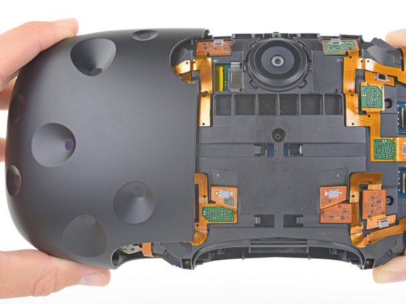

    2. HTC Vive Outer Shell Replacement, Remove the outer shell: crwdns2935265:05crwdnd2935265:01crwdnd2935265:02crwdne2935265:0 HTC Vive Outer Shell Replacement, Remove the outer shell: crwdns2935265:05crwdnd2935265:02crwdnd2935265:02crwdne2935265:0
      • Use the flat end of a spudger to pry up the top edge of the right half of the outer shell, behind the component cover and near the seam in the center, until it is unclipped from the headset.
    3. HTC Vive Outer Shell Replacement: crwdns2935265:06crwdnd2935265:01crwdnd2935265:02crwdne2935265:0 HTC Vive Outer Shell Replacement: crwdns2935265:06crwdnd2935265:02crwdnd2935265:02crwdne2935265:0
      • Grasp the right half the outer shell and pull it to the right and toward the front of the headset until you feel the clips on the front of the cover release.
      • If the shell is difficult to remove, try prying along the seam with the flat end of a spudger to release the clips.
    4. HTC Vive Outer Shell Replacement: crwdns2935265:07crwdnd2935265:01crwdnd2935265:02crwdne2935265:0 HTC Vive Outer Shell Replacement: crwdns2935265:07crwdnd2935265:02crwdnd2935265:02crwdne2935265:0
      • Slide the right side of the outer shell to the right and off of the headset.
    5. HTC Vive Outer Shell Replacement: crwdns2935265:08crwdnd2935265:01crwdnd2935265:02crwdne2935265:0 HTC Vive Outer Shell Replacement: crwdns2935265:08crwdnd2935265:02crwdnd2935265:02crwdne2935265:0
      • Repeat the last three steps for the left side of the outer shell and remove it.
