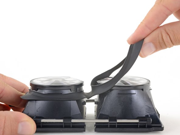

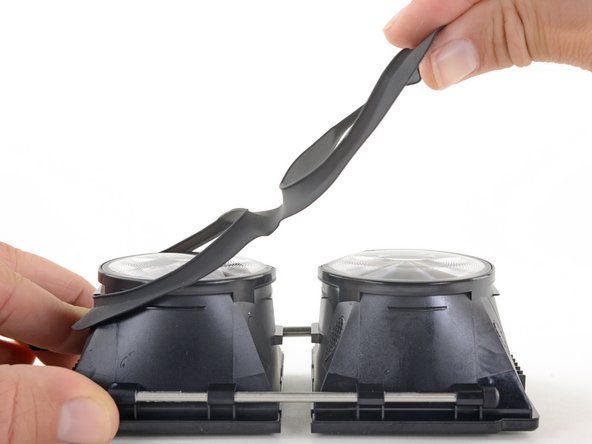

  31. HTC Vive Lens and OLED Frames Replacement, Remove the eyepiece gasket: crwdns2935265:031crwdnd2935265:01crwdnd2935265:03crwdne2935265:0 HTC Vive Lens and OLED Frames Replacement, Remove the eyepiece gasket: crwdns2935265:031crwdnd2935265:02crwdnd2935265:03crwdne2935265:0 HTC Vive Lens and OLED Frames Replacement, Remove the eyepiece gasket: crwdns2935265:031crwdnd2935265:03crwdnd2935265:03crwdne2935265:0
    • Gently lift the eyepiece gasket off of the lens and OLED frames to remove it.

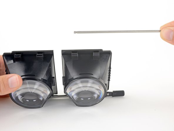

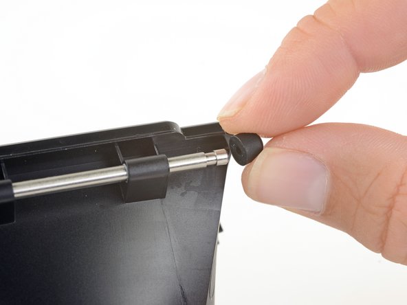

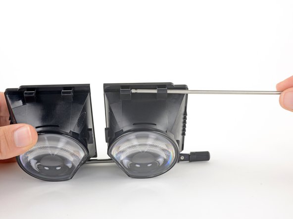

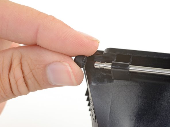

  32. HTC Vive Lens and OLED Frames Replacement, Remove the support rod: crwdns2935265:032crwdnd2935265:01crwdnd2935265:03crwdne2935265:0 HTC Vive Lens and OLED Frames Replacement, Remove the support rod: crwdns2935265:032crwdnd2935265:02crwdnd2935265:03crwdne2935265:0 HTC Vive Lens and OLED Frames Replacement, Remove the support rod: crwdns2935265:032crwdnd2935265:03crwdnd2935265:03crwdne2935265:0
    • Pull the rubber bumpers off of either end of the support rod.
  33. HTC Vive Lens and OLED Frames Replacement: crwdns2935265:033crwdnd2935265:01crwdnd2935265:03crwdne2935265:0 HTC Vive Lens and OLED Frames Replacement: crwdns2935265:033crwdnd2935265:02crwdnd2935265:03crwdne2935265:0 HTC Vive Lens and OLED Frames Replacement: crwdns2935265:033crwdnd2935265:03crwdnd2935265:03crwdne2935265:0
    • Slide the support rod out of its brackets on the lens and OLED frames.

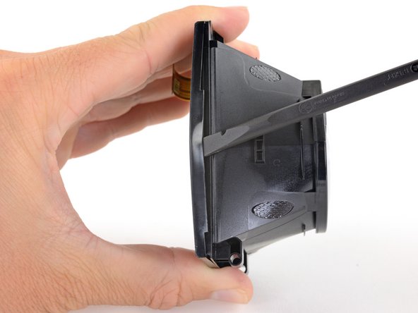

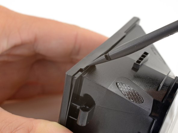

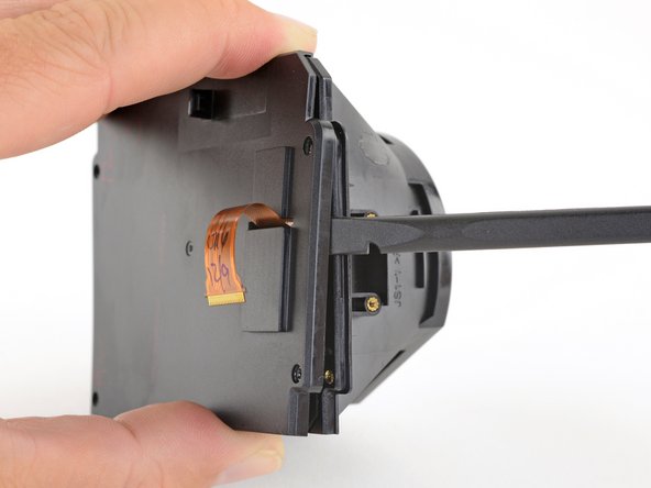

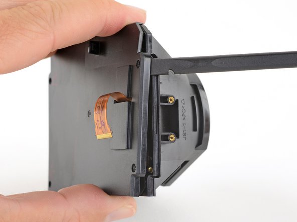

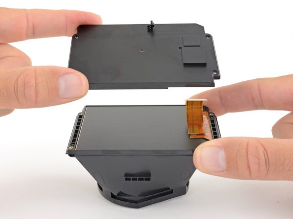

  37. HTC Vive Lens and OLED Frames Replacement, Remove the OLED covers: crwdns2935265:037crwdnd2935265:01crwdnd2935265:02crwdne2935265:0 HTC Vive Lens and OLED Frames Replacement, Remove the OLED covers: crwdns2935265:037crwdnd2935265:02crwdnd2935265:02crwdne2935265:0
    • Use the flat end of a spudger push up one edge of the OLED cover and start unclipping that edge.
  38. HTC Vive Lens and OLED Frames Replacement: crwdns2935265:038crwdnd2935265:01crwdnd2935265:02crwdne2935265:0 HTC Vive Lens and OLED Frames Replacement: crwdns2935265:038crwdnd2935265:02crwdnd2935265:02crwdne2935265:0
    • Slide the spudger under the clip along that edge to free the rest of the edge.
  39. HTC Vive Lens and OLED Frames Replacement: crwdns2935265:039crwdnd2935265:01crwdnd2935265:03crwdne2935265:0 HTC Vive Lens and OLED Frames Replacement: crwdns2935265:039crwdnd2935265:02crwdnd2935265:03crwdne2935265:0 HTC Vive Lens and OLED Frames Replacement: crwdns2935265:039crwdnd2935265:03crwdnd2935265:03crwdne2935265:0
    • Slide the spudger around the remaining edges of the OLED cover to unclip those edges.
  40. HTC Vive Lens and OLED Frames Replacement: crwdns2935265:040crwdnd2935265:01crwdnd2935265:02crwdne2935265:0 HTC Vive Lens and OLED Frames Replacement: crwdns2935265:040crwdnd2935265:02crwdnd2935265:02crwdne2935265:0
    • Remove the OLED cover.
    • Repeat the last three steps to remove the other OLED cover.
    • During reassembly, remember to thread the OLED cables through their slots in the OLED cover.

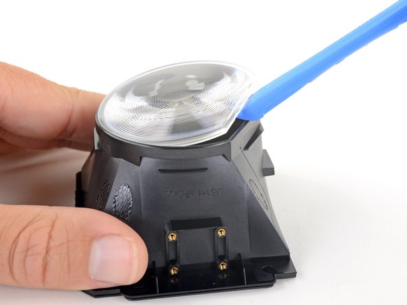

  42. HTC Vive Lens and OLED Frames Replacement, Remove the lenses: crwdns2935265:042crwdnd2935265:01crwdnd2935265:01crwdne2935265:0
    • Apply an iOpener to the lens to soften the adhesive securing it to the frame.
  43. HTC Vive Lens and OLED Frames Replacement: crwdns2935265:043crwdnd2935265:01crwdnd2935265:02crwdne2935265:0 HTC Vive Lens and OLED Frames Replacement: crwdns2935265:043crwdnd2935265:02crwdnd2935265:02crwdne2935265:0
    • Use an opening tool to pry up the flat edge of the lens.
    • If it's difficult to pry up, apply the iOpener for another 30 seconds to further soften the adhesive.
  44. HTC Vive Lens and OLED Frames Replacement, Remove the lens: crwdns2935265:044crwdnd2935265:01crwdnd2935265:01crwdne2935265:0
    • Remove the lens.
    • Repeat the last two steps to remove the other lens.
    • Only the lens and OLED frames remain.
    • During reassembly, make sure the convex side of the lens is facing away from the frame.
