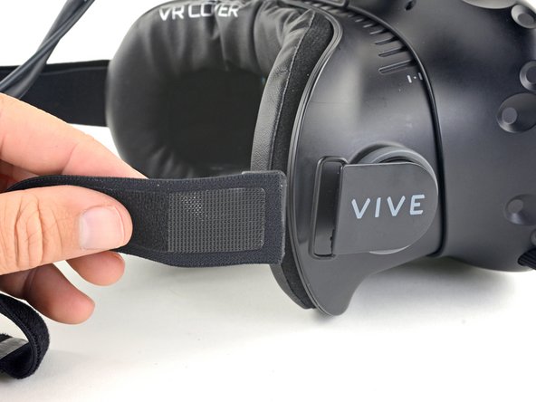

HTC Vive Head Strap Replacement
  1. HTC Vive Head Strap Replacement, Release the upper head strap: crwdns2935265:01crwdnd2935265:01crwdnd2935265:02crwdne2935265:0 HTC Vive Head Strap Replacement, Release the upper head strap: crwdns2935265:01crwdnd2935265:02crwdnd2935265:02crwdne2935265:0
    • Be sure to power down and disconnect your Vive before beginning.
    • Pull the hook-and-loop (Velcro) closure at the top of the head strap apart to release the top of the head strap.
  2. HTC Vive Head Strap Replacement, Remove the upper head strap: crwdns2935265:02crwdnd2935265:01crwdnd2935265:02crwdne2935265:0 HTC Vive Head Strap Replacement, Remove the upper head strap: crwdns2935265:02crwdnd2935265:02crwdnd2935265:02crwdne2935265:0
    • Slide the top part of the head strap through its metal loop on the headset to remove it.

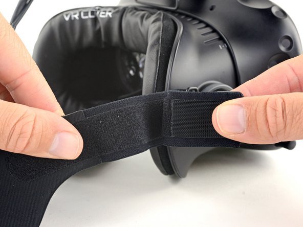

  3. HTC Vive Head Strap Replacement, Remove the right side of the head strap: crwdns2935265:03crwdnd2935265:01crwdnd2935265:03crwdne2935265:0 HTC Vive Head Strap Replacement, Remove the right side of the head strap: crwdns2935265:03crwdnd2935265:02crwdnd2935265:03crwdne2935265:0 HTC Vive Head Strap Replacement, Remove the right side of the head strap: crwdns2935265:03crwdnd2935265:03crwdnd2935265:03crwdne2935265:0
    • Pull the hook-and-loop closure at the right side of the head strap apart to release the right side of the head strap.
    • Slide the right side of the head strap through its metal loop to remove it.
  4. HTC Vive Head Strap Replacement, Remove the left side of the head strap: crwdns2935265:04crwdnd2935265:01crwdnd2935265:03crwdne2935265:0 HTC Vive Head Strap Replacement, Remove the left side of the head strap: crwdns2935265:04crwdnd2935265:02crwdnd2935265:03crwdne2935265:0 HTC Vive Head Strap Replacement, Remove the left side of the head strap: crwdns2935265:04crwdnd2935265:03crwdnd2935265:03crwdne2935265:0
    • Pull the hook-and-loop closure at the left side of the head strap apart to release the left side of the head strap.
    • Slide the left side of the head strap through its metal loop to remove it.
  5. HTC Vive Head Strap Replacement, Remove the head strap: crwdns2935265:05crwdnd2935265:01crwdnd2935265:03crwdne2935265:0 HTC Vive Head Strap Replacement, Remove the head strap: crwdns2935265:05crwdnd2935265:02crwdnd2935265:03crwdne2935265:0 HTC Vive Head Strap Replacement, Remove the head strap: crwdns2935265:05crwdnd2935265:03crwdnd2935265:03crwdne2935265:0
    • Slide the head strap along the cable, away from the Vive.
    • When the head strap comes to the end of the cable, gently slide it over the plugs and remove it.
