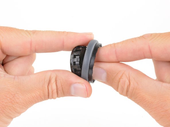

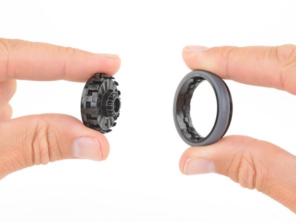

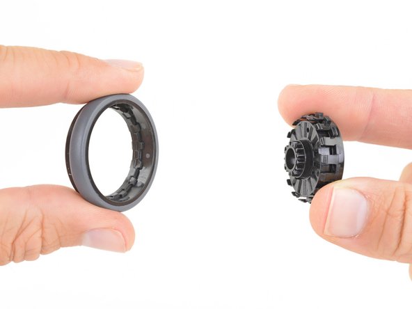

  3. HTC Vive Head Strap Mounts Replacement, Separate the head strap mount components: crwdns2935265:03crwdnd2935265:01crwdnd2935265:02crwdne2935265:0 HTC Vive Head Strap Mounts Replacement, Separate the head strap mount components: crwdns2935265:03crwdnd2935265:02crwdnd2935265:02crwdne2935265:0
    • Pull the rubberized grip off of the head strap mount.

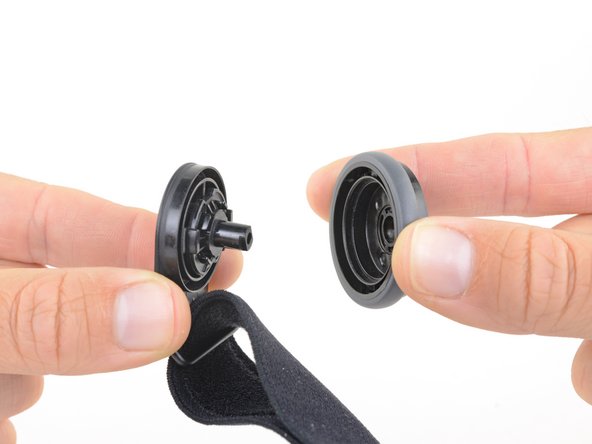

  4. HTC Vive Head Strap Mounts Replacement: crwdns2935265:04crwdnd2935265:01crwdnd2935265:03crwdne2935265:0 HTC Vive Head Strap Mounts Replacement: crwdns2935265:04crwdnd2935265:02crwdnd2935265:03crwdne2935265:0 HTC Vive Head Strap Mounts Replacement: crwdns2935265:04crwdnd2935265:03crwdnd2935265:03crwdne2935265:0
    • Push the internal locking mechanism out of the grip.

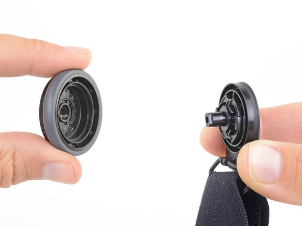

  5. HTC Vive Head Strap Mounts Replacement: crwdns2935265:05crwdnd2935265:01crwdnd2935265:03crwdne2935265:0 HTC Vive Head Strap Mounts Replacement: crwdns2935265:05crwdnd2935265:02crwdnd2935265:03crwdne2935265:0 HTC Vive Head Strap Mounts Replacement: crwdns2935265:05crwdnd2935265:03crwdnd2935265:03crwdne2935265:0
    • Repeat the previous three steps with the right head strap mount to remove it and separate its components.

Anybody knows where i can get the part, that is removed in step 3? On the picture it stays with the head strap mount, but the headstrap is sold without it. Im espacily looking for the plastic part, where the screw goes through.
MrBesen - crwdns2934203:0crwdne2934203:0
same, if u found it lemme know
auris -
same man, my headstrap mount and a tracker dongle broke and theres no way to replace it. fml
