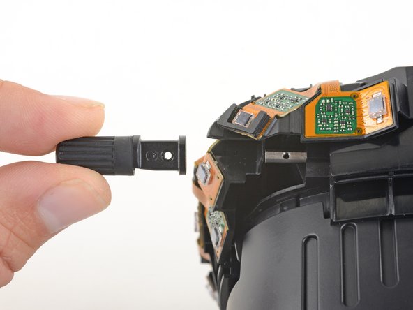

  6. HTC Vive Focus Knob Replacement, Unscrew the focus knob: crwdns2935265:06crwdnd2935265:01crwdnd2935265:01crwdne2935265:0
    • Use a PH000 driver to remove the screw securing the focus knob.
  7. HTC Vive Focus Knob Replacement, Remove the focus knob: crwdns2935265:07crwdnd2935265:01crwdnd2935265:02crwdne2935265:0 HTC Vive Focus Knob Replacement, Remove the focus knob: crwdns2935265:07crwdnd2935265:02crwdnd2935265:02crwdne2935265:0
    • Slide the focus knob off of the focus rod and remove it.
