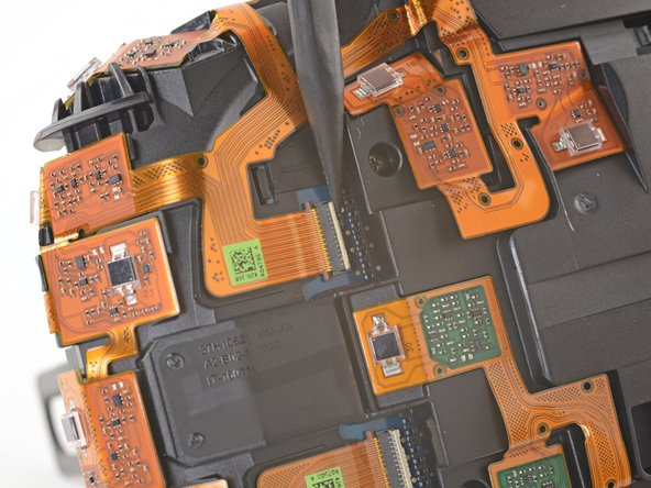

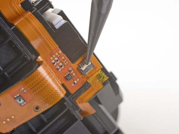

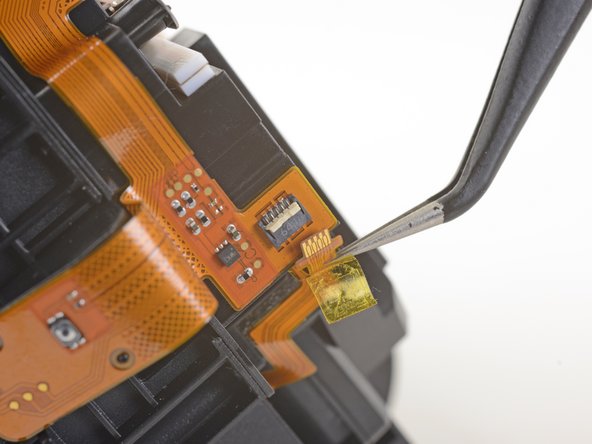

  12. HTC Vive Facerest Midframe Replacement, Disconnect the sensor array cables: crwdns2935265:012crwdnd2935265:01crwdnd2935265:03crwdne2935265:0 HTC Vive Facerest Midframe Replacement, Disconnect the sensor array cables: crwdns2935265:012crwdnd2935265:02crwdnd2935265:03crwdne2935265:0 HTC Vive Facerest Midframe Replacement, Disconnect the sensor array cables: crwdns2935265:012crwdnd2935265:03crwdnd2935265:03crwdne2935265:0
    • Use tweezers to remove the clear tape over all four of the sensor array cable connectors.
  13. HTC Vive Facerest Midframe Replacement: crwdns2935265:013crwdnd2935265:01crwdnd2935265:03crwdne2935265:0 HTC Vive Facerest Midframe Replacement: crwdns2935265:013crwdnd2935265:02crwdnd2935265:03crwdne2935265:0 HTC Vive Facerest Midframe Replacement: crwdns2935265:013crwdnd2935265:03crwdnd2935265:03crwdne2935265:0
    • Use the pointed end of a spudger to flip up the small locking flap on one of the sensor array ZIF connectors.
    • Slide the cable straight out of its socket on the motherboard.
  14. HTC Vive Facerest Midframe Replacement: crwdns2935265:014crwdnd2935265:01crwdnd2935265:03crwdne2935265:0 HTC Vive Facerest Midframe Replacement: crwdns2935265:014crwdnd2935265:02crwdnd2935265:03crwdne2935265:0 HTC Vive Facerest Midframe Replacement: crwdns2935265:014crwdnd2935265:03crwdnd2935265:03crwdne2935265:0
    • Repeat the previous step for the remaining three sensor array cables to disconnect the remaining cables.

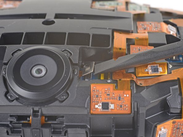

  15. HTC Vive Facerest Midframe Replacement: crwdns2935265:015crwdnd2935265:01crwdnd2935265:02crwdne2935265:0 HTC Vive Facerest Midframe Replacement: crwdns2935265:015crwdnd2935265:02crwdnd2935265:02crwdne2935265:0
    • Use tweezers or a spudger to pry up the camera cable cover and remove it.
  16. HTC Vive Facerest Midframe Replacement: crwdns2935265:016crwdnd2935265:01crwdnd2935265:02crwdne2935265:0 HTC Vive Facerest Midframe Replacement: crwdns2935265:016crwdnd2935265:02crwdnd2935265:02crwdne2935265:0
    • Use the flat end of a spudger to pry the camera cable connector straight up from its socket on the motherboard.

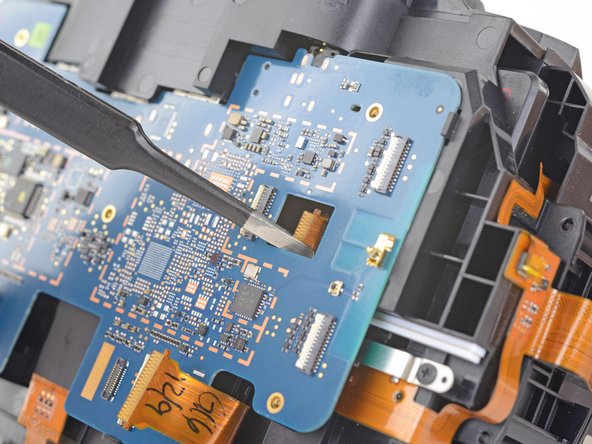

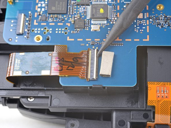

  21. HTC Vive Facerest Midframe Replacement, Disconnect the motherboard: crwdns2935265:021crwdnd2935265:01crwdnd2935265:03crwdne2935265:0 HTC Vive Facerest Midframe Replacement, Disconnect the motherboard: crwdns2935265:021crwdnd2935265:02crwdnd2935265:03crwdne2935265:0 HTC Vive Facerest Midframe Replacement, Disconnect the motherboard: crwdns2935265:021crwdnd2935265:03crwdnd2935265:03crwdne2935265:0
    • Remove the tape covering the interconnect cable socket.
    • Use the point of a spudger to flip up the small locking flap on the cable socket.
    • Slide the interconnect cable straight out of its socket on the motherboard.
  22. HTC Vive Facerest Midframe Replacement: crwdns2935265:022crwdnd2935265:01crwdnd2935265:03crwdne2935265:0 HTC Vive Facerest Midframe Replacement: crwdns2935265:022crwdnd2935265:02crwdnd2935265:03crwdne2935265:0 HTC Vive Facerest Midframe Replacement: crwdns2935265:022crwdnd2935265:03crwdnd2935265:03crwdne2935265:0
    • Remove the tape covering the left OLED cable socket.
    • Slide the left OLED cable straight out of its socket on the motherboard.

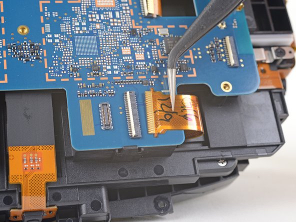

  23. HTC Vive Facerest Midframe Replacement: crwdns2935265:023crwdnd2935265:01crwdnd2935265:03crwdne2935265:0 HTC Vive Facerest Midframe Replacement: crwdns2935265:023crwdnd2935265:02crwdnd2935265:03crwdne2935265:0 HTC Vive Facerest Midframe Replacement: crwdns2935265:023crwdnd2935265:03crwdnd2935265:03crwdne2935265:0
    • Remove the tape covering the right OLED cable socket.
    • Slide the right OLED cable straight out of its socket on the motherboard.
  24. HTC Vive Facerest Midframe Replacement: crwdns2935265:024crwdnd2935265:01crwdnd2935265:02crwdne2935265:0 HTC Vive Facerest Midframe Replacement: crwdns2935265:024crwdnd2935265:02crwdnd2935265:02crwdne2935265:0
    • Use a pair tweezers to slightly twist the interconnect cable and press it down until the tabs on either side of the cable clear the hole in the motherboard.
    • During reassembly, make sure to thread the interconnect cable through its slot in the motherboard.

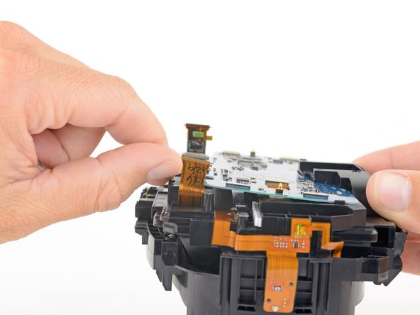

  25. HTC Vive Facerest Midframe Replacement, Remove the motherboard: crwdns2935265:025crwdnd2935265:01crwdnd2935265:03crwdne2935265:0 HTC Vive Facerest Midframe Replacement, Remove the motherboard: crwdns2935265:025crwdnd2935265:02crwdnd2935265:03crwdne2935265:0 HTC Vive Facerest Midframe Replacement, Remove the motherboard: crwdns2935265:025crwdnd2935265:03crwdnd2935265:03crwdne2935265:0
    • Press the non-port-end of the motherboard toward the top of headset while hinging it away from the midframe to free it from the clips securing that end.
    • Slide the motherboard toward the bottom of the headset, over the clips, to remove it.
    • Take care not to snag any cables during removal.

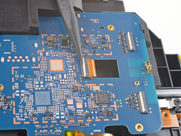

  26. HTC Vive Facerest Midframe Replacement, Disconnect the facerest midframe: crwdns2935265:026crwdnd2935265:01crwdnd2935265:03crwdne2935265:0 HTC Vive Facerest Midframe Replacement, Disconnect the facerest midframe: crwdns2935265:026crwdnd2935265:02crwdnd2935265:03crwdne2935265:0 HTC Vive Facerest Midframe Replacement, Disconnect the facerest midframe: crwdns2935265:026crwdnd2935265:03crwdnd2935265:03crwdne2935265:0
    • Use a pair of tweezers to peel back the plastic covering the eyepiece midframe cable socket.
    • Use the pointed end of a spudger to flip up the plastic locking flap on the socket.
    • Slide the cable straight out of its socket to remove it.
