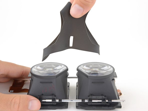

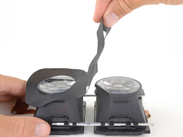

  25. HTC Vive Cosmos Lens and LCD Frame Replacement, Remove the lens gasket: crwdns2935265:025crwdnd2935265:01crwdnd2935265:03crwdne2935265:0 HTC Vive Cosmos Lens and LCD Frame Replacement, Remove the lens gasket: crwdns2935265:025crwdnd2935265:02crwdnd2935265:03crwdne2935265:0 HTC Vive Cosmos Lens and LCD Frame Replacement, Remove the lens gasket: crwdns2935265:025crwdnd2935265:03crwdnd2935265:03crwdne2935265:0
    • Gently lift the lens gasket off of the lens and LCD frames to remove it.

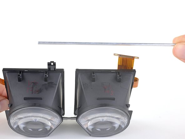

  26. HTC Vive Cosmos Lens and LCD Frame Replacement, Remove the support rod: crwdns2935265:026crwdnd2935265:01crwdnd2935265:02crwdne2935265:0 HTC Vive Cosmos Lens and LCD Frame Replacement, Remove the support rod: crwdns2935265:026crwdnd2935265:02crwdnd2935265:02crwdne2935265:0
    • Slide the support rod out of its brackets on the lens and LCD frames.

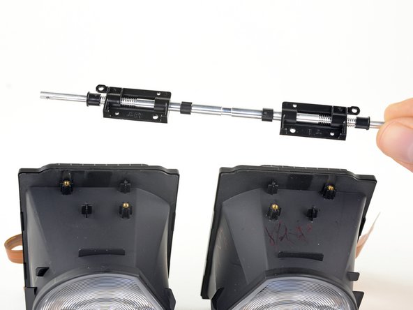

  27. HTC Vive Cosmos Lens and LCD Frame Replacement, Remove the focus rod: crwdns2935265:027crwdnd2935265:01crwdnd2935265:01crwdne2935265:0
    • Use a T5 Torx driver to remove the four 4.1 mm screws securing the focus rod brackets.
  28. HTC Vive Cosmos Lens and LCD Frame Replacement: crwdns2935265:028crwdnd2935265:01crwdnd2935265:02crwdne2935265:0 HTC Vive Cosmos Lens and LCD Frame Replacement: crwdns2935265:028crwdnd2935265:02crwdnd2935265:02crwdne2935265:0
    • Remove the focus rod and its brackets.

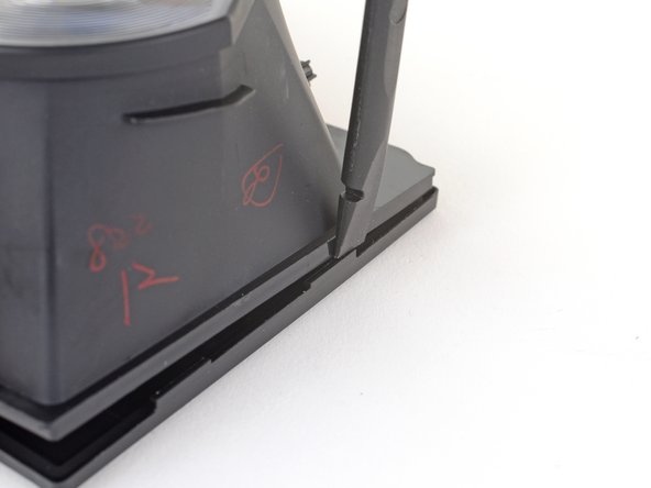

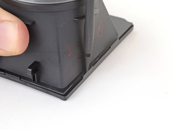

  29. HTC Vive Cosmos Lens and LCD Frame Replacement, Remove the outer LCD cover: crwdns2935265:029crwdnd2935265:01crwdnd2935265:03crwdne2935265:0 HTC Vive Cosmos Lens and LCD Frame Replacement, Remove the outer LCD cover: crwdns2935265:029crwdnd2935265:02crwdnd2935265:03crwdne2935265:0 HTC Vive Cosmos Lens and LCD Frame Replacement, Remove the outer LCD cover: crwdns2935265:029crwdnd2935265:03crwdnd2935265:03crwdne2935265:0
    • Pick one lens and LCD frame to work with for the rest of the guide. After removing the first frame, repeat the next seven steps with the other frame to remove it as well.
    • Insert the flat end of a spudger in between the edge of the lens LCD frame and the outer LCD cover.
    • Twist the spudger to release the clips securing the LCD cover to the frame.
    • Repeat the insertion and twisting process for each clip on the LCD cover.

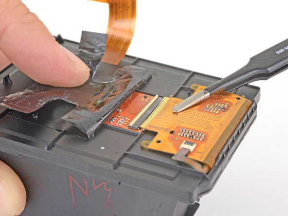

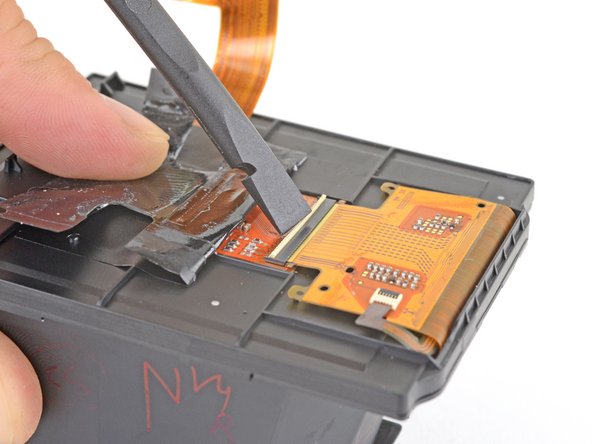

  30. HTC Vive Cosmos Lens and LCD Frame Replacement, Disconnect the LCD panel: crwdns2935265:030crwdnd2935265:01crwdnd2935265:01crwdne2935265:0
    • Gently peel the sticker covering the LCD cable and connector back far enough to access the LCD connector.
  31. HTC Vive Cosmos Lens and LCD Frame Replacement: crwdns2935265:031crwdnd2935265:01crwdnd2935265:03crwdne2935265:0 HTC Vive Cosmos Lens and LCD Frame Replacement: crwdns2935265:031crwdnd2935265:02crwdnd2935265:03crwdne2935265:0 HTC Vive Cosmos Lens and LCD Frame Replacement: crwdns2935265:031crwdnd2935265:03crwdnd2935265:03crwdne2935265:0
    • Use the flat end of a spudger to flip up the locking flap securing the LCD cable ZIF connector.
    • Carefully slide the LCD cable straight out of its socket.

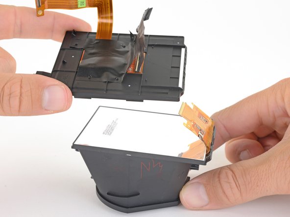

  32. HTC Vive Cosmos Lens and LCD Frame Replacement, Remove the inner LCD cover: crwdns2935265:032crwdnd2935265:01crwdnd2935265:02crwdne2935265:0 HTC Vive Cosmos Lens and LCD Frame Replacement, Remove the inner LCD cover: crwdns2935265:032crwdnd2935265:02crwdnd2935265:02crwdne2935265:0
    • Slowly lift the LCD cover away from the lens and LCD frame, taking care to thread the LCD cable through the cover.

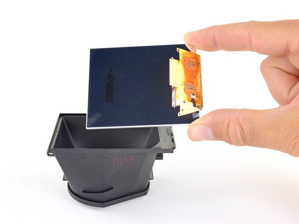

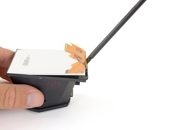

  33. HTC Vive Cosmos Lens and LCD Frame Replacement, Remove the LCD panel: crwdns2935265:033crwdnd2935265:01crwdnd2935265:03crwdne2935265:0 HTC Vive Cosmos Lens and LCD Frame Replacement, Remove the LCD panel: crwdns2935265:033crwdnd2935265:02crwdnd2935265:03crwdne2935265:0 HTC Vive Cosmos Lens and LCD Frame Replacement, Remove the LCD panel: crwdns2935265:033crwdnd2935265:03crwdnd2935265:03crwdne2935265:0
    • This step may damage the LCD panel. Continue only if the panel is already damaged.
    • Use the flat end of a spudger to pry up the LCD panel.
    • Remove the LCD panel.

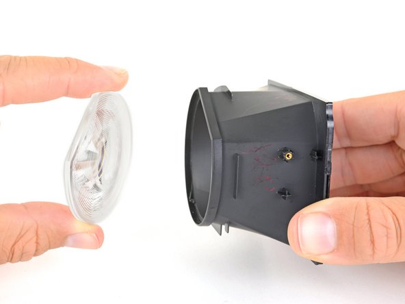

  34. HTC Vive Cosmos Lens and LCD Frame Replacement, Remove the lens: crwdns2935265:034crwdnd2935265:01crwdnd2935265:03crwdne2935265:0 HTC Vive Cosmos Lens and LCD Frame Replacement, Remove the lens: crwdns2935265:034crwdnd2935265:02crwdnd2935265:03crwdne2935265:0 HTC Vive Cosmos Lens and LCD Frame Replacement, Remove the lens: crwdns2935265:034crwdnd2935265:03crwdnd2935265:03crwdne2935265:0
    • Push against the back of the lens to remove it from the frame.
    • If this is difficult, try heating the lens to soften the adhesive holding it to the frame.

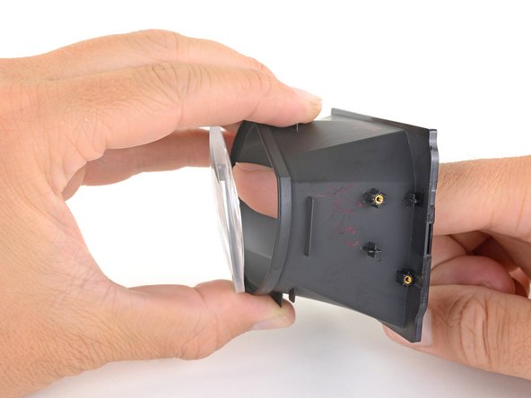

  35. HTC Vive Cosmos Lens and LCD Frame Replacement, Remove the lens and LCD frame: crwdns2935265:035crwdnd2935265:01crwdnd2935265:01crwdne2935265:0
    • Only the lens and LCD frame remains.
    • Repeat the last seven steps with the other lens and LCD frame to remove it as well.
