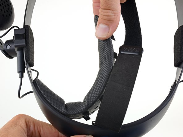

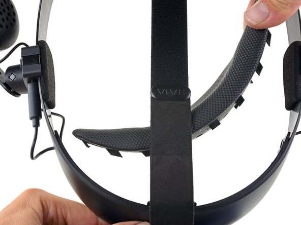

  3. HTC Vive Cosmos Headstrap Replacement, Remove the front headstrap pad: crwdns2935265:03crwdnd2935265:01crwdnd2935265:03crwdne2935265:0 HTC Vive Cosmos Headstrap Replacement, Remove the front headstrap pad: crwdns2935265:03crwdnd2935265:02crwdnd2935265:03crwdne2935265:0 HTC Vive Cosmos Headstrap Replacement, Remove the front headstrap pad: crwdns2935265:03crwdnd2935265:03crwdnd2935265:03crwdne2935265:0
    • Grasp one end of the front headstrap pad and pull it away from the headstrap to remove it.
    • During reassembly, press the pads firmly against the headstrap, starting in the middle and moving toward the edges, until all the clips on the pads are completely seated in the headstrap. There should be no gaps between the pads and the headstrap.

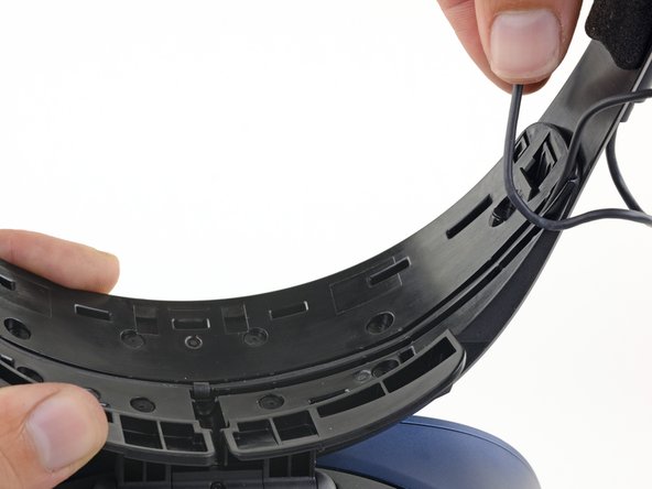

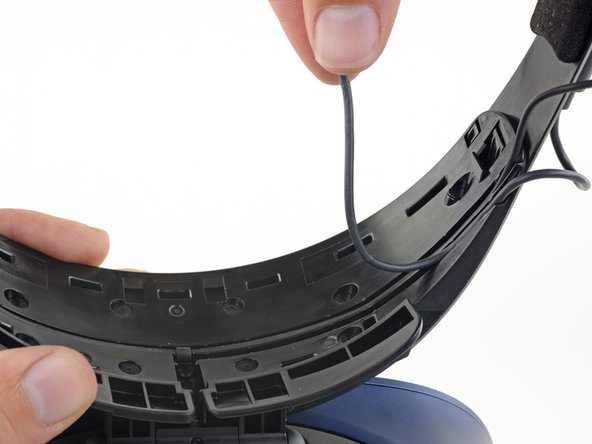

  4. HTC Vive Cosmos Headstrap Replacement, Remove the audio cables: crwdns2935265:04crwdnd2935265:01crwdnd2935265:03crwdne2935265:0 HTC Vive Cosmos Headstrap Replacement, Remove the audio cables: crwdns2935265:04crwdnd2935265:02crwdnd2935265:03crwdne2935265:0 HTC Vive Cosmos Headstrap Replacement, Remove the audio cables: crwdns2935265:04crwdnd2935265:03crwdnd2935265:03crwdne2935265:0
    • Carefully lift the audio connector cable out of its slot in the front of the headstrap.

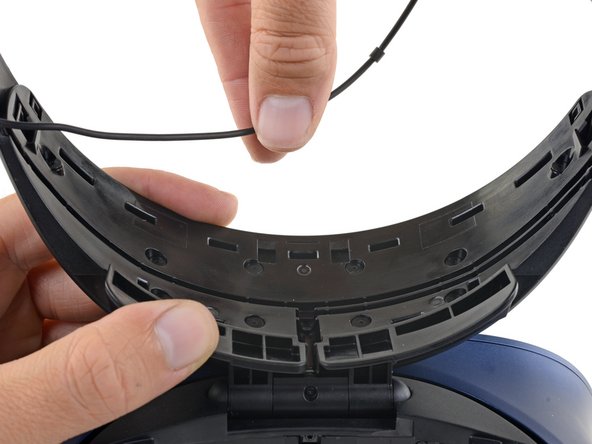

  5. HTC Vive Cosmos Headstrap Replacement: crwdns2935265:05crwdnd2935265:01crwdnd2935265:02crwdne2935265:0 HTC Vive Cosmos Headstrap Replacement: crwdns2935265:05crwdnd2935265:02crwdnd2935265:02crwdne2935265:0
    • Carefully lift the audio interconnect cable out of its slot in the front of the headstrap.
