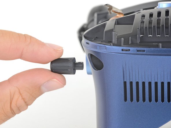

  3. HTC Vive Cosmos Focus Knob Replacement, Unscrew the focus knob: crwdns2935265:03crwdnd2935265:01crwdnd2935265:01crwdne2935265:0
    • Use a T5 Torx driver to remove the 4.1 mm long screw securing the focus knob.
  4. HTC Vive Cosmos Focus Knob Replacement, Remove the focus knob: crwdns2935265:04crwdnd2935265:01crwdnd2935265:02crwdne2935265:0 HTC Vive Cosmos Focus Knob Replacement, Remove the focus knob: crwdns2935265:04crwdnd2935265:02crwdnd2935265:02crwdne2935265:0
    • Slide the focus knob out of the plastic housing, off of the focus rod, and remove it.
