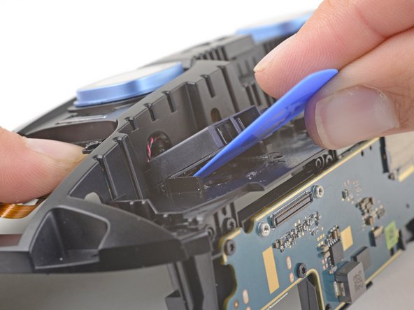

  10. HTC Vive Cosmos Fan Replacement, Remove the microphone: crwdns2935265:010crwdnd2935265:01crwdnd2935265:01crwdne2935265:0
    • Remove the microphone cover from the bottom edge of the headset.
  11. HTC Vive Cosmos Fan Replacement, Separate the microphone adhesive: crwdns2935265:011crwdnd2935265:01crwdnd2935265:02crwdne2935265:0 HTC Vive Cosmos Fan Replacement, Separate the microphone adhesive: crwdns2935265:011crwdnd2935265:02crwdnd2935265:02crwdne2935265:0
    • Slide an opening pick under the microphone to separate the adhesive securing it to the Vive.
    • If this is difficult, use a heated iOpener, hair dryer, or heat gun to apply heat to adhesive.

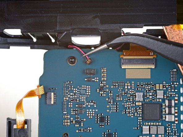

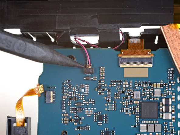

  25. HTC Vive Cosmos Fan Replacement, Disconnect the fan: crwdns2935265:025crwdnd2935265:01crwdnd2935265:02crwdne2935265:0 HTC Vive Cosmos Fan Replacement, Disconnect the fan: crwdns2935265:025crwdnd2935265:02crwdnd2935265:02crwdne2935265:0

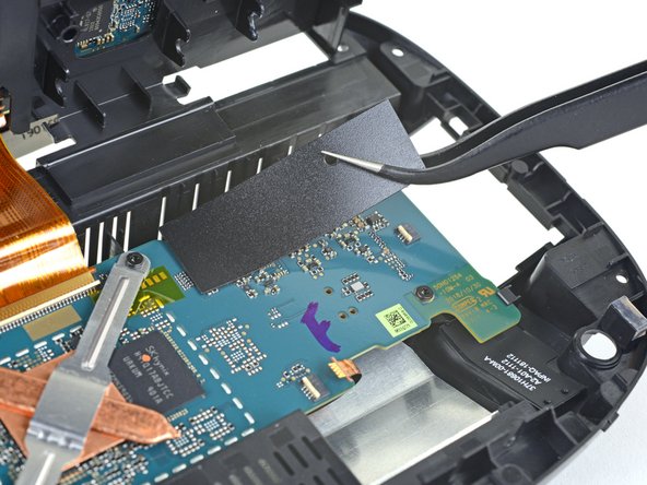

    • Peel both black plastic stickers off of either side of the motherboard.
  26. HTC Vive Cosmos Fan Replacement: crwdns2935265:026crwdnd2935265:01crwdnd2935265:03crwdne2935265:0 HTC Vive Cosmos Fan Replacement: crwdns2935265:026crwdnd2935265:02crwdnd2935265:03crwdne2935265:0 HTC Vive Cosmos Fan Replacement: crwdns2935265:026crwdnd2935265:03crwdnd2935265:03crwdne2935265:0
    • Use the tip of a spudger to push one side of the the fan connector slightly out of its socket on the motherboard, then push on the other side of the connector. Continue alternating pressure on each side to gently ease the connector out of its socket.
    • Apply pressure parallel to the motherboard. Do not pry up on the connector.

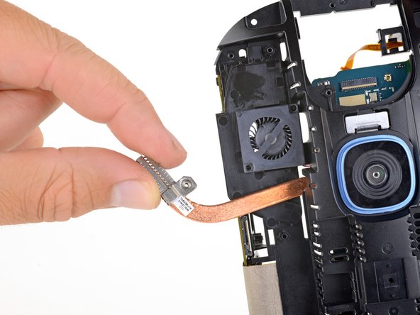

  27. HTC Vive Cosmos Fan Replacement, Unscrew the heat sink and fan: crwdns2935265:027crwdnd2935265:01crwdnd2935265:01crwdne2935265:0
    • Use a T5 Torx driver to remove the screws securing the heat sink and fan:
    • Two 4.1 mm long screws
    • One 8.5 mm long screw

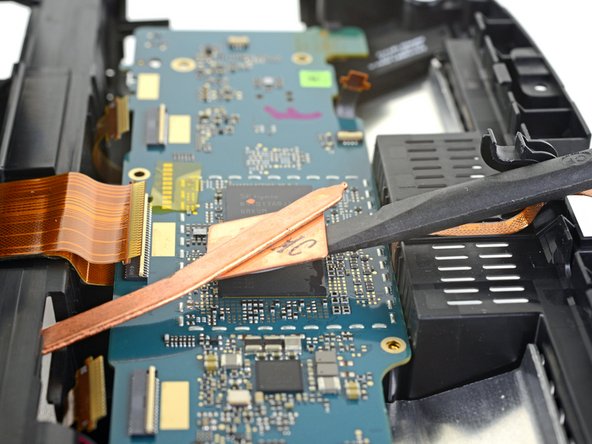

  28. HTC Vive Cosmos Fan Replacement, Unstick the heat sink: crwdns2935265:028crwdnd2935265:01crwdnd2935265:01crwdne2935265:0
    • Remove the heat sink bracket.
  29. HTC Vive Cosmos Fan Replacement: crwdns2935265:029crwdnd2935265:01crwdnd2935265:02crwdne2935265:0 HTC Vive Cosmos Fan Replacement: crwdns2935265:029crwdnd2935265:02crwdnd2935265:02crwdne2935265:0
  30. HTC Vive Cosmos Fan Replacement: crwdns2935265:030crwdnd2935265:01crwdnd2935265:02crwdne2935265:0 HTC Vive Cosmos Fan Replacement: crwdns2935265:030crwdnd2935265:02crwdnd2935265:02crwdne2935265:0
    • Slide the heat sink off of the fan. You do not need to completely remove it from the midframe.

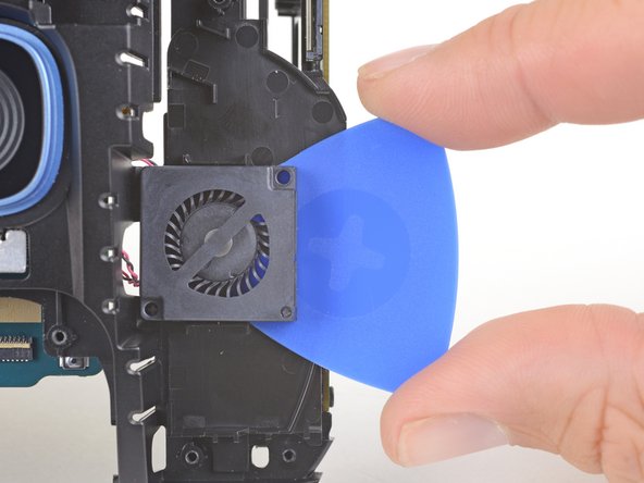

  31. HTC Vive Cosmos Fan Replacement, Remove the fan: crwdns2935265:031crwdnd2935265:01crwdnd2935265:02crwdne2935265:0 HTC Vive Cosmos Fan Replacement, Remove the fan: crwdns2935265:031crwdnd2935265:02crwdnd2935265:02crwdne2935265:0
    • Slide an opening pick between the fan and the midframe.
    • If this proves difficult, apply heat to the midframe directly under the fan to soften the adhesive securing the fan.
  32. HTC Vive Cosmos Fan Replacement: crwdns2935265:032crwdnd2935265:01crwdnd2935265:02crwdne2935265:0 HTC Vive Cosmos Fan Replacement: crwdns2935265:032crwdnd2935265:02crwdnd2935265:02crwdne2935265:0
    • Use the opening pick to pry the fan away from the midframe.
  33. HTC Vive Cosmos Fan Replacement: crwdns2935265:033crwdnd2935265:01crwdnd2935265:01crwdne2935265:0
    • Lift the fan straight up from the midframe and remove it.
