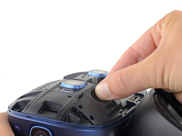

  4. HTC Vive Cosmos Faceplate Connector Replacement, Remove the upper component cover: crwdns2935265:04crwdnd2935265:01crwdnd2935265:01crwdne2935265:0
    • Use a T5 Torx driver to unscrew the screws securing the upper component cover:
    • Six 4.1 mm long screws
    • One captive screw
    • This screw is covered by a sticker. Poke your driver through the sticker to access the screw.

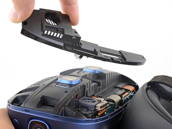

  5. HTC Vive Cosmos Faceplate Connector Replacement: crwdns2935265:05crwdnd2935265:01crwdnd2935265:03crwdne2935265:0 HTC Vive Cosmos Faceplate Connector Replacement: crwdns2935265:05crwdnd2935265:02crwdnd2935265:03crwdne2935265:0 HTC Vive Cosmos Faceplate Connector Replacement: crwdns2935265:05crwdnd2935265:03crwdnd2935265:03crwdne2935265:0
    • Angle the bottom end of the upper component cover away from the front of the Vive.
    • Pull the upper component cover away from the front of the Vive and remove it.

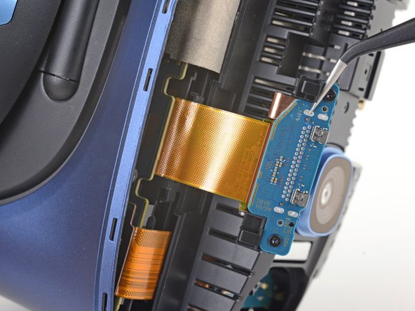

  6. HTC Vive Cosmos Faceplate Connector Replacement, Remove the faceplate cable connector cover: crwdns2935265:06crwdnd2935265:01crwdnd2935265:02crwdne2935265:0 HTC Vive Cosmos Faceplate Connector Replacement, Remove the faceplate cable connector cover: crwdns2935265:06crwdnd2935265:02crwdnd2935265:02crwdne2935265:0
    • Carefully slide the faceplate connector out of its recess in the front of the Vive.

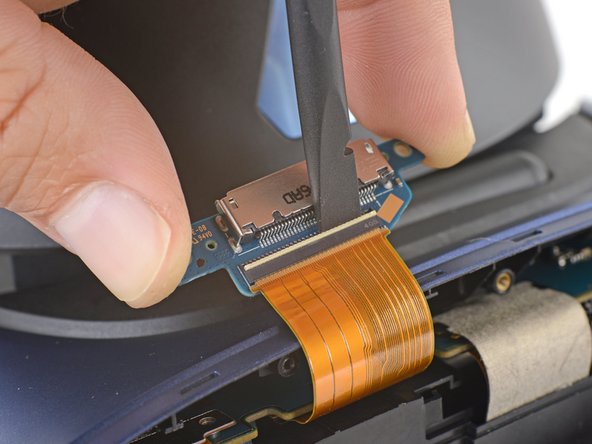

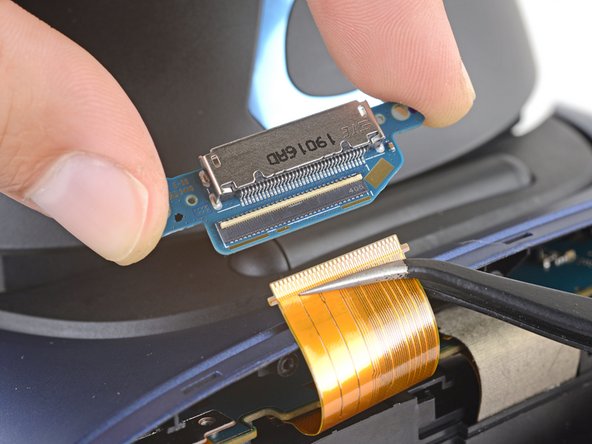

    • Use the flat end of a spudger to flip up the small locking flap securing the faceplate cable ZIF connector.
    • Carefully slide the faceplate connector cable straight out of its socket on the faceplate connector.
    • Remove the faceplate connector.
