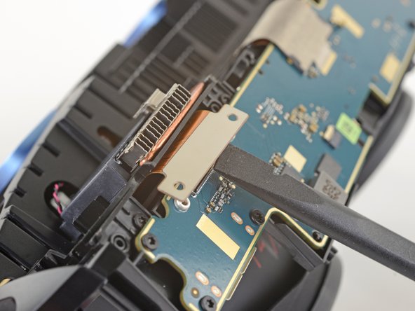

  21. HTC Vive Cosmos Daughterboard Replacement, Disconnect the LCD panels: crwdns2935265:021crwdnd2935265:01crwdnd2935265:01crwdne2935265:0
    • Use a T5 Torx driver to remove the four 2.9 mm long screws securing the LCD connectors.
  22. HTC Vive Cosmos Daughterboard Replacement: crwdns2935265:022crwdnd2935265:01crwdnd2935265:03crwdne2935265:0 HTC Vive Cosmos Daughterboard Replacement: crwdns2935265:022crwdnd2935265:02crwdnd2935265:03crwdne2935265:0 HTC Vive Cosmos Daughterboard Replacement: crwdns2935265:022crwdnd2935265:03crwdnd2935265:03crwdne2935265:0
    • Use the flat end of a spudger to pry the LCD connectors straight up and out of their sockets on the daughterboard.

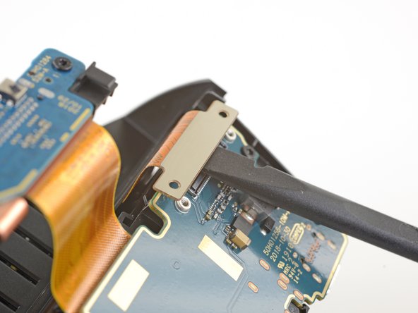

  23. HTC Vive Cosmos Daughterboard Replacement, Disconnect the interconnect cable: crwdns2935265:023crwdnd2935265:01crwdnd2935265:01crwdne2935265:0
    • Peel the tape over the motherboard interconnect cable back far enough to access the cable connector.
  24. HTC Vive Cosmos Daughterboard Replacement: crwdns2935265:024crwdnd2935265:01crwdnd2935265:03crwdne2935265:0 HTC Vive Cosmos Daughterboard Replacement: crwdns2935265:024crwdnd2935265:02crwdnd2935265:03crwdne2935265:0 HTC Vive Cosmos Daughterboard Replacement: crwdns2935265:024crwdnd2935265:03crwdnd2935265:03crwdne2935265:0
    • Use the flat end of a spudger to flip up the locking flap securing the interconnect cable ZIF connector.
    • Carefully slide the interconnect cable straight out of its socket.

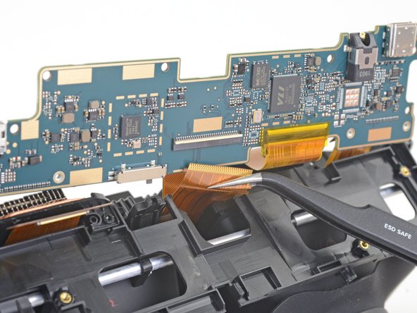

  25. HTC Vive Cosmos Daughterboard Replacement, Unscrew the daughterboard: crwdns2935265:025crwdnd2935265:01crwdnd2935265:01crwdne2935265:0
    • Use a T5 Torx driver to remove the six 4.1 mm long screws securing the daughterboard.

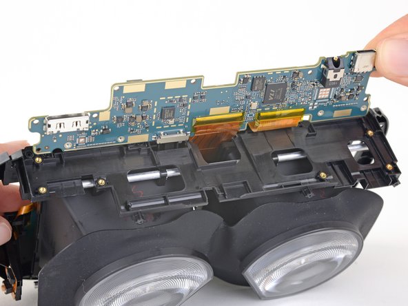

  26. HTC Vive Cosmos Daughterboard Replacement: crwdns2935265:026crwdnd2935265:01crwdnd2935265:02crwdne2935265:0 HTC Vive Cosmos Daughterboard Replacement: crwdns2935265:026crwdnd2935265:02crwdnd2935265:02crwdne2935265:0
    • Do not remove the daughterboard yet. It is still connected to the motherboard.
    • Gently hinge the daughterboard up to access the underside.

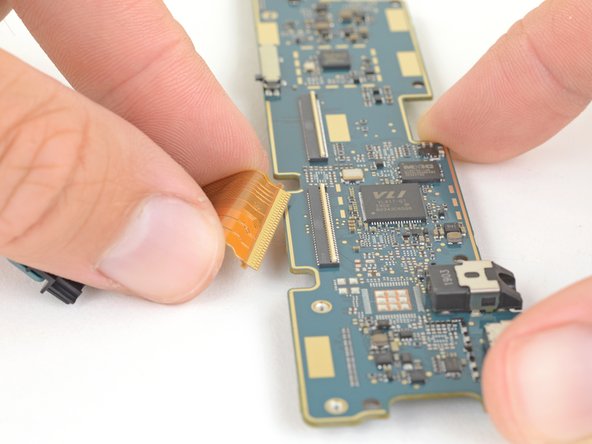

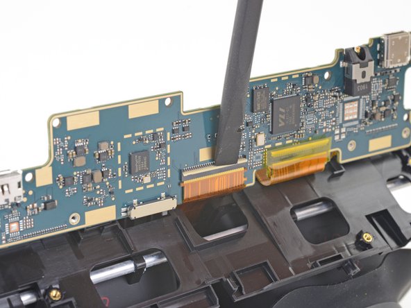

  27. HTC Vive Cosmos Daughterboard Replacement, Disconnect the second interconnect cable: crwdns2935265:027crwdnd2935265:01crwdnd2935265:01crwdne2935265:0
    • Peel the tape over the second motherboard interconnect cable back far enough to access the cable connector.

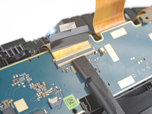

  28. HTC Vive Cosmos Daughterboard Replacement: crwdns2935265:028crwdnd2935265:01crwdnd2935265:03crwdne2935265:0 HTC Vive Cosmos Daughterboard Replacement: crwdns2935265:028crwdnd2935265:02crwdnd2935265:03crwdne2935265:0 HTC Vive Cosmos Daughterboard Replacement: crwdns2935265:028crwdnd2935265:03crwdnd2935265:03crwdne2935265:0
    • Use the flat end of a spudger to flip up the locking flap securing the second interconnect cable ZIF connector.
    • Carefully slide the second interconnect cable straight out of its socket.
    • Remove the daughterboard from the LCD and motherboard assembly.

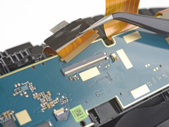

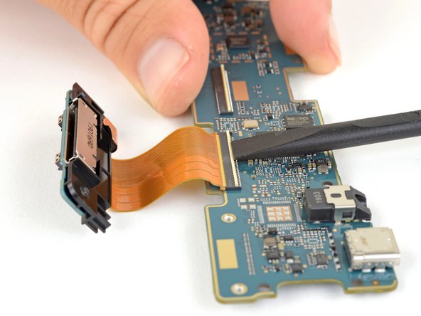

  29. HTC Vive Cosmos Daughterboard Replacement, Remove the faceplate connector and cable: crwdns2935265:029crwdnd2935265:01crwdnd2935265:01crwdne2935265:0
    • Peel the tape over the faceplate connector cable back far enough to access the ZIF connector on the daughterboard.
  30. HTC Vive Cosmos Daughterboard Replacement: crwdns2935265:030crwdnd2935265:01crwdnd2935265:03crwdne2935265:0 HTC Vive Cosmos Daughterboard Replacement: crwdns2935265:030crwdnd2935265:02crwdnd2935265:03crwdne2935265:0 HTC Vive Cosmos Daughterboard Replacement: crwdns2935265:030crwdnd2935265:03crwdnd2935265:03crwdne2935265:0
    • Use the flat end of a spudger to flip up the small locking flap securing the faceplate cable ZIF connector.
    • Carefully slide the faceplate connector cable straight out of its socket on the daughterboard.
  31. HTC Vive Cosmos Daughterboard Replacement, Remove the daughterboard: crwdns2935265:031crwdnd2935265:01crwdnd2935265:01crwdne2935265:0
    • Only the daughterboard remains.
