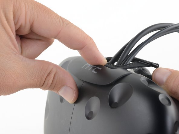

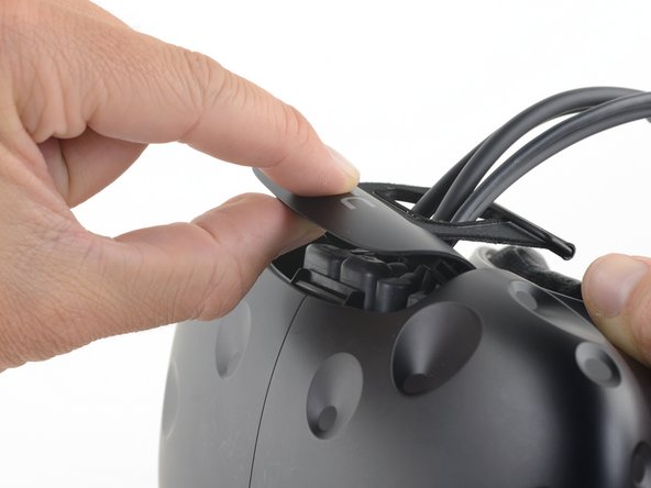

  3. HTC Vive Compartment Cover Assembly Replacement, Open the cable compartment: crwdns2935265:03crwdnd2935265:01crwdnd2935265:03crwdne2935265:0 HTC Vive Compartment Cover Assembly Replacement, Open the cable compartment: crwdns2935265:03crwdnd2935265:02crwdnd2935265:03crwdne2935265:0 HTC Vive Compartment Cover Assembly Replacement, Open the cable compartment: crwdns2935265:03crwdnd2935265:03crwdnd2935265:03crwdne2935265:0
    • Place a finger on the top edge of the compartment cover assembly and slide the assembly toward the front of the Vive until it comes loose from the headset.
    • Lift the cover away from the headset and slide it up the cables until it's out of the way.

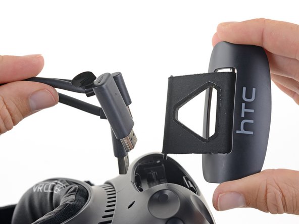

  4. HTC Vive Compartment Cover Assembly Replacement, Unplug the HDMI cable: crwdns2935265:04crwdnd2935265:01crwdnd2935265:02crwdne2935265:0 HTC Vive Compartment Cover Assembly Replacement, Unplug the HDMI cable: crwdns2935265:04crwdnd2935265:02crwdnd2935265:02crwdne2935265:0
    • Lift the HDMI cable straight up to unplug it from the headset.
  5. HTC Vive Compartment Cover Assembly Replacement, Unplug the remaining cables: crwdns2935265:05crwdnd2935265:01crwdnd2935265:03crwdne2935265:0 HTC Vive Compartment Cover Assembly Replacement, Unplug the remaining cables: crwdns2935265:05crwdnd2935265:02crwdnd2935265:03crwdne2935265:0 HTC Vive Compartment Cover Assembly Replacement, Unplug the remaining cables: crwdns2935265:05crwdnd2935265:03crwdnd2935265:03crwdne2935265:0
    • Repeat the lifting and unplugging process with the remaining USB, power, and audio cables.
  6. HTC Vive Compartment Cover Assembly Replacement, Remove the compartment cover assembly: crwdns2935265:06crwdnd2935265:01crwdnd2935265:02crwdne2935265:0 HTC Vive Compartment Cover Assembly Replacement, Remove the compartment cover assembly: crwdns2935265:06crwdnd2935265:02crwdnd2935265:02crwdne2935265:0
    • Carefully slide the compartment cover assembly over the plugs and remove it.
