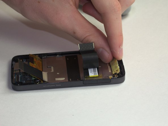

    • Remove the keyboard ribbon from the motherboard. To do this, simply grasp the ribbon at its base and pry it up at an angle. The ribbon has a metal end that is easily removed from the motherboard.

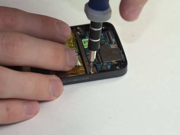

    • Using a Phillips Head size 0 screwdriver, remove the 3 screws holding in the battery compartment.
    • Remove the ribbon covering the battery compartment by pinching it at the base and lifting.

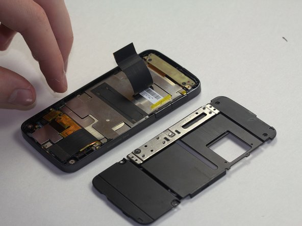

    • Pry the keyboard away from the screen. Open on the side containing the keyboard ribbon.

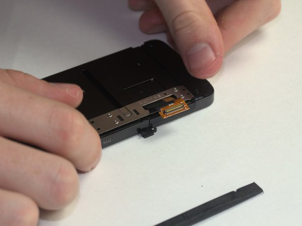

    • Pry the rear of the screen assembly off from the side opposite to the display ribbon using the spudger

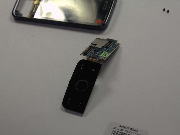

    • Remove the connected circuit board components behind the phone's navigation buttons.
    • Remove the four circuit board screws using the PH #0 screwdriver
  14. HTC Touch Pro CDMA Verizon Screen Replacement: crwdns2935265:014crwdnd2935265:01crwdnd2935265:02crwdne2935265:0 HTC Touch Pro CDMA Verizon Screen Replacement: crwdns2935265:014crwdnd2935265:02crwdnd2935265:02crwdne2935265:0
    • Push on the back of the board gently to remove the navigation buttons on the front.
    • Flip the phone to the front and remove the four screws holding the circuit board to the phone frame using the PH #0 screwdriver.
    • Replace the navigation buttons as necessary.

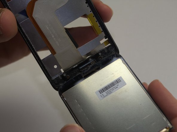

    • Push gently on the back of the screen to release the glue holding it to the phone frame.
    • Peel the screen from the frame to completely separate the two components.
    • The glue between the screen and the phone frame is the only piece holding the two components together at this step.
