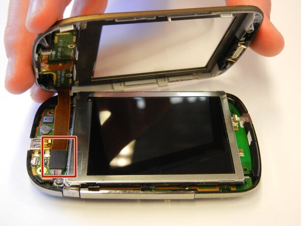

    4. HTC Touch Camera Lens Replacement: crwdns2935265:04crwdnd2935265:01crwdnd2935265:02crwdne2935265:0 HTC Touch Camera Lens Replacement: crwdns2935265:04crwdnd2935265:02crwdnd2935265:02crwdne2935265:0
      • Use the plastic opening tool to remove the front panel from the phone.
      • Place a spudger or an opening tool under the edge of the press connector and pry straight up to disconnect it.
      • Make sure to pry under the edge of the connector itself, and not under the socket on the board. Otherwise, you risk permanently damaging the socket.
      • To reconnect, align the connector carefully over its socket and press down with your fingertip—first on one of the short sides, then the other—until it clicks into place. Don't try to force the connector into place. If you're having trouble, reposition it and try again.

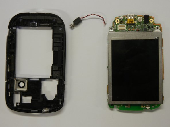

    6. HTC Touch Camera Lens Replacement: crwdns2935265:06crwdnd2935265:01crwdnd2935265:02crwdne2935265:0 HTC Touch Camera Lens Replacement: crwdns2935265:06crwdnd2935265:02crwdnd2935265:02crwdne2935265:0
      • Seperate the motherboard from the black plastic casing.
      • Unplug the black and red wire from the motherboard.
      • Unplug the black and red wire from the black plastic casing.
