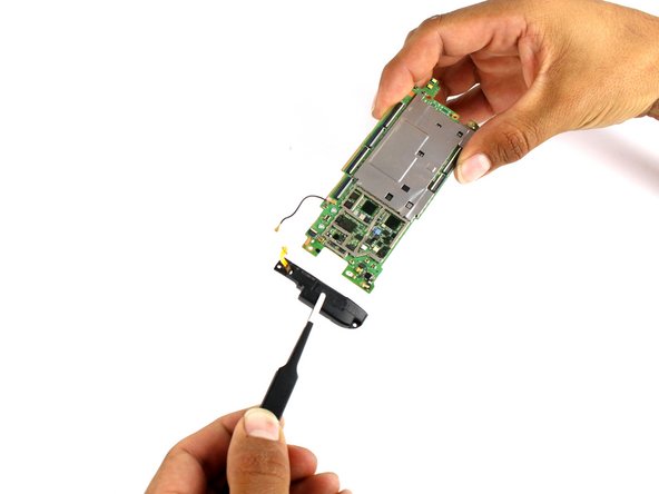

    1. HTC One M8 Bottom Speaker Replacement, Bottom Speaker: crwdns2935265:014crwdnd2935265:01crwdnd2935265:03crwdne2935265:0 HTC One M8 Bottom Speaker Replacement, Bottom Speaker: crwdns2935265:014crwdnd2935265:02crwdnd2935265:03crwdne2935265:0 HTC One M8 Bottom Speaker Replacement, Bottom Speaker: crwdns2935265:014crwdnd2935265:03crwdnd2935265:03crwdne2935265:0
      • Use an iOpener to loosen up the adhesive securing the bottom speaker to the motherboard.
      • Use a pair of tweezers to gently remove the bottom speaker from the motherboard.
