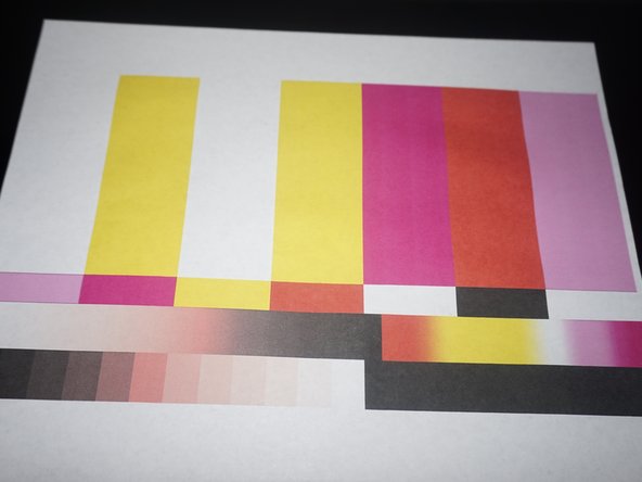

  3. HP/Canon - Printhead cleaning -- ink tank/printhead permanently installed (modular), Print a baseline image: crwdns2935265:03crwdnd2935265:01crwdnd2935265:01crwdne2935265:0
    • Print a test image as a baseline. A good image can be found here: SMPTE color bars.

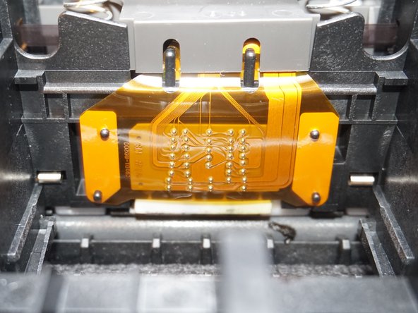

  6. HP/Canon - Printhead cleaning -- ink tank/printhead permanently installed (modular), Clean the printer contacts: crwdns2935265:06crwdnd2935265:01crwdnd2935265:02crwdne2935265:0 HP/Canon - Printhead cleaning -- ink tank/printhead permanently installed (modular), Clean the printer contacts: crwdns2935265:06crwdnd2935265:02crwdnd2935265:02crwdne2935265:0
    • THESE STEPS MAY NOT BE REQUIRED ON ALL PRINTERS. If your printhead contact is similar, it is recommended to clean it regardless of the printer manufacturer.
    • (HP ONLY) Failure to clean this area may result in a Ink System Failure warning, and a lost calibration.
    • Using an alcohol wipe, clean the printhead interface to avoid any errors relating to poor printhead contact.

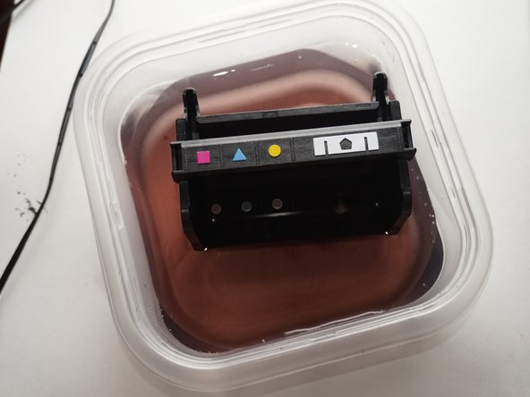

  7. HP/Canon - Printhead cleaning -- ink tank/printhead permanently installed (modular), Clean the printhead: crwdns2935265:07crwdnd2935265:01crwdnd2935265:02crwdne2935265:0 HP/Canon - Printhead cleaning -- ink tank/printhead permanently installed (modular), Clean the printhead: crwdns2935265:07crwdnd2935265:02crwdnd2935265:02crwdne2935265:0
    • Alcohol should only be used as a last resort as it can damage the printhead seals! If you use alcohol, 3 water flushes are needed to purge the printhead fully!
    • Recommended circulation times: Alcohol: 5-10 minutes. Without alcohol: 15 minutes.
    • The water will get lighter as the ink breaks down, this is normal. If your clog is stubborn, an ultrasonic cleaner may help break it down.
    • Put the printhead in hot water. Repeat until the printhead is reasonably clean. Change the cleaning water frequently.
    • Wipe the printhead contacts and nozzles by hand to ensure these areas are dry.
    • Before reinstalling the printhead, let it air dry for ~3-4 hours. Using a fan may speed this step up.

    • After replacing the printhead, test the printer. Match the previous settings and check for improvement.
If your printer is working correctly, it was just a clog. Persistent issues usually total out the printer as a unit.
