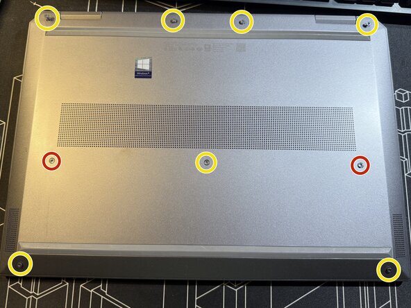

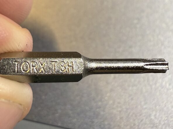

    • Close your laptop and turn it over so that the side without the HP logo is facing you.
    • Using the TR8 bit, loosen the quantity nine screws from the base of the device.
    • These screws are captive and do not require complete removal from base enclosure. Instead, simply loosen the screws and proceed to the next step.
    • If screws are removed, take note that two of the screws [circled in Red] are shorter than the rest.
    • Carefully separate the rear edge (near hinges) and sides of the base enclosure from the top cover using plastic prying tool [see linked HP instructional video].
    • Slide the base enclosure toward the rear of the laptop and remove.

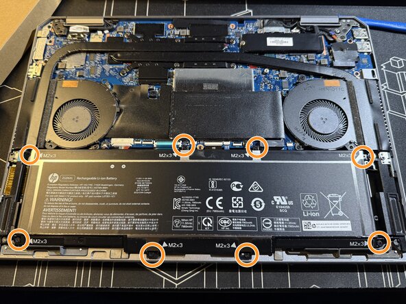

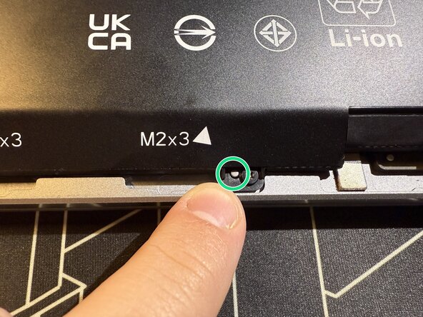

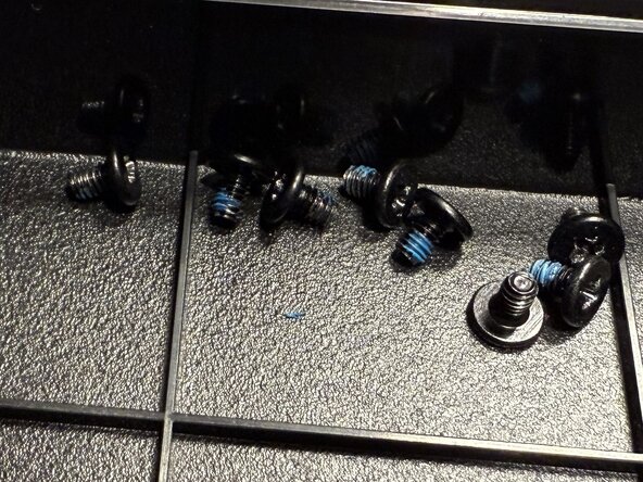

  2. HP ZBook STUDIO X360 G5 Battery Replacement, Remove Battery-Mount Screws: crwdns2935265:02crwdnd2935265:01crwdnd2935265:02crwdne2935265:0 HP ZBook STUDIO X360 G5 Battery Replacement, Remove Battery-Mount Screws: crwdns2935265:02crwdnd2935265:02crwdnd2935265:02crwdne2935265:0
    • While the base enclosure is removed, take the time to clean your laptop internals with a can of compressed air or an electronic air duster.
    • Remove the quantity eight "M2x3" screws using a PH1 screwdriver.
    • There are arrows next to the labels that will help you identify the screws.

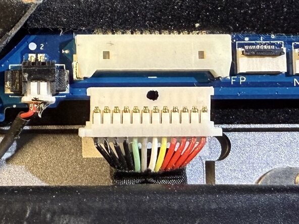

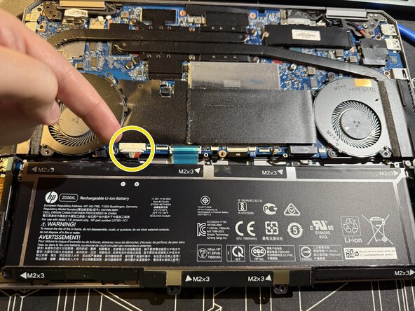

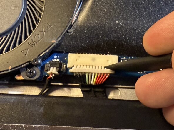

  3. HP ZBook STUDIO X360 G5 Battery Replacement, Disconnect Battery Connector: crwdns2935265:03crwdnd2935265:01crwdnd2935265:03crwdne2935265:0 HP ZBook STUDIO X360 G5 Battery Replacement, Disconnect Battery Connector: crwdns2935265:03crwdnd2935265:02crwdnd2935265:03crwdne2935265:0 HP ZBook STUDIO X360 G5 Battery Replacement, Disconnect Battery Connector: crwdns2935265:03crwdnd2935265:03crwdnd2935265:03crwdne2935265:0
    • Partially removing the battery might help in accessing the battery connector.
    • The 12-pin battery connector can be found just above the + and - symbols on the battery.
    • Use a spudger to gently pull the corners of the connector away from the white connector housing.
    • Alternate working each corner to avoid damaging the connector.

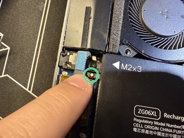

    • Gently place replacement battery into laptop, ensuring that the quantity two gray alignment pegs are properly seated in their respective mounting holes on the battery.
