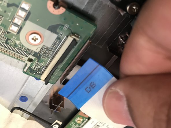

  5. HP Stream 13-c010nr USB Port Replacement, USB Port: crwdns2935265:05crwdnd2935265:01crwdnd2935265:02crwdne2935265:0 HP Stream 13-c010nr USB Port Replacement, USB Port: crwdns2935265:05crwdnd2935265:02crwdnd2935265:02crwdne2935265:0
    • Use a spudger to flip up the retaining flap on the USB port ribbon cable ZIF socket.
    • Pull the ribbon cable out of the socket.

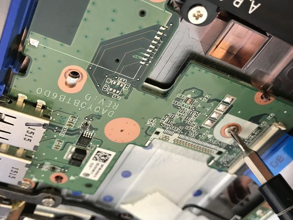

  6. HP Stream 13-c010nr USB Port Replacement: crwdns2935265:06crwdnd2935265:01crwdnd2935265:02crwdne2935265:0 HP Stream 13-c010nr USB Port Replacement: crwdns2935265:06crwdnd2935265:02crwdnd2935265:02crwdne2935265:0
    • Remove the three 3mm Phillips #0 screws from the USB port.
    • Pull out the USB port.
  7. HP Stream 13-c010nr USB Port Replacement: crwdns2935265:07crwdnd2935265:01crwdnd2935265:01crwdne2935265:0
    • Remove the chip containing the two USB Ports.
