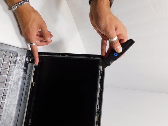

    • Insert a spudger in between the bezel and display, at the top.
    • Move the tool around all sides of the bezel.
    • With your finger, lift the inside part of the bezel.
    • Pull the bezel back; it will pop-off.

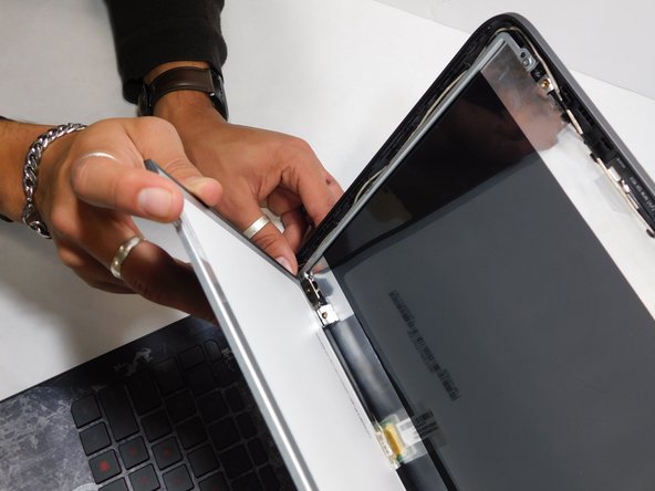

    • Remove the four 2.75 mm screws using a Phillips #1 screwdriver
    • Lift the screen using a spudger.

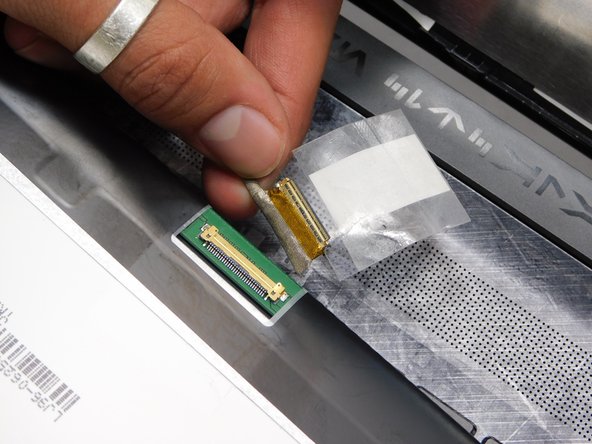

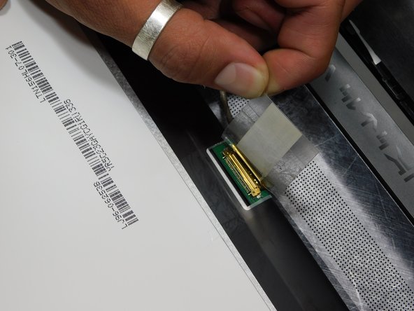

    • Lifting the tape on the back of the screen and peel it off.
    • Remove the connection.
  5. HP Star Wars Special Edition 15-an051dx Screen Replacement: crwdns2935265:05crwdnd2935265:01crwdnd2935265:03crwdne2935265:0 HP Star Wars Special Edition 15-an051dx Screen Replacement: crwdns2935265:05crwdnd2935265:02crwdnd2935265:03crwdne2935265:0 HP Star Wars Special Edition 15-an051dx Screen Replacement: crwdns2935265:05crwdnd2935265:03crwdnd2935265:03crwdne2935265:0
    • Connect the new screen using the 30 pin cable.
    • Put the screen in place.
