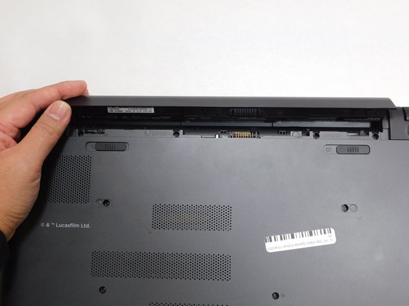

    • In the red is the battery and the battery's holding/locking latches.
    • Slide the latches in the direction the arrows face. This will unlock and release the battery.
    • Set the old battery aside or dispose of properly by following the manufacturers instructions written on the battery or check online of battery disposal services.

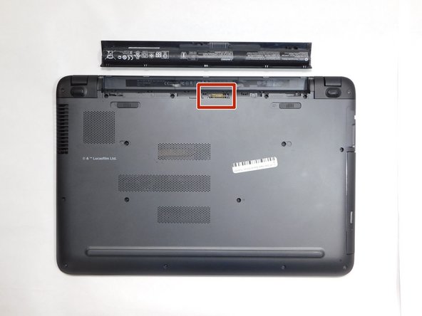

  3. HP Star Wars Special Edition 15-an051dx Battery Replacement: crwdns2935265:03crwdnd2935265:01crwdnd2935265:03crwdne2935265:0 HP Star Wars Special Edition 15-an051dx Battery Replacement: crwdns2935265:03crwdnd2935265:02crwdnd2935265:03crwdne2935265:0 HP Star Wars Special Edition 15-an051dx Battery Replacement: crwdns2935265:03crwdnd2935265:03crwdnd2935265:03crwdne2935265:0
    • Check the battery port on your device and make sure it is clear of debris and pins are not bent or damaged.
    • Install the new battery into the port and press down gently.
    • Make sure it latches on to its locking clip.
    • Once installed and you have followed the battery manufacturer's instructions, turn your device on to its upright position and boot your device.
Device should be working as usual with the new battery.
