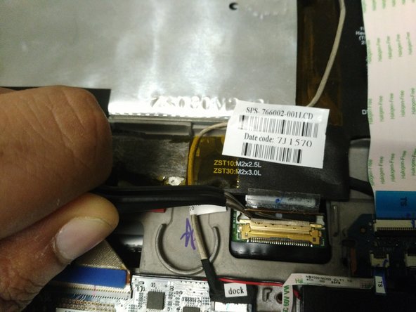

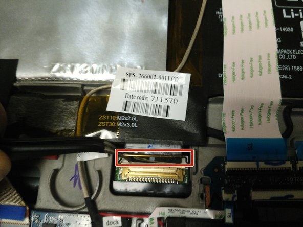

  7. HP Split 13-r010dx Screen Replacement: crwdns2935265:07crwdnd2935265:01crwdnd2935265:03crwdne2935265:0 HP Split 13-r010dx Screen Replacement: crwdns2935265:07crwdnd2935265:02crwdnd2935265:03crwdne2935265:0 HP Split 13-r010dx Screen Replacement: crwdns2935265:07crwdnd2935265:03crwdnd2935265:03crwdne2935265:0
    • Use a pair of tweezers to pull up the yellow colored display cable connector.
    • Pull it to the direction of the cable.
