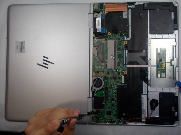

  4. HP Spectre x360 13-ac023dx Display Replacement, Display: crwdns2935265:04crwdnd2935265:01crwdnd2935265:01crwdne2935265:0
    • Lay the laptop flat on the table with the keyboard side facing the table and the motherboard facing up.

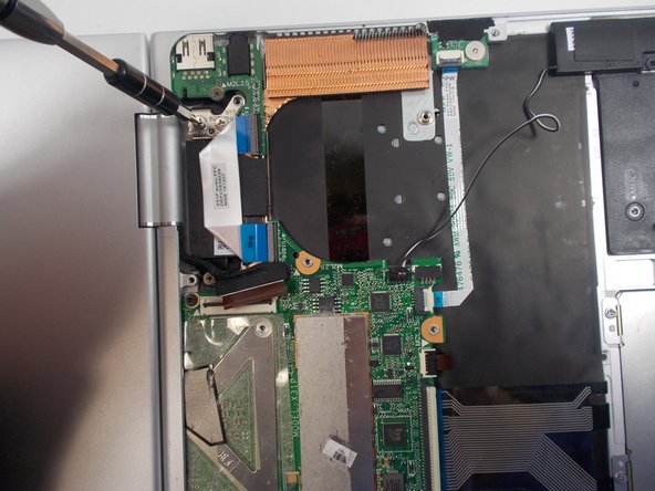

  5. HP Spectre x360 13-ac023dx Display Replacement: crwdns2935265:05crwdnd2935265:01crwdnd2935265:03crwdne2935265:0 HP Spectre x360 13-ac023dx Display Replacement: crwdns2935265:05crwdnd2935265:02crwdnd2935265:03crwdne2935265:0 HP Spectre x360 13-ac023dx Display Replacement: crwdns2935265:05crwdnd2935265:03crwdnd2935265:03crwdne2935265:0
    • Using the Phillips #000 screwdriver, remove the four 1.0 mm screws that attach the display to the main body of the computer.

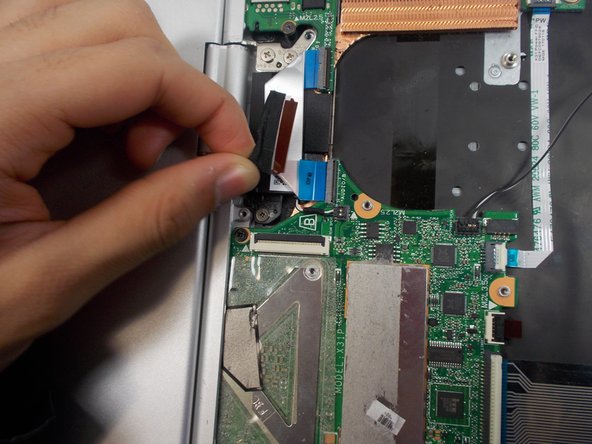

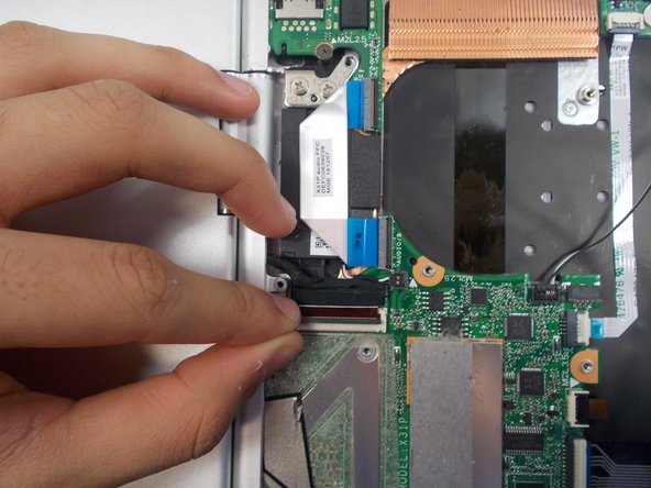

  6. HP Spectre x360 13-ac023dx Display Replacement: crwdns2935265:06crwdnd2935265:01crwdnd2935265:03crwdne2935265:0 HP Spectre x360 13-ac023dx Display Replacement: crwdns2935265:06crwdnd2935265:02crwdnd2935265:03crwdne2935265:0 HP Spectre x360 13-ac023dx Display Replacement: crwdns2935265:06crwdnd2935265:03crwdnd2935265:03crwdne2935265:0
    • Move the metal components that were just unscrewed out of the way to make a clear view of the two display connectors.
    • Flip up both latches that are found at the center of the computer's body where the wires connect to the motherboard. Then release the wires that attach to the display. This will separate the two main parts of the computer.

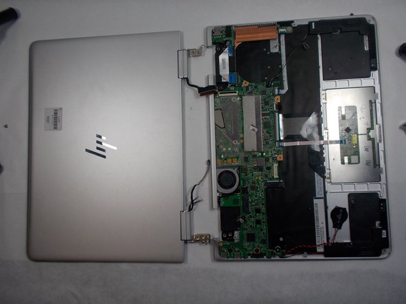

  7. HP Spectre x360 13-ac023dx Display Replacement: crwdns2935265:07crwdnd2935265:01crwdnd2935265:02crwdne2935265:0 HP Spectre x360 13-ac023dx Display Replacement: crwdns2935265:07crwdnd2935265:02crwdnd2935265:02crwdne2935265:0
    • Separate the display from the bottom half of the computer(motherboard).

I couldn’t remove the display without removing the one speaker. In the pictures, you can easily see that he just bent the metal case at the hinge and pried it out.
