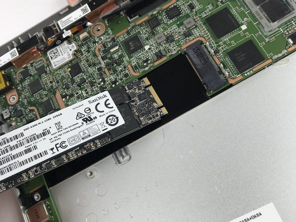

  5. HP Spectre x2 12-a002dx SSD Replacement, SSD: crwdns2935265:06crwdnd2935265:01crwdnd2935265:01crwdne2935265:0
    • Once you have successfully removed the screen, locate the solid state drive (SSD).
  6. HP Spectre x2 12-a002dx SSD Replacement: crwdns2935265:07crwdnd2935265:01crwdnd2935265:01crwdne2935265:0
    • Unscrew the PM2.0x2.5 screw on the SSD using a JIS00 screwdriver.
    • Store the screw in a safe place. You will need it to secure the replacement SSD in place.
  7. HP Spectre x2 12-a002dx SSD Replacement: crwdns2935265:08crwdnd2935265:01crwdnd2935265:01crwdne2935265:0
    • Next, carefully peel the sticker on top of the SSD off.
  8. HP Spectre x2 12-a002dx SSD Replacement: crwdns2935265:09crwdnd2935265:01crwdnd2935265:02crwdne2935265:0 HP Spectre x2 12-a002dx SSD Replacement: crwdns2935265:09crwdnd2935265:02crwdnd2935265:02crwdne2935265:0
    • Carefully, pull the SSD out of the slot at an angle.

it would be nice if you listed the compatible ssds… key, interface, etc.
Alec Kristi - crwdns2934203:0crwdne2934203:0
it is a m.2 interface and it compatible with all 2280 size drives
