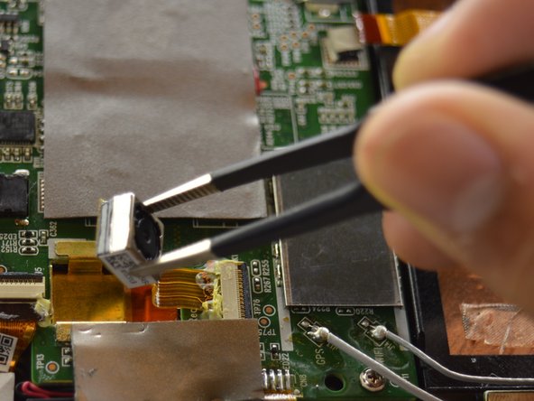

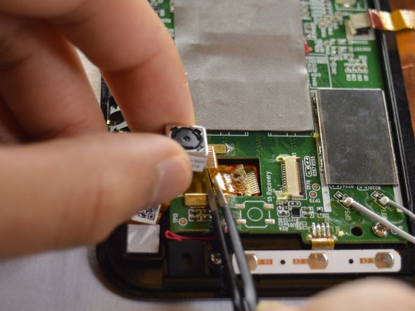

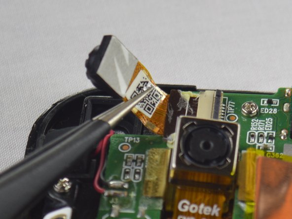

  6. HP Slate 7 Plus 4200US LCD Screen Replacement, Front Facing Webcamera: crwdns2935265:06crwdnd2935265:01crwdnd2935265:02crwdne2935265:0 HP Slate 7 Plus 4200US LCD Screen Replacement, Front Facing Webcamera: crwdns2935265:06crwdnd2935265:02crwdnd2935265:02crwdne2935265:0
    • Use tweezers to remove the black foam stickers from the front facing camera to expose the wiring.
  7. HP Slate 7 Plus 4200US LCD Screen Replacement: crwdns2935265:07crwdnd2935265:01crwdnd2935265:02crwdne2935265:0 HP Slate 7 Plus 4200US LCD Screen Replacement: crwdns2935265:07crwdnd2935265:02crwdnd2935265:02crwdne2935265:0
    • Lift the camera out from system board and firmly pull the wire out from the connector.

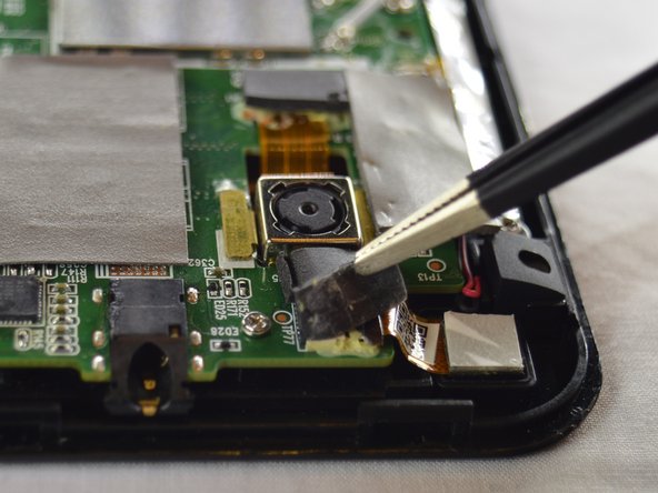

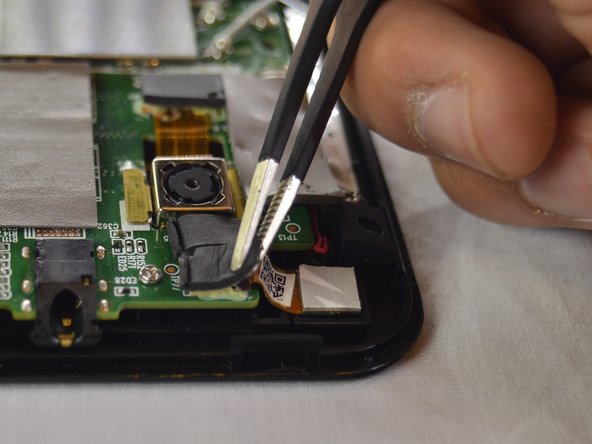

  8. HP Slate 7 Plus 4200US LCD Screen Replacement, Rear Facing Webcamera: crwdns2935265:08crwdnd2935265:01crwdnd2935265:02crwdne2935265:0 HP Slate 7 Plus 4200US LCD Screen Replacement, Rear Facing Webcamera: crwdns2935265:08crwdnd2935265:02crwdnd2935265:02crwdne2935265:0
    • Use the tweezers to remove the black foam stickers from the rear facing camera to expose the wiring.
  9. HP Slate 7 Plus 4200US LCD Screen Replacement: crwdns2935265:09crwdnd2935265:01crwdnd2935265:02crwdne2935265:0 HP Slate 7 Plus 4200US LCD Screen Replacement: crwdns2935265:09crwdnd2935265:02crwdnd2935265:02crwdne2935265:0
    • Using tweezers, lift the camera out from system board.
  10. HP Slate 7 Plus 4200US LCD Screen Replacement: crwdns2935265:010crwdnd2935265:01crwdnd2935265:02crwdne2935265:0 HP Slate 7 Plus 4200US LCD Screen Replacement: crwdns2935265:010crwdnd2935265:02crwdnd2935265:02crwdne2935265:0
    • Use tweezers to pull the wire out from the connector. Pull away from the connector, parallel to the tablet.

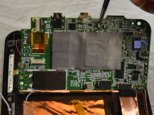

  11. HP Slate 7 Plus 4200US LCD Screen Replacement, System Board: crwdns2935265:011crwdnd2935265:01crwdnd2935265:01crwdne2935265:0
    • Remove the four screws from the motherboard using a Phillips 00 screwdriver.
  12. HP Slate 7 Plus 4200US LCD Screen Replacement: crwdns2935265:012crwdnd2935265:01crwdnd2935265:01crwdne2935265:0
    • Remove the two grey wires on the left and the four multicolored wires on the right by desoldering them. See iFixit guide on how to solder.
    • The multicolored wires are in soldered in order from top to bottom in the following order: yellow, grey, black, and red.
  13. HP Slate 7 Plus 4200US LCD Screen Replacement: crwdns2935265:013crwdnd2935265:01crwdnd2935265:01crwdne2935265:0
    • Disconnect the LCD wire from the connector by pulling away from the connector, parallel to the tablet.
  14. HP Slate 7 Plus 4200US LCD Screen Replacement: crwdns2935265:014crwdnd2935265:01crwdnd2935265:02crwdne2935265:0 HP Slate 7 Plus 4200US LCD Screen Replacement: crwdns2935265:014crwdnd2935265:02crwdnd2935265:02crwdne2935265:0
    • Using tweezers, lift the system board and remove it.

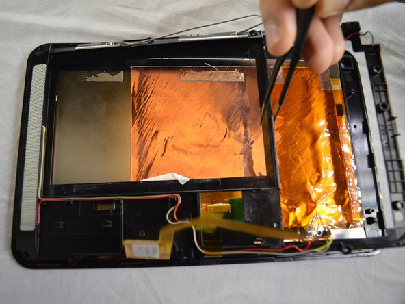

  15. HP Slate 7 Plus 4200US LCD Screen Replacement, Speaker: crwdns2935265:015crwdnd2935265:01crwdnd2935265:01crwdne2935265:0
    • Unscrew 8 screw using a Phillips 00 screwdriver.
  16. HP Slate 7 Plus 4200US LCD Screen Replacement: crwdns2935265:016crwdnd2935265:01crwdnd2935265:02crwdne2935265:0 HP Slate 7 Plus 4200US LCD Screen Replacement: crwdns2935265:016crwdnd2935265:02crwdnd2935265:02crwdne2935265:0
    • Grab the center of the plastic frame, which has the speaker, and lift to remove it.

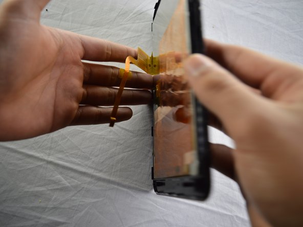

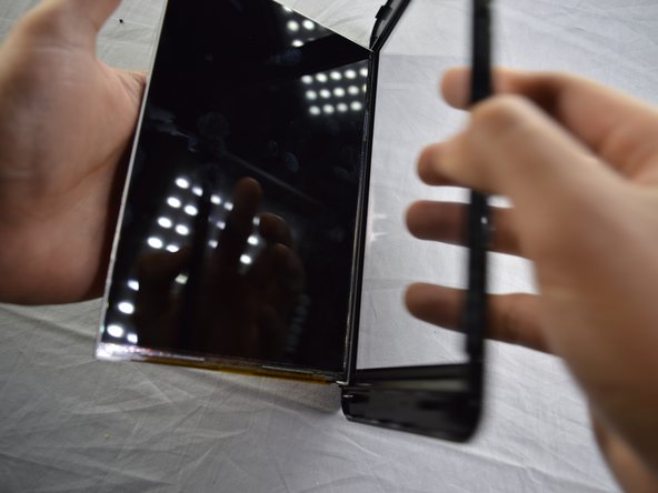

  17. HP Slate 7 Plus 4200US LCD Screen Replacement, LCD Screen: crwdns2935265:017crwdnd2935265:01crwdnd2935265:03crwdne2935265:0 HP Slate 7 Plus 4200US LCD Screen Replacement, LCD Screen: crwdns2935265:017crwdnd2935265:02crwdnd2935265:03crwdne2935265:0 HP Slate 7 Plus 4200US LCD Screen Replacement, LCD Screen: crwdns2935265:017crwdnd2935265:03crwdnd2935265:03crwdne2935265:0
    • Remove the screen by holding the tablet in one hand with the back of the LCD screen facing up. Slowly rotate the tablet so the screen falls into your other hand.
