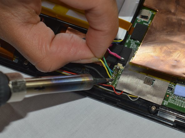

    1. HP Slate 7 Plus 4200US Battery Replacement, Battery: crwdns2935265:04crwdnd2935265:01crwdnd2935265:03crwdne2935265:0 HP Slate 7 Plus 4200US Battery Replacement, Battery: crwdns2935265:04crwdnd2935265:02crwdnd2935265:03crwdne2935265:0 HP Slate 7 Plus 4200US Battery Replacement, Battery: crwdns2935265:04crwdnd2935265:03crwdnd2935265:03crwdne2935265:0
      • Disconnect the battery cables from the system board by desoldering them. See iFixit guide on how to solder.
      • The battery cables are soldered to the system in the following sequence, top to bottom: red, blue, green, yellow, black.
    2. HP Slate 7 Plus 4200US Battery Replacement: crwdns2935265:05crwdnd2935265:01crwdnd2935265:03crwdne2935265:0 HP Slate 7 Plus 4200US Battery Replacement: crwdns2935265:05crwdnd2935265:02crwdnd2935265:03crwdne2935265:0 HP Slate 7 Plus 4200US Battery Replacement: crwdns2935265:05crwdnd2935265:03crwdnd2935265:03crwdne2935265:0
      • Insert a nylon spudger between the battery and the display panel assembly. Carefully pry the battery up and remove it from its place.
      • The battery is attached to the display panel assembly with double-sided adhesive. Make sure to firmly pull the battery.
      • The regular black nylon spudger should be used whenever possible, especially around batteries.
