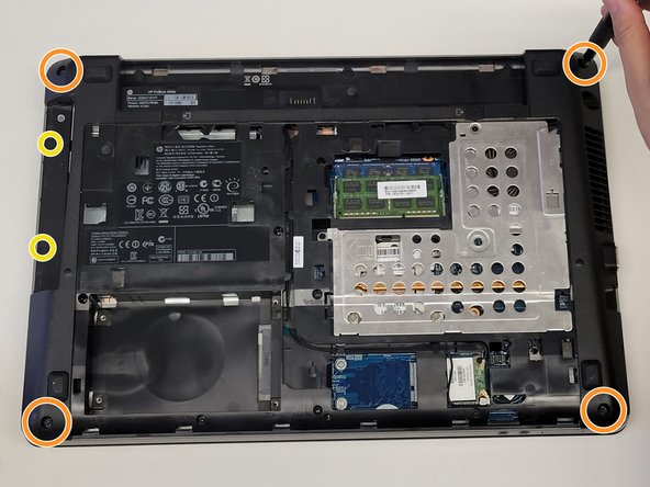

  5. HP Probook 4540s BIOS Chip Replacement: crwdns2935265:05crwdnd2935265:01crwdnd2935265:02crwdne2935265:0 HP Probook 4540s BIOS Chip Replacement: crwdns2935265:05crwdnd2935265:02crwdnd2935265:02crwdne2935265:0
    • Use the spudger to remove four rubber screw covers from the corners of the laptop.
    • Remove four 6.0 mm Torx T8 M2.5×6.0 screws from the corners of the computer.
    • Remove two 2.5 mm Phillips PM2.0×2.5 screws from the optical drive bay.

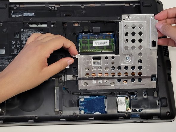

    • Remove three 6.0 mm Phillips PM2.5×6.0 screws that secure the heat shield to the computer.
    • Slightly slide the heat shield to the left and lift it away from the computer.
    • The centermost screw on the heat shield is the final screw securing the keyboard in place.

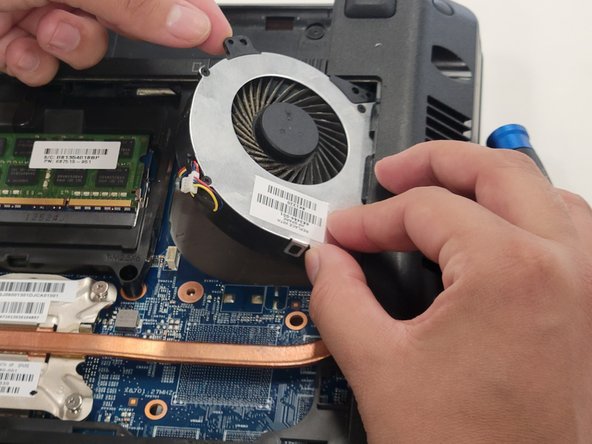

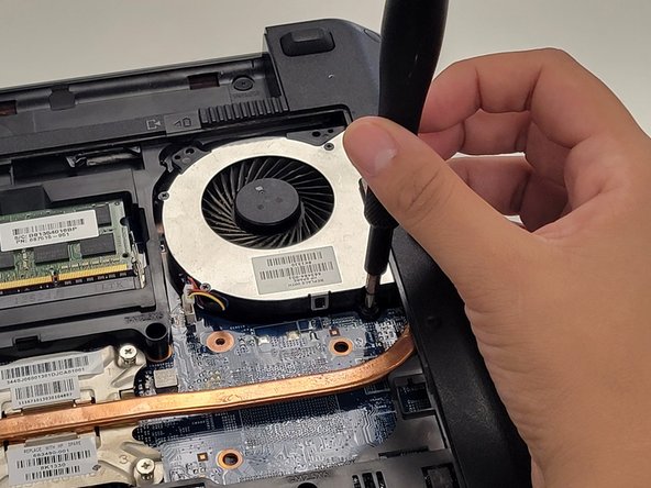

  10. HP Probook 4540s BIOS Chip Replacement: crwdns2935265:010crwdnd2935265:01crwdnd2935265:03crwdne2935265:0 HP Probook 4540s BIOS Chip Replacement: crwdns2935265:010crwdnd2935265:02crwdnd2935265:03crwdne2935265:0 HP Probook 4540s BIOS Chip Replacement: crwdns2935265:010crwdnd2935265:03crwdnd2935265:03crwdne2935265:0
    • Disconnect the fan cable from the system board.
    • Remove one 5.0 mm Phillips PM2.5×5.0 screw that secures the fan to the system board.
    • Lift the fan and remove it at an angle.

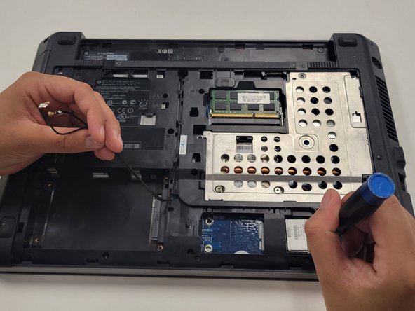

  11. HP Probook 4540s BIOS Chip Replacement: crwdns2935265:011crwdnd2935265:01crwdnd2935265:03crwdne2935265:0 HP Probook 4540s BIOS Chip Replacement: crwdns2935265:011crwdnd2935265:02crwdnd2935265:03crwdne2935265:0 HP Probook 4540s BIOS Chip Replacement: crwdns2935265:011crwdnd2935265:03crwdnd2935265:03crwdne2935265:0

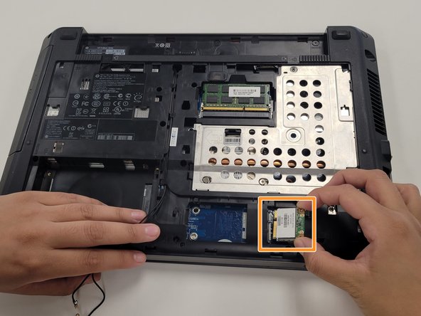

    • Disconnect the 2 WLAN coaxial antenna cables from the terminals on the WLAN module by carefully prying up the connectors using your spudger or your hands
    • Remove the two 3.0 mm Phillips PM2.0×3.0 screws that secure the WLAN module.
    • Remove the WLAN module by pulling away to the right.

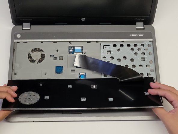

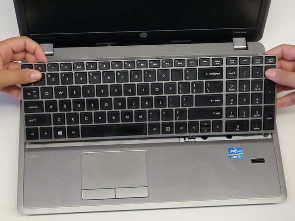

  12. HP Probook 4540s BIOS Chip Replacement: crwdns2935265:012crwdnd2935265:01crwdnd2935265:02crwdne2935265:0 HP Probook 4540s BIOS Chip Replacement: crwdns2935265:012crwdnd2935265:02crwdnd2935265:02crwdne2935265:0
    • The keyboard has a cable connected to the system board. Before lifting the keyboard completely off the laptop, disconnect the ribbon cable. We show this process in the next step.
    • Place the computer right-side up.
    • Place your hands over the keyboard, gently press down, and slide the keyboard towards yourself.
    • Gently pry the keyboard from the top.
    • Lift at an angle and only detach enough so you do not inadvertently detach the keyboard cable.

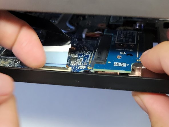

  13. HP Probook 4540s BIOS Chip Replacement: crwdns2935265:013crwdnd2935265:01crwdnd2935265:03crwdne2935265:0 HP Probook 4540s BIOS Chip Replacement: crwdns2935265:013crwdnd2935265:02crwdnd2935265:03crwdne2935265:0 HP Probook 4540s BIOS Chip Replacement: crwdns2935265:013crwdnd2935265:03crwdnd2935265:03crwdne2935265:0
    • Rotate the keyboard until it rests on the palm rest.
    • Disconnect the keyboard cable by lifting the keyboard connector latch and then disconnecting the keyboard cable from the system board.

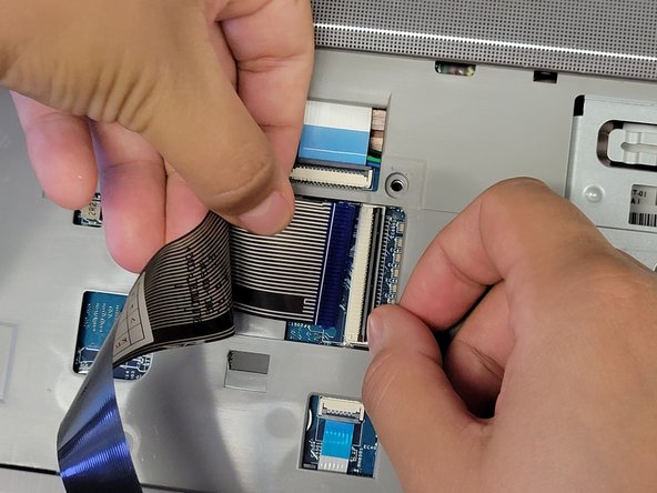

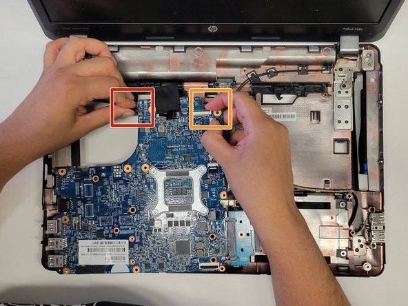

  14. HP Probook 4540s BIOS Chip Replacement: crwdns2935265:014crwdnd2935265:01crwdnd2935265:02crwdne2935265:0 HP Probook 4540s BIOS Chip Replacement: crwdns2935265:014crwdnd2935265:02crwdnd2935265:02crwdne2935265:0

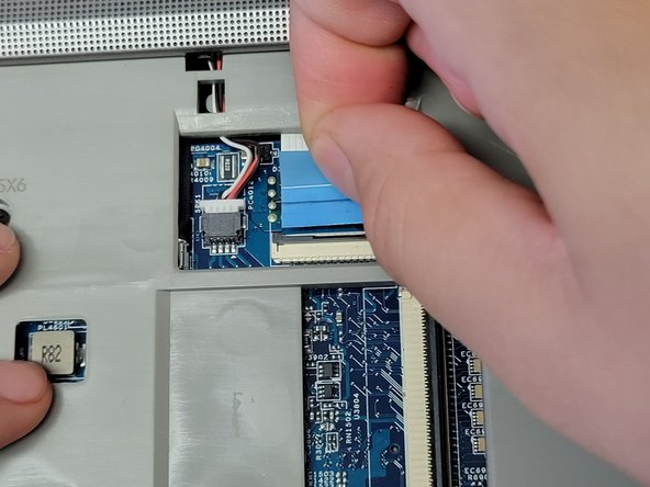

    • Disconnect the power button board cable by lifting the connector latch.
    • Using the blue tab, disconnect the cable from the system board.

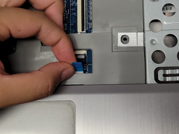

  15. HP Probook 4540s BIOS Chip Replacement: crwdns2935265:015crwdnd2935265:01crwdnd2935265:02crwdne2935265:0 HP Probook 4540s BIOS Chip Replacement: crwdns2935265:015crwdnd2935265:02crwdnd2935265:02crwdne2935265:0
    • Disconnect the fingerprint reader board cable by lifting the keyboard connector latch.

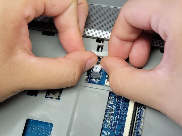

  16. HP Probook 4540s BIOS Chip Replacement: crwdns2935265:016crwdnd2935265:01crwdnd2935265:02crwdne2935265:0 HP Probook 4540s BIOS Chip Replacement: crwdns2935265:016crwdnd2935265:02crwdnd2935265:02crwdne2935265:0
    • Use your thumbs to push and disconnect the speaker cable from the system board.

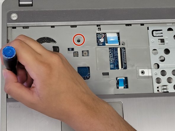

  17. HP Probook 4540s BIOS Chip Replacement: crwdns2935265:017crwdnd2935265:01crwdnd2935265:02crwdne2935265:0 HP Probook 4540s BIOS Chip Replacement: crwdns2935265:017crwdnd2935265:02crwdnd2935265:02crwdne2935265:0
    • Remove the two 6.0 mm Torx T8 M2.5×6.0 screws that secure the top cover to the computer.

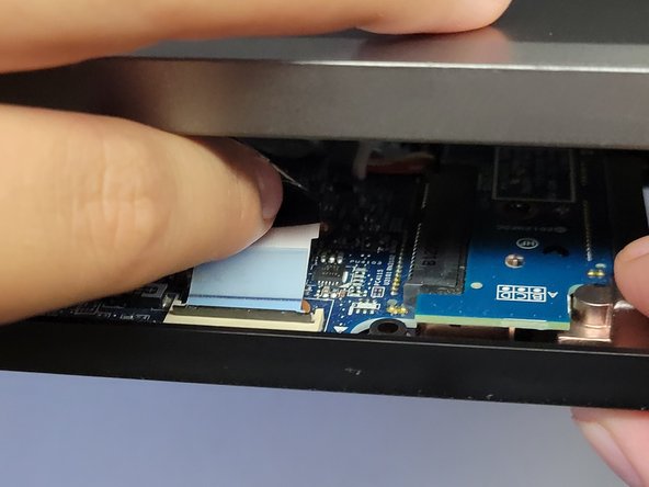

  18. HP Probook 4540s BIOS Chip Replacement: crwdns2935265:018crwdnd2935265:01crwdnd2935265:03crwdne2935265:0 HP Probook 4540s BIOS Chip Replacement: crwdns2935265:018crwdnd2935265:02crwdnd2935265:03crwdne2935265:0 HP Probook 4540s BIOS Chip Replacement: crwdns2935265:018crwdnd2935265:03crwdnd2935265:03crwdne2935265:0
    • Using the spudger, pry between the top cover and bottom cover of the computer.
    • Be sure not to open it up fully because the touchpad cable is connected to the system board.
    • Remove the touchpad cable by lifting the latch and pulling on the blue tab.

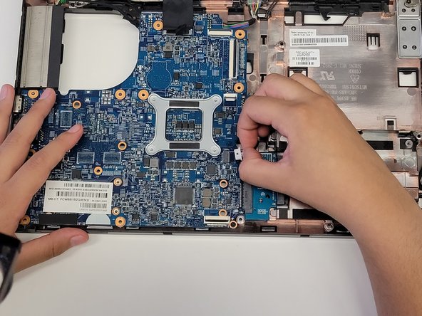

    • Remove four 4.5 mm Phillips PM2.5×4.5 screws that secure the system board to the computer.
  20. HP Probook 4540s BIOS Chip Replacement: crwdns2935265:020crwdnd2935265:01crwdnd2935265:02crwdne2935265:0 HP Probook 4540s BIOS Chip Replacement: crwdns2935265:020crwdnd2935265:02crwdnd2935265:02crwdne2935265:0
    • Unplug the USB connector cable by pinching the edge of the connector and pulling it away from the system board.
  21. HP Probook 4540s BIOS Chip Replacement: crwdns2935265:021crwdnd2935265:01crwdnd2935265:03crwdne2935265:0 HP Probook 4540s BIOS Chip Replacement: crwdns2935265:021crwdnd2935265:02crwdnd2935265:03crwdne2935265:0 HP Probook 4540s BIOS Chip Replacement: crwdns2935265:021crwdnd2935265:03crwdnd2935265:03crwdne2935265:0

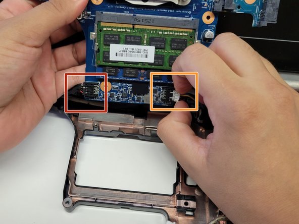

    • Disconnect the display cable by pinching the attached black tab and pulling it straight up.
    • Disconnect the power cable by pinching the cable firmly and pulling away from the connector.
    • Disconnect the battery connector cable by pinching the cable firmly and pulling away from the connector.
    • The system board can be removed from the back cover of the computer to access the power and battery connector cables more easily. (refer to the third picture)

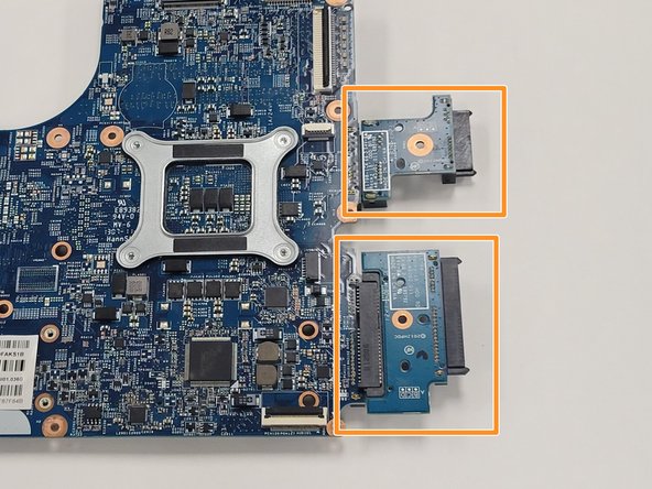

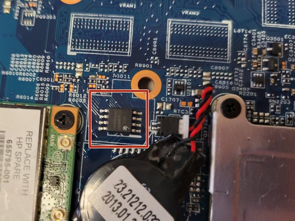

  22. HP Probook 4540s BIOS Chip Replacement: crwdns2935265:022crwdnd2935265:01crwdnd2935265:03crwdne2935265:0 HP Probook 4540s BIOS Chip Replacement: crwdns2935265:022crwdnd2935265:02crwdnd2935265:03crwdne2935265:0 HP Probook 4540s BIOS Chip Replacement: crwdns2935265:022crwdnd2935265:03crwdnd2935265:03crwdne2935265:0
    • Once the system board is no longer attached to the computer, place it on a flat surface as shown in the picture.
    • Flip the system board over.
    • The BIOS chip is located at the bottom of the system board near the RTC battery.
    • Optional Step: The optical drive extension board and the hard drive extension board can be removed from the system board.

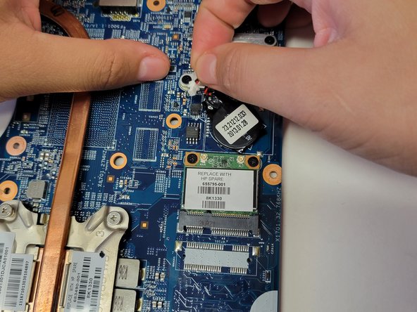

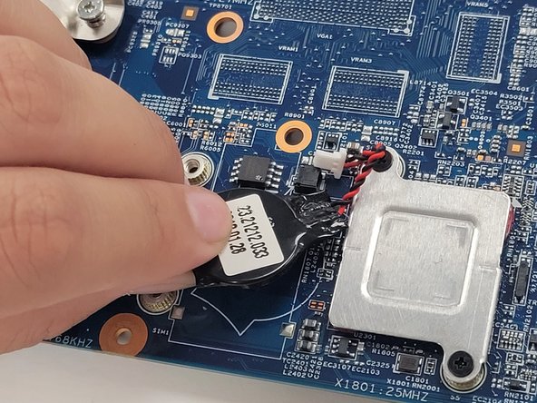

  23. HP Probook 4540s BIOS Chip Replacement: crwdns2935265:023crwdnd2935265:01crwdnd2935265:03crwdne2935265:0 HP Probook 4540s BIOS Chip Replacement: crwdns2935265:023crwdnd2935265:02crwdnd2935265:03crwdne2935265:0 HP Probook 4540s BIOS Chip Replacement: crwdns2935265:023crwdnd2935265:03crwdnd2935265:03crwdne2935265:0
    • Unplug the Real-time clock (RTC) CMOS battery by gently pulling the battery cable away from the connector.
    • Grab the battery and gently pull it away from the system board.

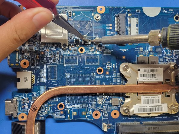

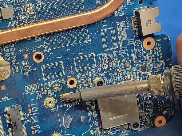

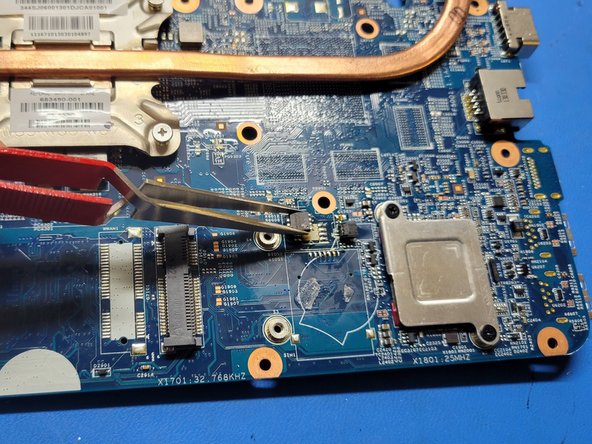

  24. HP Probook 4540s BIOS Chip Replacement: crwdns2935265:024crwdnd2935265:01crwdnd2935265:01crwdne2935265:0
    • Target the connectors of the BIOS chip with a heat gun.
    • Handle the heat gun with care. The heat gun will be at 344 degrees Celsius or 650 degrees Fahrenheit.
    • Circle the BIOS chip slowly so each connector heats up simultaneously. Heating one spot for too long can damage the system board.
    • Use the rubber handle tweezers, to prevent the BIOS chip from being blown off the system board.
    • This step will take some time. Be patient. You may apply flux on the connectors to help melt the solder.
  25. HP Probook 4540s BIOS Chip Replacement: crwdns2935265:025crwdnd2935265:01crwdnd2935265:02crwdne2935265:0 HP Probook 4540s BIOS Chip Replacement: crwdns2935265:025crwdnd2935265:02crwdnd2935265:02crwdne2935265:0
    • Gently pull the BIOS chip out using the rubber handle tweezers.
    • If the BIOS chip won't detach, apply more heat. Do not forcefully remove the BIOS chip as that could damage the connection pads.
  26. HP Probook 4540s BIOS Chip Replacement: crwdns2935265:026crwdnd2935265:01crwdnd2935265:02crwdne2935265:0 HP Probook 4540s BIOS Chip Replacement: crwdns2935265:026crwdnd2935265:02crwdnd2935265:02crwdne2935265:0
    • You may clean the area using small amounts of Isopropyl alcohol and using a Q-tip to clean the area.
    • Use your soldering iron to brush the pads.
    • If the pads came off when taking the BIOS chip out, you may apply small amounts of solder and brush the solder on the pads.
  27. HP Probook 4540s BIOS Chip Replacement: crwdns2935265:027crwdnd2935265:01crwdnd2935265:02crwdne2935265:0 HP Probook 4540s BIOS Chip Replacement: crwdns2935265:027crwdnd2935265:02crwdnd2935265:02crwdne2935265:0
    • Place the new BIOS Chip and align the connectors with the pads.
    • Gently apply pressure to the BIOS chip downwards using the rubber handle tweezers while soldering the connectors with the pads to ensure that the connectors on the BIOS chip have good contact with the pads.
    • Do this until the BIOS chip is firmly in place
    • Check and ensure that the BIOS chip is firmly in place before reassembling the laptop.
    • All the connectors on the BIOS chip should be touching the pads.
