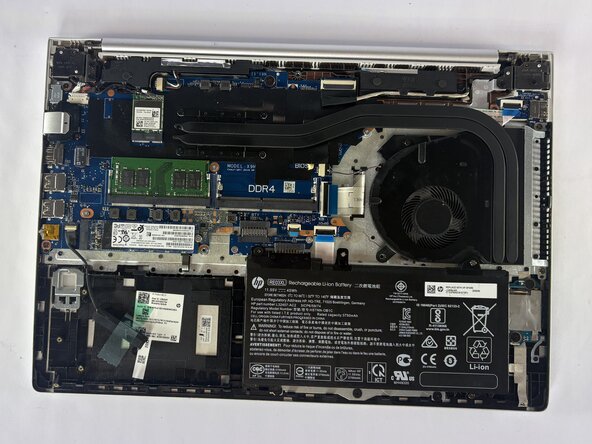

HP ProBook 455 G7 RAM Replacement
  1. HP ProBook 455 G7 RAM Replacement, Lower Case: crwdns2935265:01crwdnd2935265:01crwdnd2935265:01crwdne2935265:0
    • Before beginning, completely power off the laptop and unplug the charger and any peripheries.
    • Flip the laptop over so the lower case is facing up.
    • Use a Phillips #1 screwdriver to remove the seven 8 mm-long screws securing the lower case.
  2. HP ProBook 455 G7 RAM Replacement: crwdns2935265:02crwdnd2935265:01crwdnd2935265:03crwdne2935265:0 HP ProBook 455 G7 RAM Replacement: crwdns2935265:02crwdnd2935265:02crwdnd2935265:03crwdne2935265:0 HP ProBook 455 G7 RAM Replacement: crwdns2935265:02crwdnd2935265:03crwdnd2935265:03crwdne2935265:0
    • Insert an opening tool into the seam between the lower case and chassis.
    • Pry around the entire perimeter until the lower case fully releases.
    • Lift and remove the lower case.
  3. HP ProBook 455 G7 RAM Replacement, Battery: crwdns2935265:03crwdnd2935265:01crwdnd2935265:03crwdne2935265:0 HP ProBook 455 G7 RAM Replacement, Battery: crwdns2935265:03crwdnd2935265:02crwdnd2935265:03crwdne2935265:0 HP ProBook 455 G7 RAM Replacement, Battery: crwdns2935265:03crwdnd2935265:03crwdnd2935265:03crwdne2935265:0
    • Use a Phillips #1 screwdriver to remove the three 4 mm-long screws securing the battery.
    • Carefully lift the battery and remove it from the laptop.
  4. HP ProBook 455 G7 RAM Replacement, RAM: crwdns2935265:04crwdnd2935265:01crwdnd2935265:01crwdne2935265:0
    • Two clips secure the RAM module in place, one on each side. Using your fingers, spread the clips away from the RAM module.
  5. HP ProBook 455 G7 RAM Replacement: crwdns2935265:05crwdnd2935265:01crwdnd2935265:01crwdne2935265:0
    • The RAM stick should pop up at an angle.
  6. HP ProBook 455 G7 RAM Replacement: crwdns2935265:06crwdnd2935265:01crwdnd2935265:01crwdne2935265:0
    • Carefully pull the module directly out of its socket.
    • Align the notch on the new RAM module with the slot in the connector.
    • Slide the module in at an angle, then press down until it clicks into place.
    • The HP ProBook 455 G7 typically supports DDR4 SO-DIMM RAM up to 32 GB (2 × 16 GB). Make sure both sticks are properly seated before reassembling.
